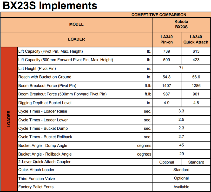

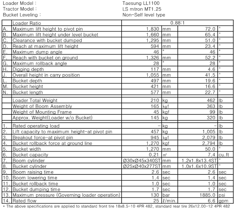

When shopping for my SCUT lift height was something I looked at. The MT125 is as good as the BX80 series for lift height and capacity. Height and reach in the sub compact rage seem to be not that far apart (1-4 inches for many of the measurements). The lift capacity and breakout force do have more variation (200 lbs. difference is significant when the capacity is under 1000 lbs.) To reach anywhere near the stated numbers you need some good counterweight and as everyone above states; keep loads low when moving.
LS does list all the basic loader specs on one page. They have new loader models on the MT3 and MT5 series.
