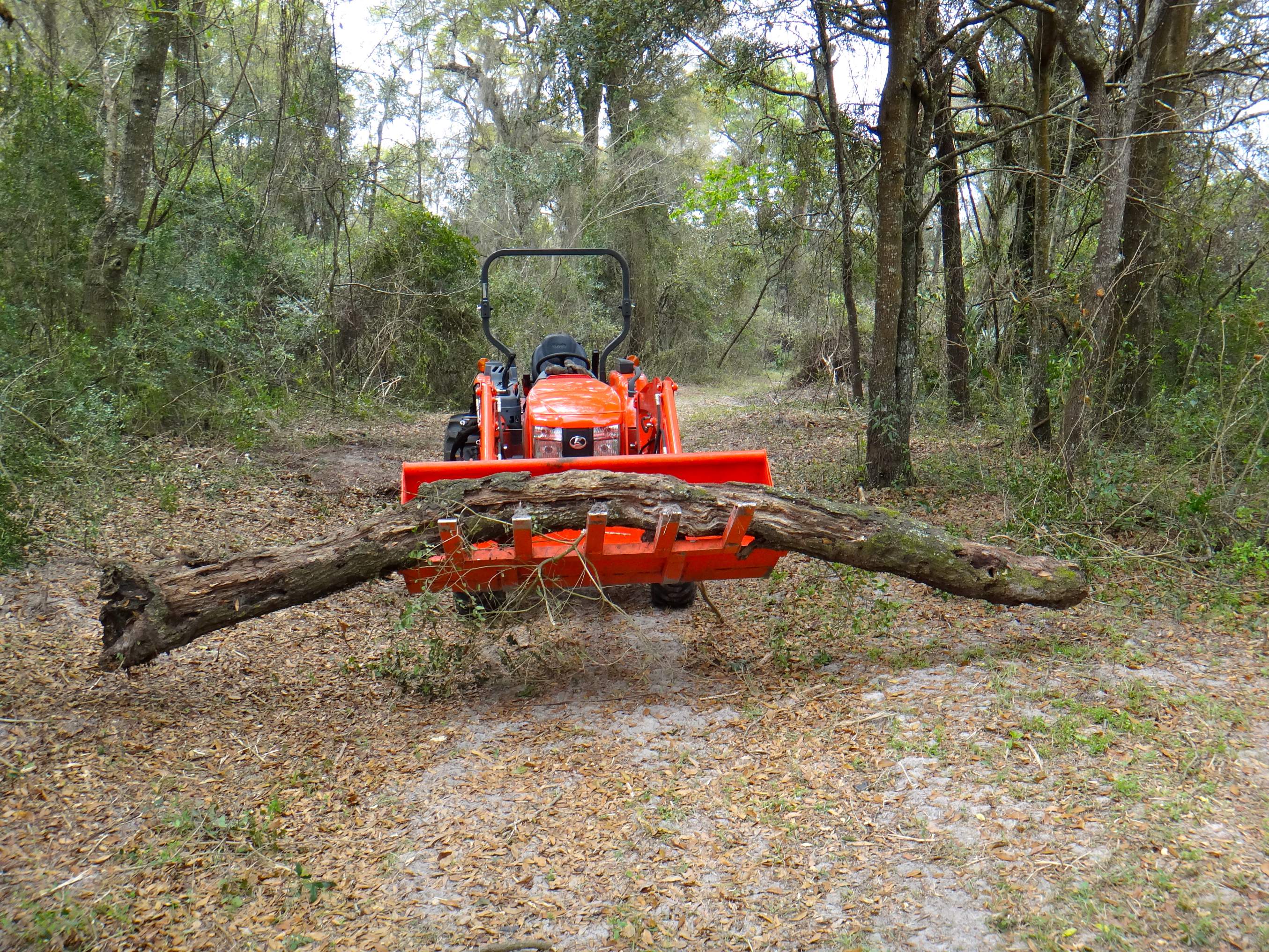

Most STANDARD contemporary loader buckets can pick up a load of DRY material without the rear coming up, without Three Point Hitch ballast. This varies somewhat between tractor models. If you have an extra capacity LIGHT MATERIALS BUCKET heaped full, FEL may not be up to lift.
Heavier lifts than DRY sand, in my case Oak tree trunk sections to 50" diameter, will lift the rear tires before the FEL comes up without Three Point Hitch ballast.
Someone else will give you an estimate for weight of your sand if you provide cubic capacity of your bucket. That will give you a clue as to whether FEL cylinder pressure is up to spec.
I trust your FEL has been greased on a regular schedule throughout its service life. Kubota calls for greasing FEL every ten hours of operation. FEL pivot pin friction can reduce FEL lift substantially.
Look at the pins. If the grease oozed out around the pivot pins is dry, dusty, hard and opaque it has been a long time since the FEL was greased. If pivot pins have not been greased regularly, pins may be scored.

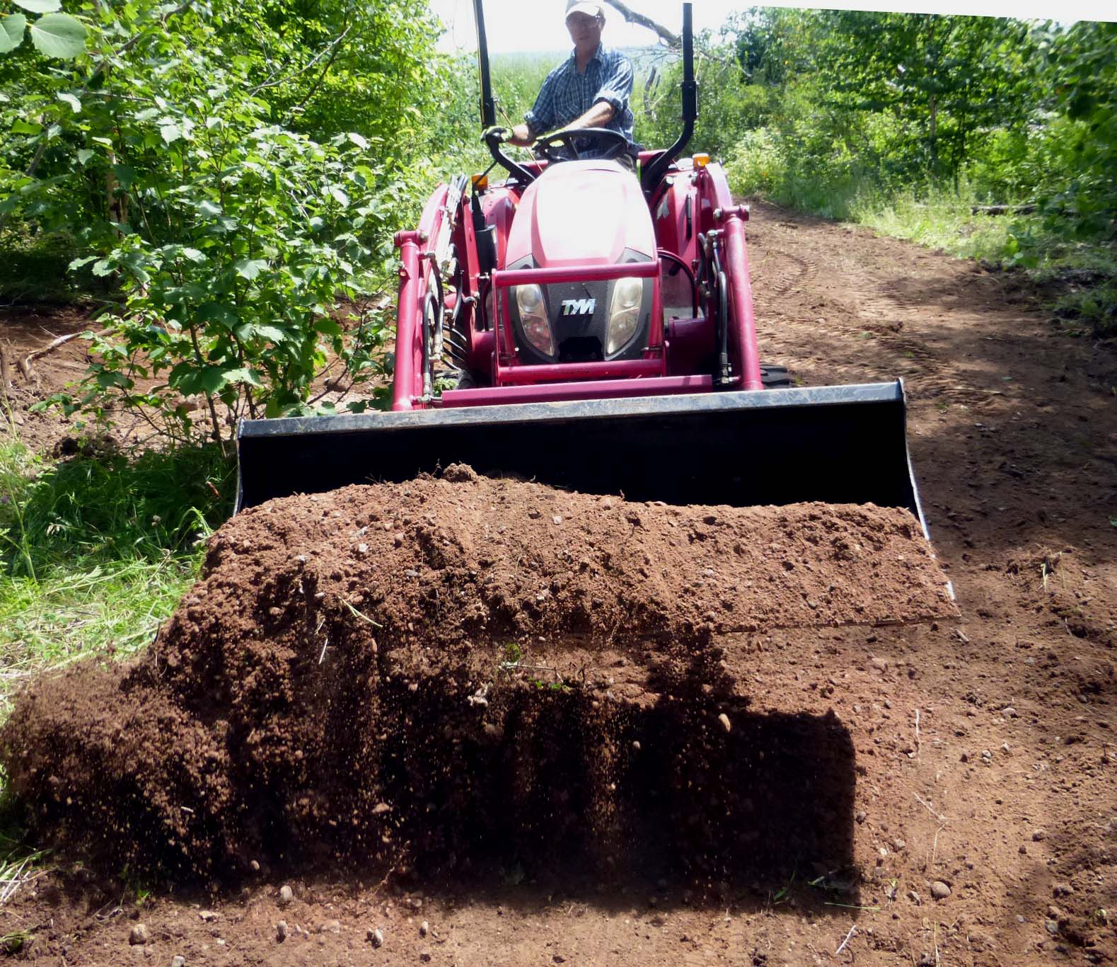

Jerry's comments are right on. Its a trick to pick up a max load. With the little tractor pictured below, I could readily get the bucket fully loaded via the lift and curl method, (farm kids already knew how to do this;-) but then the rear tires had little or no weight on them, so it was a balancing act.
