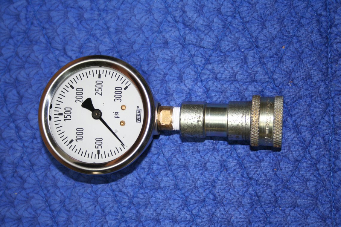

Have you checked things out with a hyd pressure gage test set. They only cost about $25.
   / Loader leaking down and dumping
Na, but I probably have enough stuff it would be useful to have one around. Could you tell me what I am looking for?
