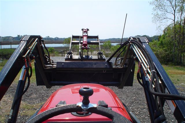

Having a bad back is sufficient motivation to add a grapple to my Koyker 160 Loader. I purchased the machined parts and cylinder from a fellow member, got the spool valve on e-bay and the hoses and adapters from Northern Tool. It was necessary to beef up the loader mounting surface with some 4" channel iron. A day and a half later I can pick up a lot of things that used to require getting off the tractor. Here is a pic taken before painting the unit. If you are interested in more info I would be glad to help.
   / Loader Grapple Upgrade
#2
Try the pic again!

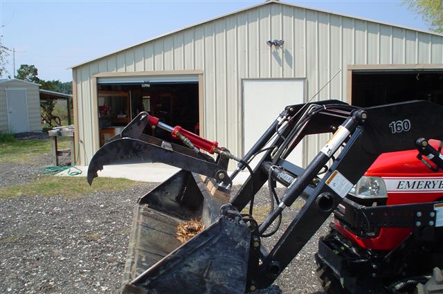

A few more pics!

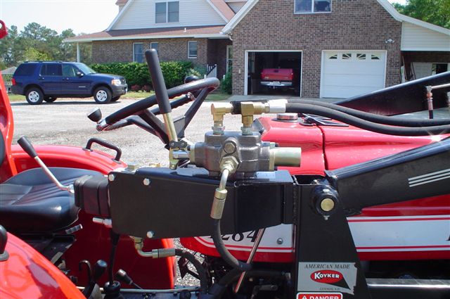

The controls pic

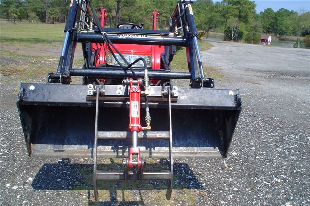

One more pic
