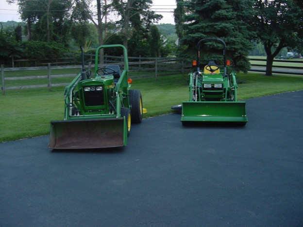

Your right Roy the 650 is about 10" higher at the hood and the hood is longer. Almost a 1/4 bigger then the 2210. He needs a model 67 loader or after market model. Just sold my 650 but the guy that bought it hasn't picked it up yet. I will try to get a picture of the 650 and 2210 side by side.

Here's the picture of the 2210 with 200cx loader and the 650 with 67 loader.

Nice pic
Why did you sell the 650? It seems like a bit more tractor then the 2210...

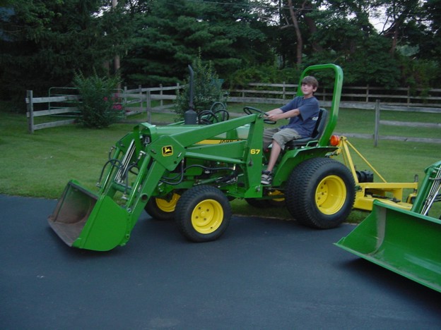

Thanks for the pic can not wait until I get a loader on mine. Hate that you had to get rid of it because of someone elses ignorance. My 650 has ag tires its a little bit narrower than the one you had how stable was yours with the fel on it and what size bucket was that one a 4 or 5ft? thanks
   / Loader for 650 #9
With the 261 JD - RM on the back for ballast it was pretty good front to back.The turf tires on the back are real wide 16"- 18”, so that helps side to side stability. The loader is 48” the 2210 is 53”. Here’s a side view picture so you can see how the loader is mounted.
