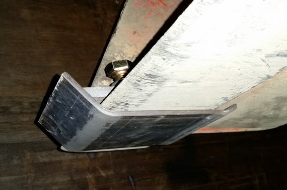

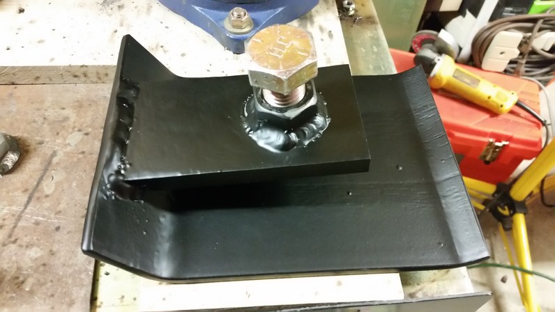

I made a pair of "SKi Tips/Skids" which keeps the blade from digging in. Have no issues pushing snow on gravel in float mode!
