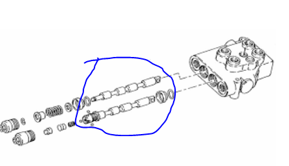

Great advice guys! Thanks. Ok, so where is the spool valve? I have no idea where or what it looks like LOL. Is that the one under the joy stick?
   / Loader doesn't hold hydraulic pressure #6
The joystick is connected to the loader valve. Either directly if the joystick is on the loader, or via cables if the joystick is mounted on the fender. The loader valve contains two spool valves, one for lift and one for curl. A spool valve is a type of hydraulic valve.
   / Loader doesn't hold hydraulic pressure #7
The spools which are a machined fit for correct clearance in housing are encircled in blue.
