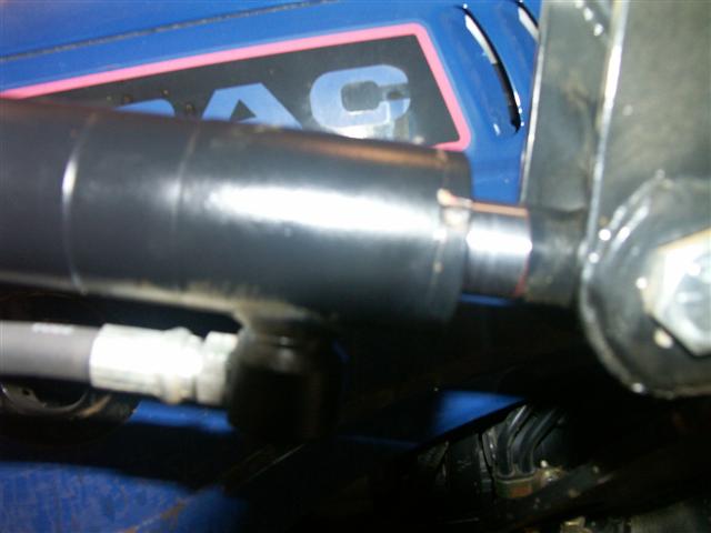

Anyone know where I can get spanner wrenches for taking the nuts loose on the loader cylinders? I have to replace leaking seals,only 28 hours...strange? Is it possible on a new machine that they just need to be tightened? What do you guys use for this. Thanks. /forums/images/graemlins/confused.gif

The way I usualy do it is with a hammer and punch. I can never seem to get enough leverage with a spanner wrench. With only 28 hrs on a loader I'd be talking to the dealer about fixing it. I would think you have another problem, like the pressure relief set to high. If you don't find out what caused these to blow the new set will also

Nothing should be loose, but I think that I have seen everything that way on new tractors at one time or another.
If your cylinder has notches, you can use a punch to tighten it up.
/ Loader cylinder repair #8
Different loader manufacturers use different cylinder manufacturers who in turn use various styles of gland nuts on various cylinder models.
Rigid pin spanners made by Armstrong can be bought from MSC for around $20.-
You can make one yourself if you are handy.
It is easier to tighten or remove the gland nut with the cylinder in place on the loader.
My experience has been that they are tighter than you may expect and a 5 foot persuader might be needed on the end of the wrench.
A picture of your gland nut would be worth a thousand words to someone recommending tools.
If only one is leaking then it can be a few things causing it. If every one is leaking then there may be a pressure problem with the relief not suitably set for the type of seals in the gland nut.

Thanks. Only the two boom cylinders are leaking.
The left one loses more than the right.It has now covered my left tire.I will try to get some pics and post them. Thanks so much for your help so far.Dealer says they must be bent but I doubt it because I haven't lifted a full bucketfull yet.He is shipping new seals if thats any consolation.
Somewhat of a picture.They are leaking real good now.

We need to see the end of the cylinder where the rod goes in. NOT the side. Can you get some more pics?

the chances that tightening them will cure anything is about zero. I wouldn't touch them. I'd call the dealer and ask if his remote truck is ever in your area and could pick up the cylinders. Otherwise, I would take them off and either deliver them to him or ship them. If you mess with them, the chances of him covering them under warranty are slim. If both cylinders are bad, then chances are that something was left out at the factory. What brand loader/tractor is it?

I change my opinion on my previous post. Why not ask him to ship you new loader cylinders. Let him deal with the bad ones.

Second what Andy said, tightning stuff won't fix it. The cylinders need to be returned so the manfacture can see what went wrong..

I'm with the other guys in agreement that tightening them will accomplish nothing. There are some very specialized seals that keep the fluid from leaking and at the very least, they need to be replaced. Since it only has 28 hours on it, I'm thinking there might be other problems. Are you sure about the hours? Are you covered under warantee? If so, doing it yourself will probably violate your warantee. This can be very bad if it's something more serious than just some bad seals.
I paid $80 for my spanner wrench. It's adjustable and takes a 3/4 inch breaker bar. I had to get a Proto because the cheap ones just bent. Allot of times I also have to torch the fitting to melt the Loctite that's on the threads. Even then, I need to put a ten foot pipe onto my breaker bar to get them off. But I have full sized tractors, so it's a bit of a nightmare when I rebuild mine.
Right now I've spent two days trying to get one apart on my backhoe. I finally got it off after breaking the bolts on my spanner three times and loosing one of the teeth. I ended up welding a bolt into the hole and beating it off with a hammer. Half a day of beating it to bet it an eighth of an inch. This evening I have it a full turn and will finish taking it off tomorrow. Sometimes it's cheaper to drive it to the dealer and pay them to fix it.
