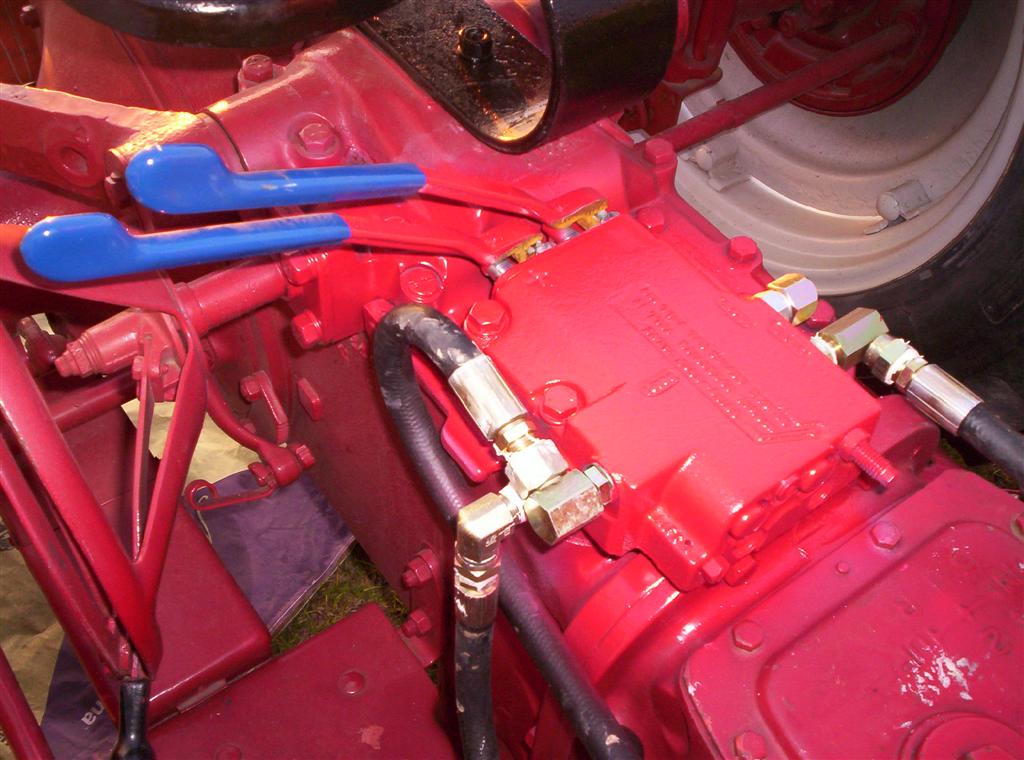

That is the loader control valve ( tapped off tractor hyds on the hyd top cover - 4gpm! ) on my 1955 ford 850 with ford 711 1-arm loader. In the pics, that's the one with the blue loader. i also have a near identical 1955 ford 660 with a ford 722 1-arm loader with a similar valve setup.
One spool is lift/drop, the other spool is dump/curl.
Way better than using a wheel barrow.. even if the controlls are a little odd!
Your joystick setup looks great to me.. etc.
