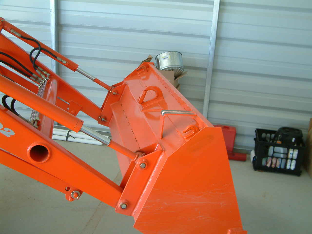

I had the dealer weld chain hooks on the bucket (B7510HST/LA302 FEL).
I bought the hooks from AW Direct. The two outer hooks are Grade 40 Weldable Towing Grab Hooks. The center one is a Gunnebo-Johnson Weld-on Anchor Hook (also from AW Direct).
Be sure to weld stiffening on the bucket before you attach the chain hooks (you can see this on my bucket).

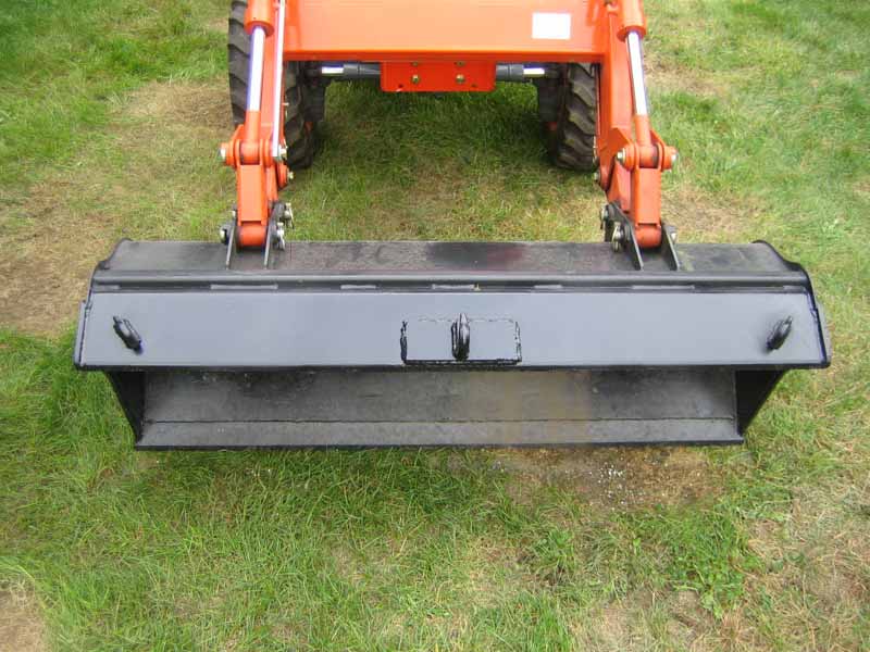

Another photo with three hooks. Two 5/16ths chain hooks welded at edges of bucket and a 3/8 inch hook in the middle with a support piece.
You should be able to get all of these materials from just about any tractor dealer or outdoor power dealer.

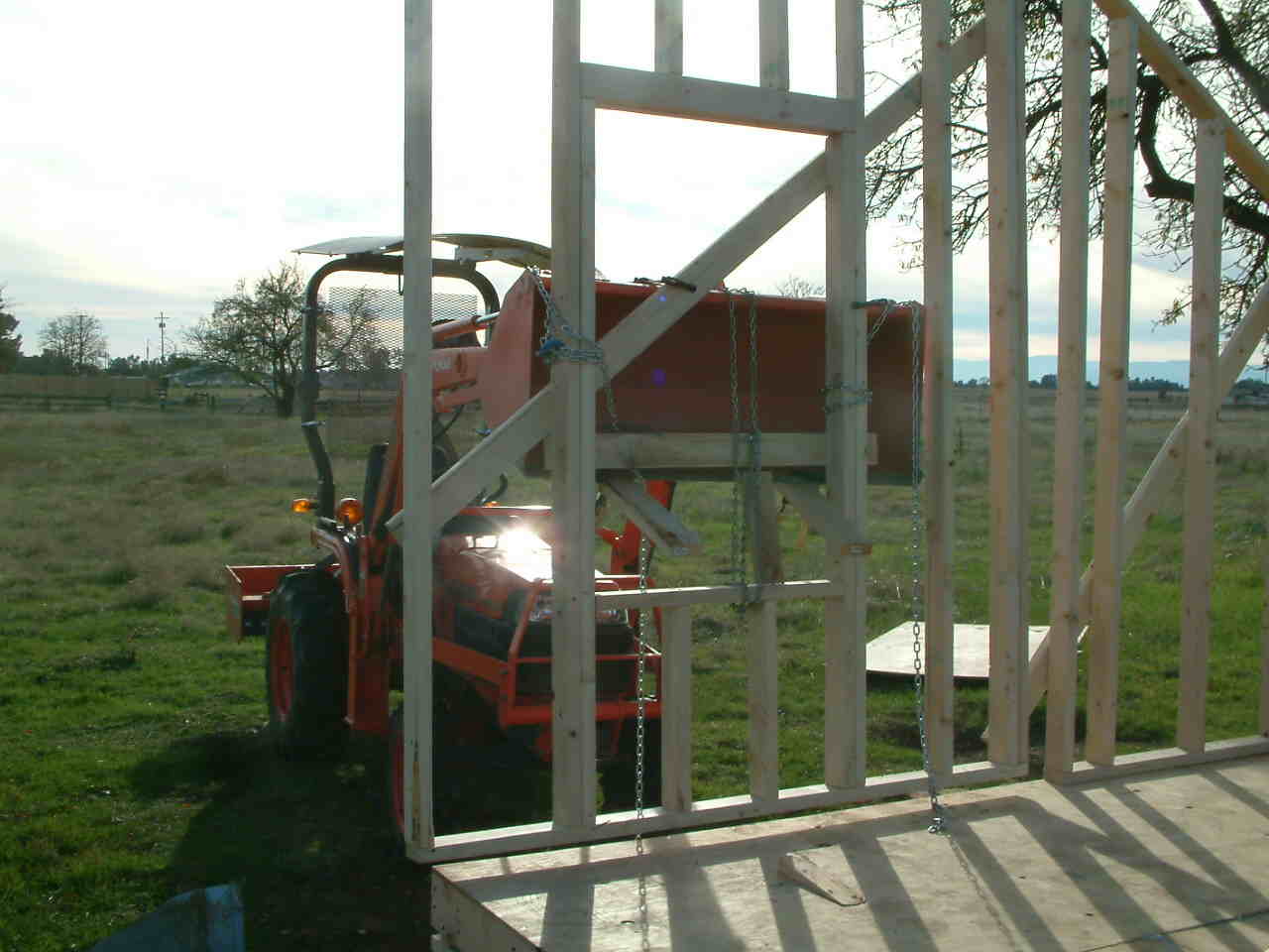

You'll find a lot of neat uses for your bucket hooks. For example---
