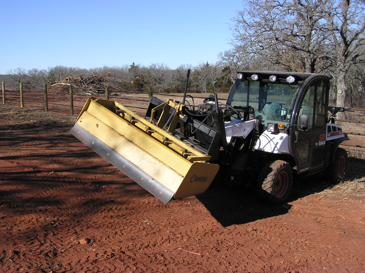

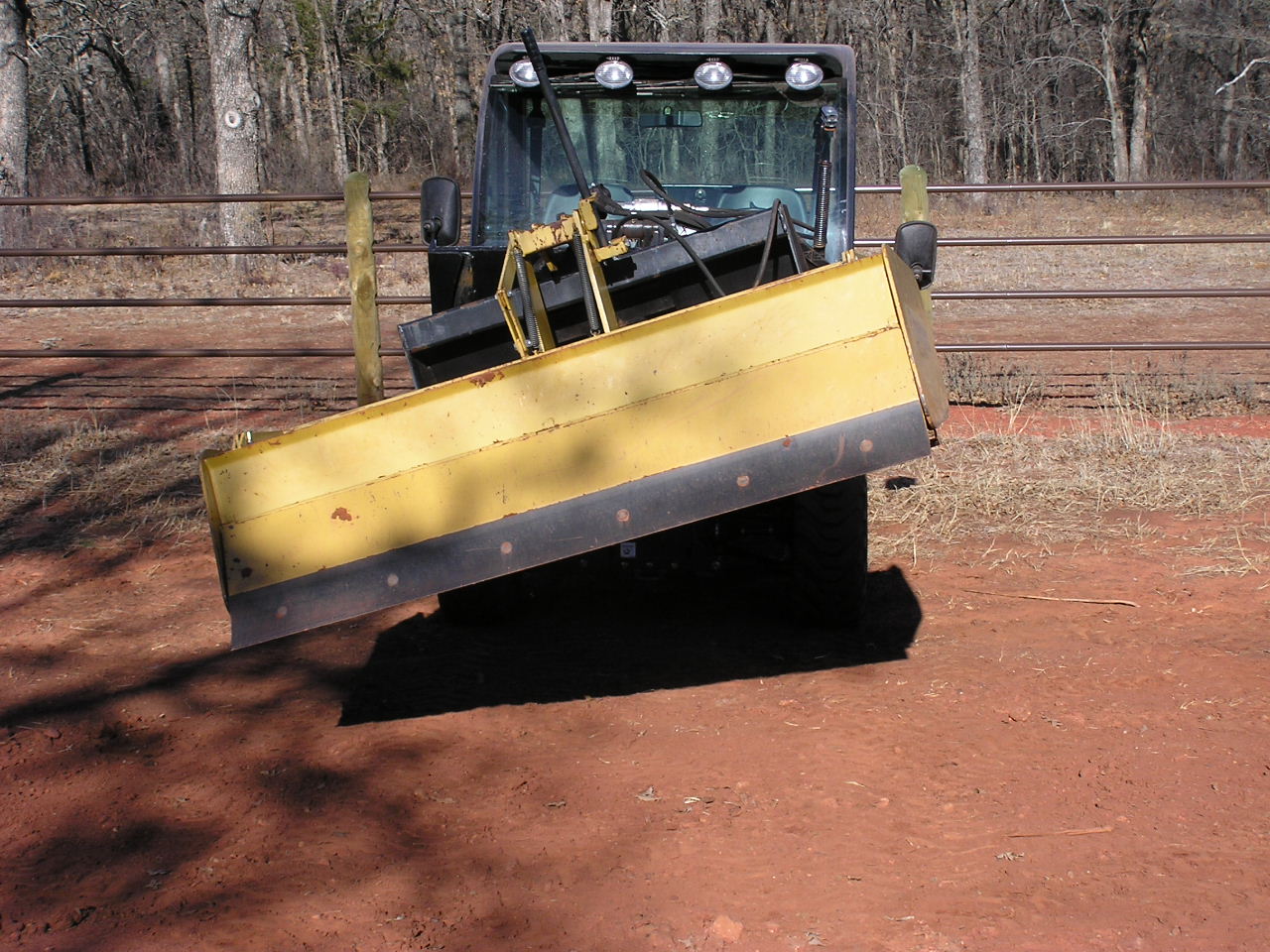

Apparently I'm really cheap as the price of a new HD box scraper is appalling to me, and used ones aren't much cheaper. I may have a good price on an old Cat loader/backhoe front bucket and the wheels started turning. I really like the idea of rollover box scrapers, but also like how my loader can scoop up and carry dirt over a distance. My loader, however, can't change its side-to-side angle like a 3 point implement can. --------------------------------------------

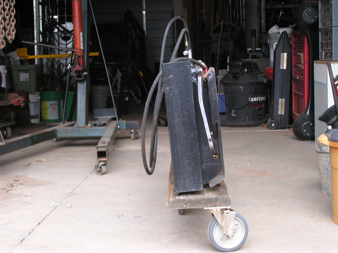

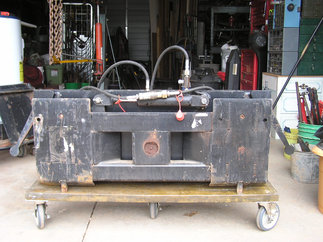

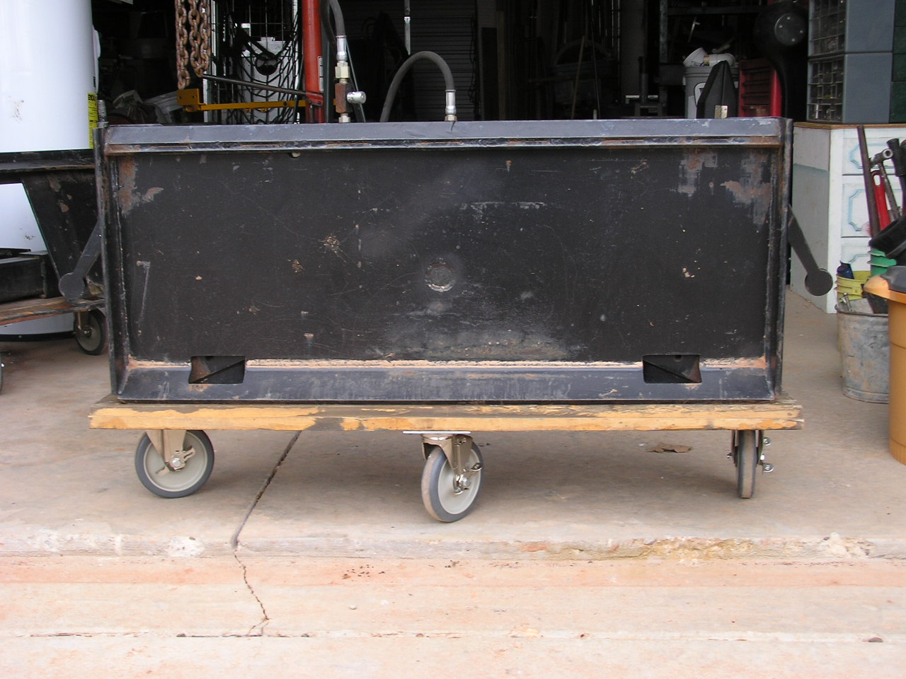

Just general information for those that have never seen a Tilt-Tach. On a loader with QA, you can add a Tilt-Tach to easily change the side-to-side angle:
Didn't take pictures with the bucket on it, so here it is with the 6' box blade on a 3 point adapter:

Good stuff! I'd never heard of the Tilt-tach. I'll definitely look into it!
