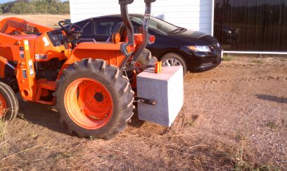

Very true and if you really want to blow your mind get a rear ballast weight also. You won't believe the difference when digging with your loader.
