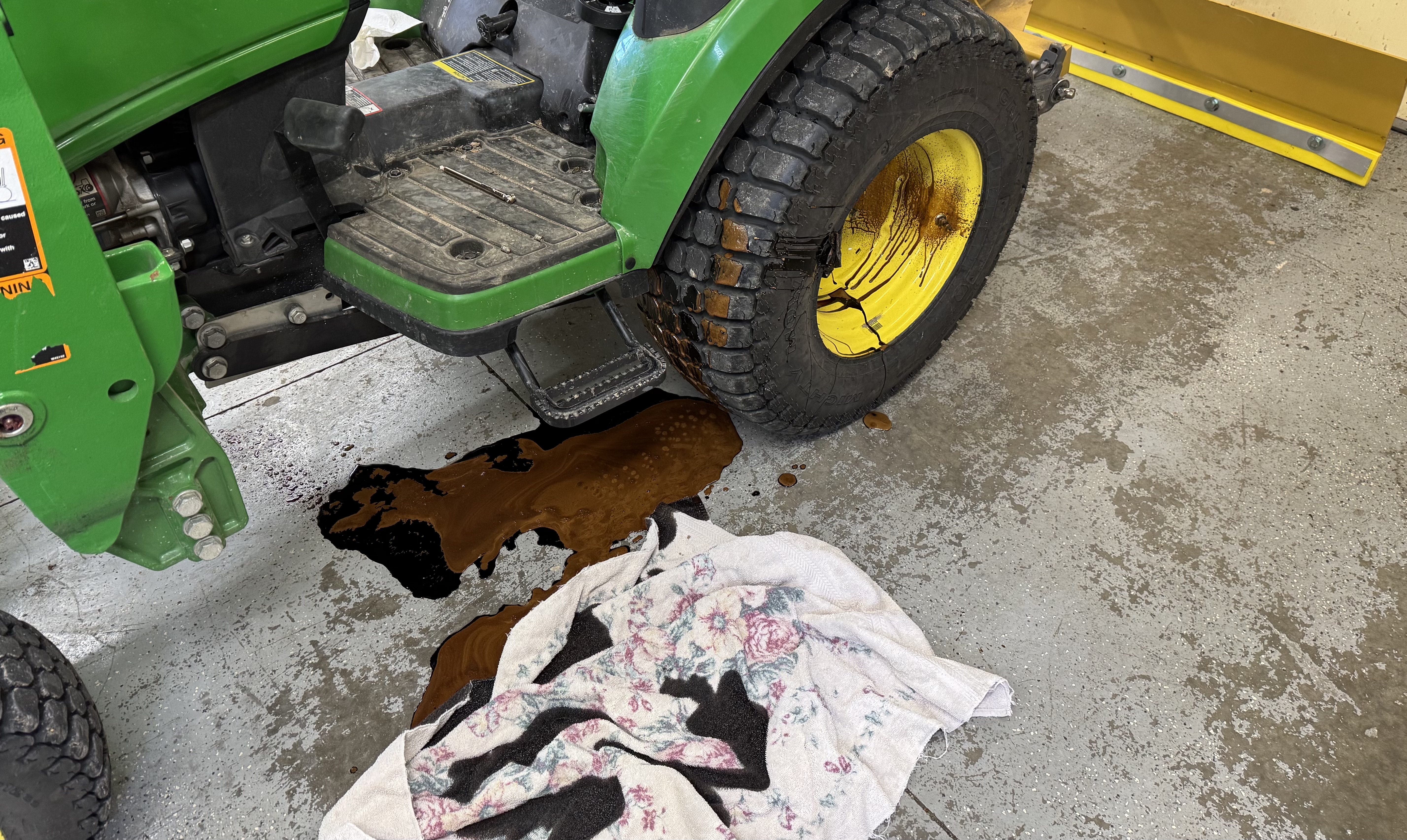

I had a tire gauge designed for filled tires, it didn’t last long. I blow air in with the stem at 12 o’clock and still end up with a mess.
You have to be QUICK when adding AND removing your air Chuck.

Normally I am quick at adding air and checking the pressure. This time because the gauge didn’t work I had to let air out.
