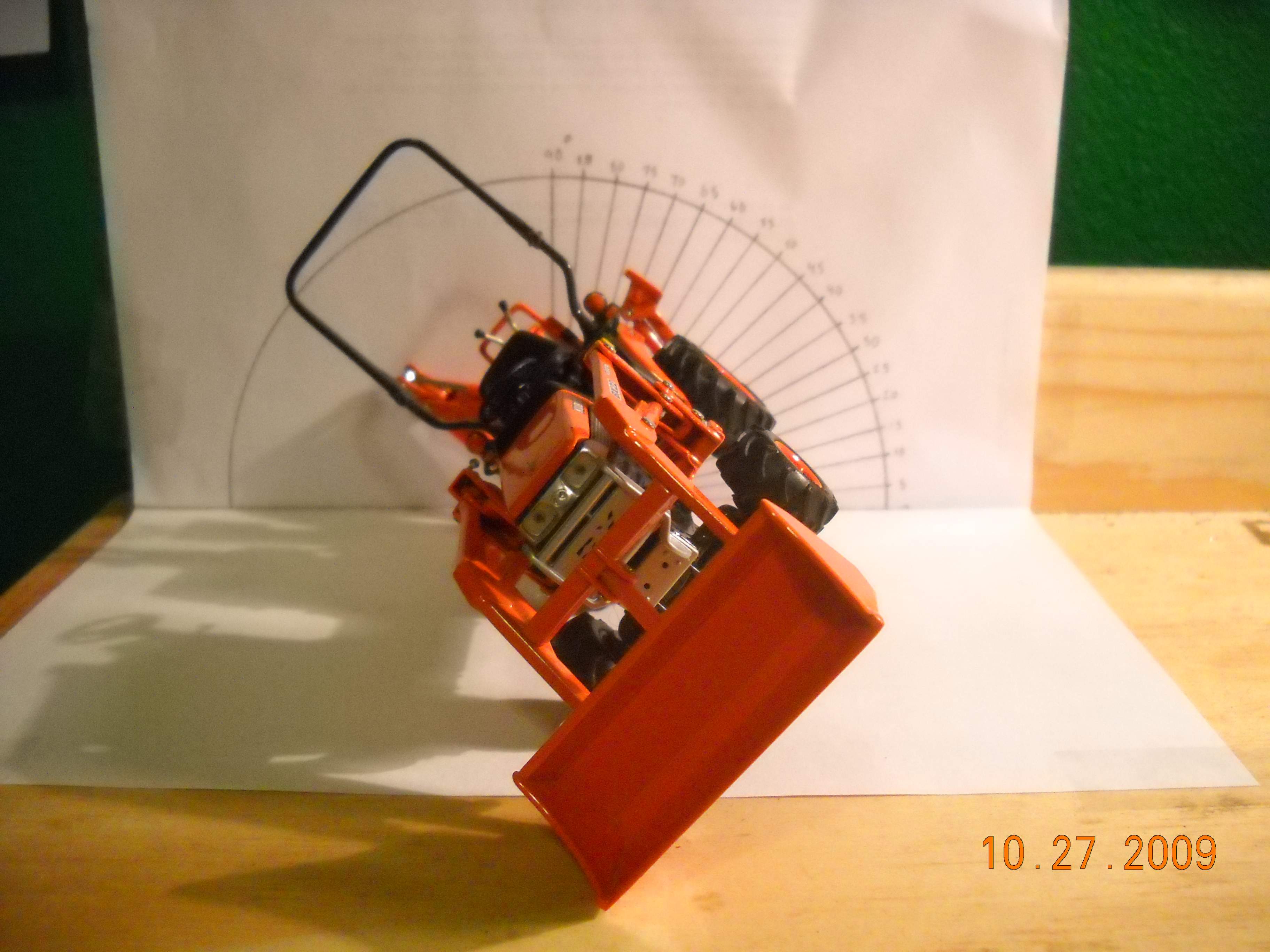

It deffinatly helps with stability. Im not sure that many would go to an angle quite like this though.

I regularly mow a 18-20 degree bank with 100% confidence with my loaded tires... Most will say 15-18* is the limit..
No chafe, no pucker...
And the ballast fr FEL use is great. I max out the lift capacity of the FEL more often than I over come the ballast of the tires...
