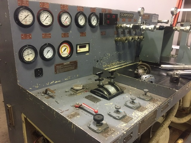

I have a couple of hydraulic motors; Char-Lynn/Eaton 101-1005-009. I am restoring an old lift that uses them as drive motors. Is there a way to load test them so I can see if they’re good or not? I can turn one of the motors by hand with the sprocket on fairly easily and the other one has more resistance.

First-off I'd fill with oil and cap both ports, anchor it well to see if it turns or leaks under some muscle, and go from there.

Fancy test machines are avail but unlikely to be cost effective for testing small low speed high torque motors individually. Testing on the lift with flow meter at the exhaust/return port and inducing a torque load should show adequate results (this assuming main pump is good and efficiency known)
Our test machine at work machine will load test hyd motors dynamically but a min rpm must be met to register torque values.
   / Load test Char-Lynn/Eaton hydraulic motors? 101-1005-009 #5
BTW, turning the shaft by hand easily usually indicates a worn geroler section, not good
