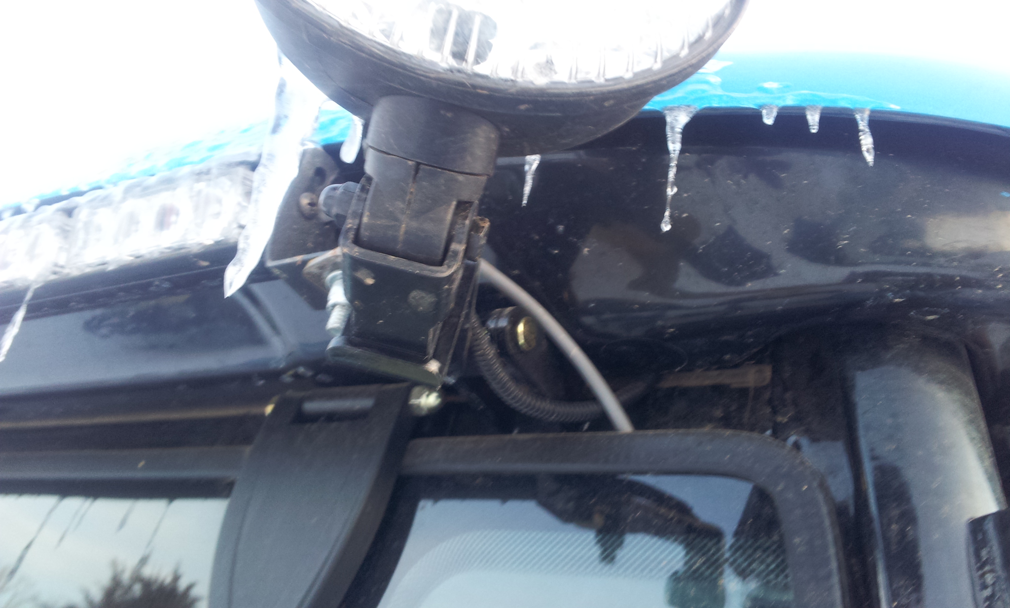

Ls xr4046 with cab
Hey guys,was wondering where the wires for rear work lights come out of the cab,there is no lights or switch on my 4046 so am going to mount my own.waiting for a switch to come in.still trying to cross oil filter and fuel filter numbers to napa if any one knows what40283380 oil and 40283326 fuel crosses to .thanks
   / Load lights wires #2
My lights came out the back of the cab between the top glass frame and the canopy, there wasn't a grommet or anything. the lights itself is attached to a mounting stud. the switches are mounted on the right side below the interior light. 20140303_174512.jpgyou should be able to access the wiring through the air filter on each side. the wiring for the switch, if it's there, which it should be, is in the side panel that is accessible by removing the little grey plastic screws. Hope this helps.
   / Load lights wires #3
The wiring for the rear work lights is inside the top roof (blue) on mine. I ordered additional switches for my work light. The wiring plug for the rear light switch is inside the right upright column next to the front work light switch. I think the gauge of the wire is too small to handle any significant amperage other than one or two small LED work lights. For the rear light I installed I am going to feed a new wire (14 gauge) from the fuse box on the left side up and over through the roof to supply the switch on the right side.
   / Load lights wires #4
that will no doubt be a good thing. the wiring is very light gauge. You can't go wrong making it heavier than needed but it can be a nightmare if you have a meltdown.
