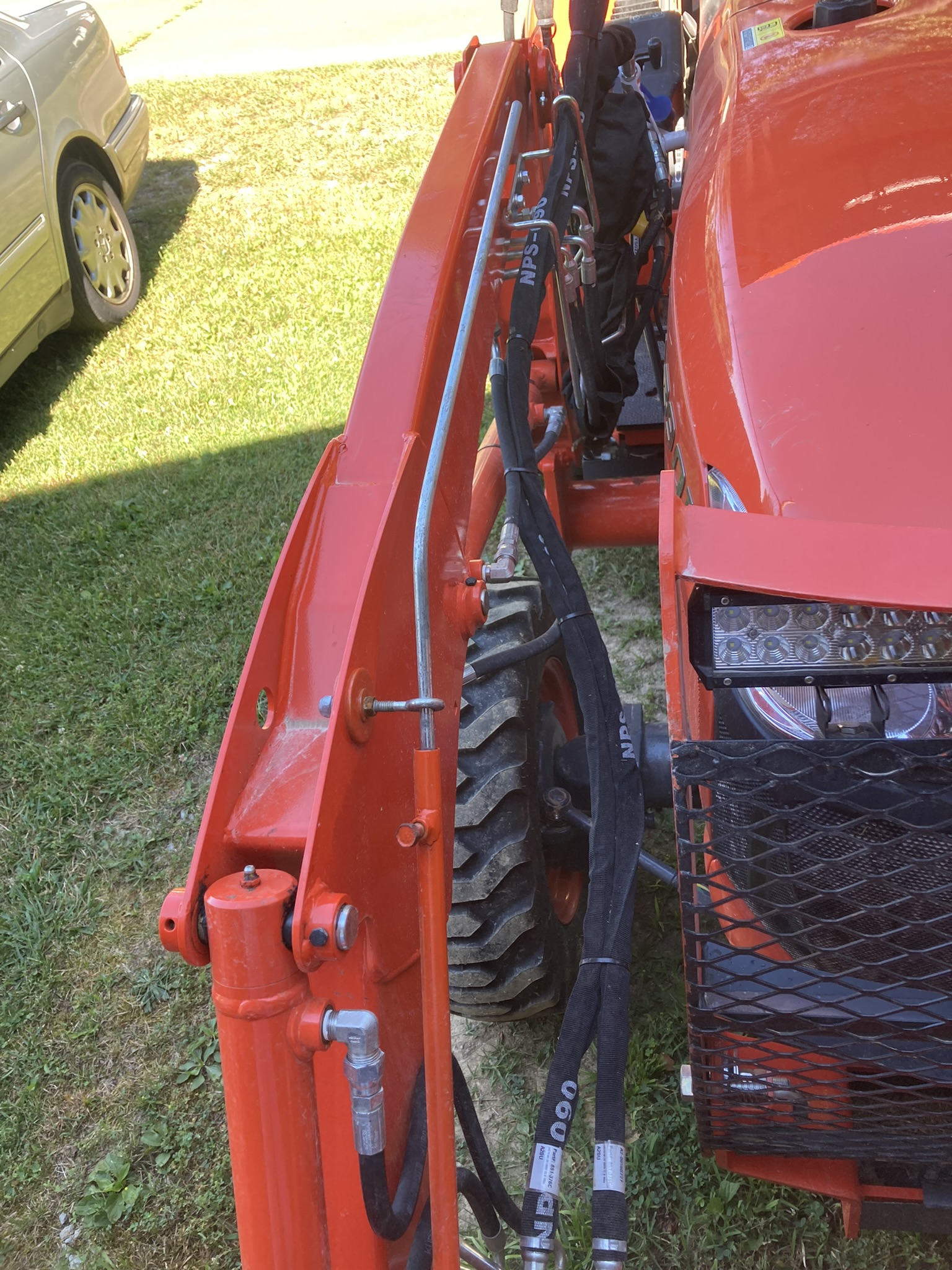

I want to make my loader attachment a self-leveling unit as it raises and lowers. Are plans available? Maybe just the math to figure out how to make it?

I copied the one Kubota sells for my tractor, (L3901).
Pretty simple to copy if you can do a bit of fabrication.

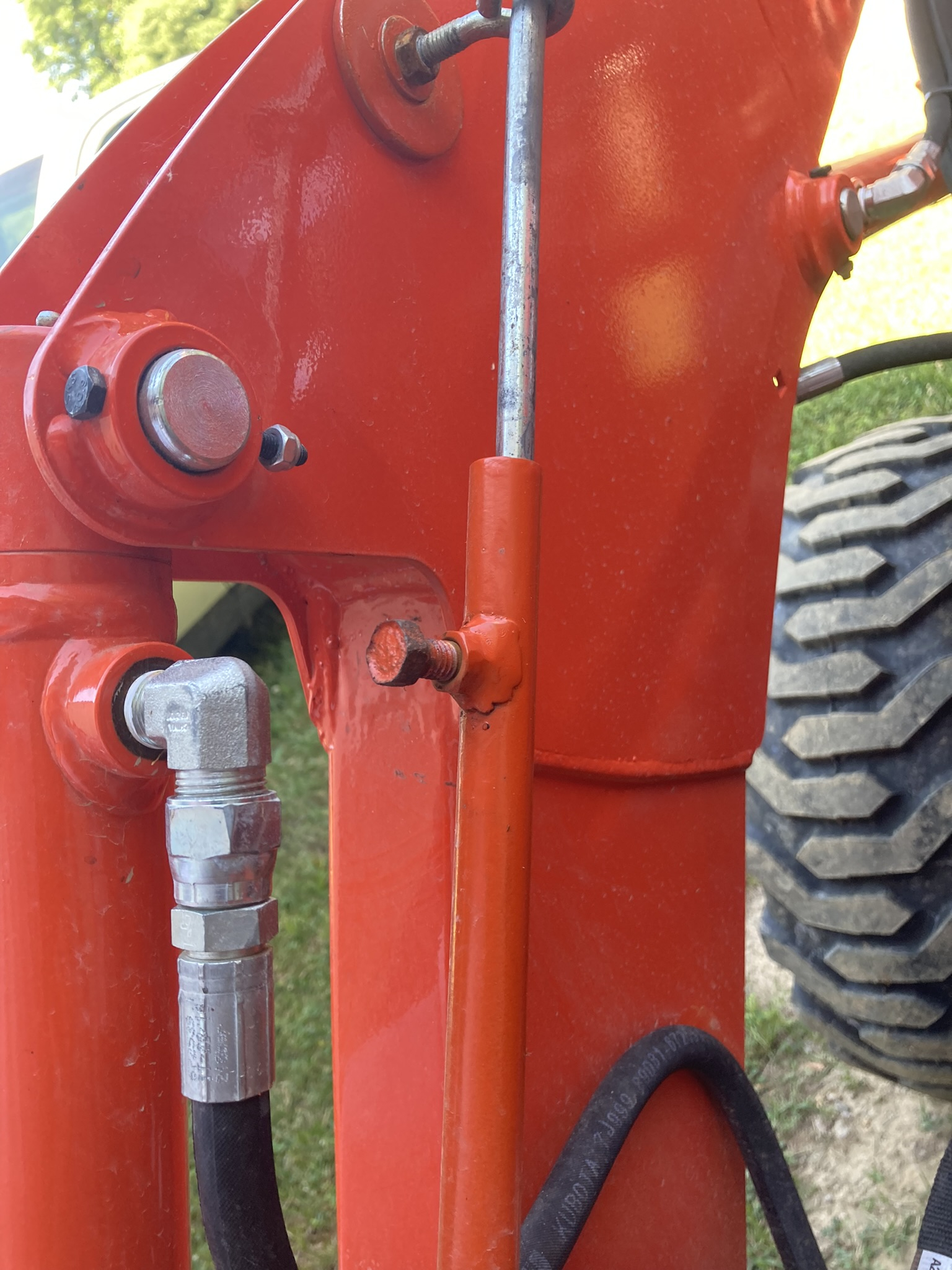

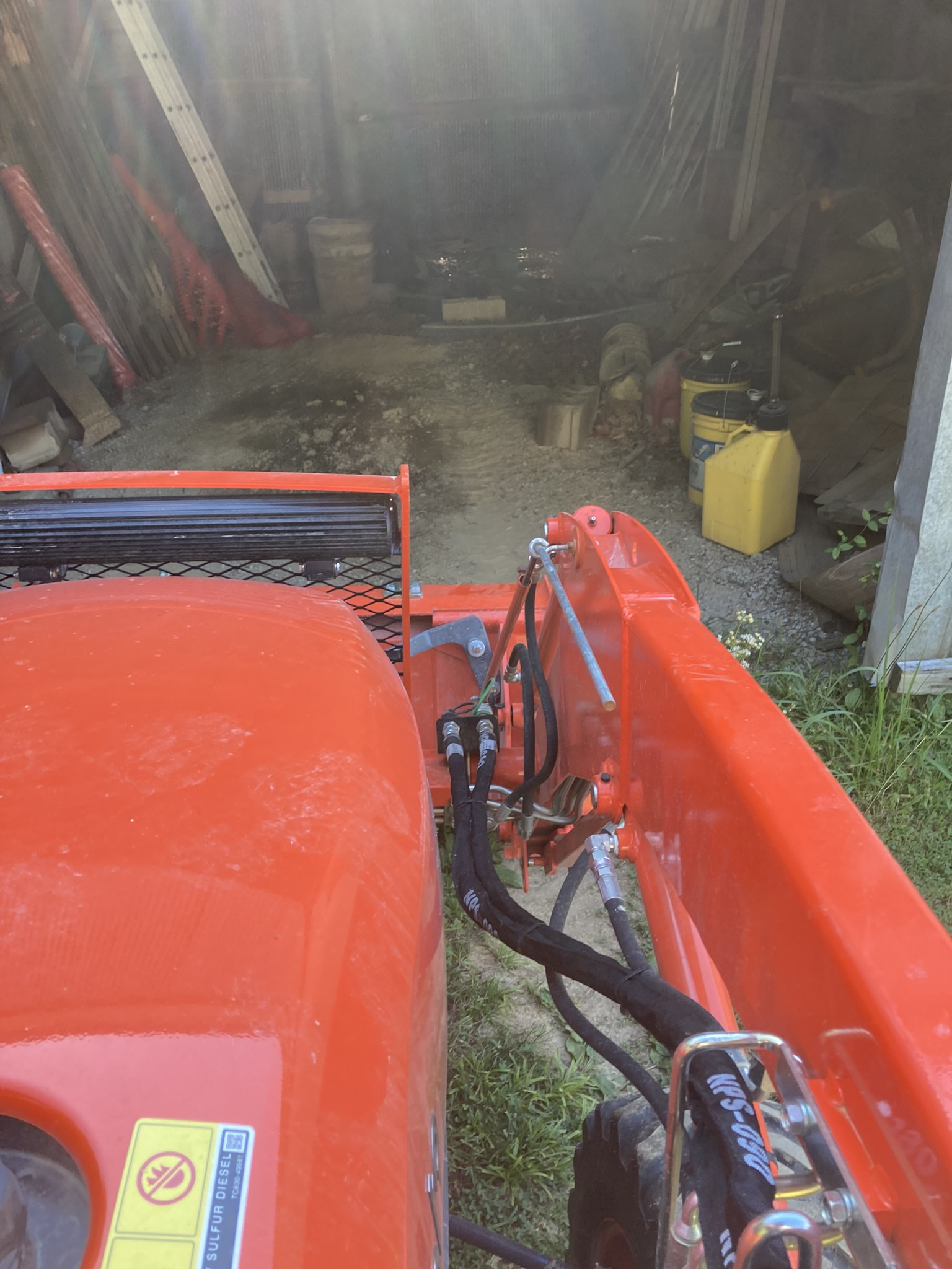

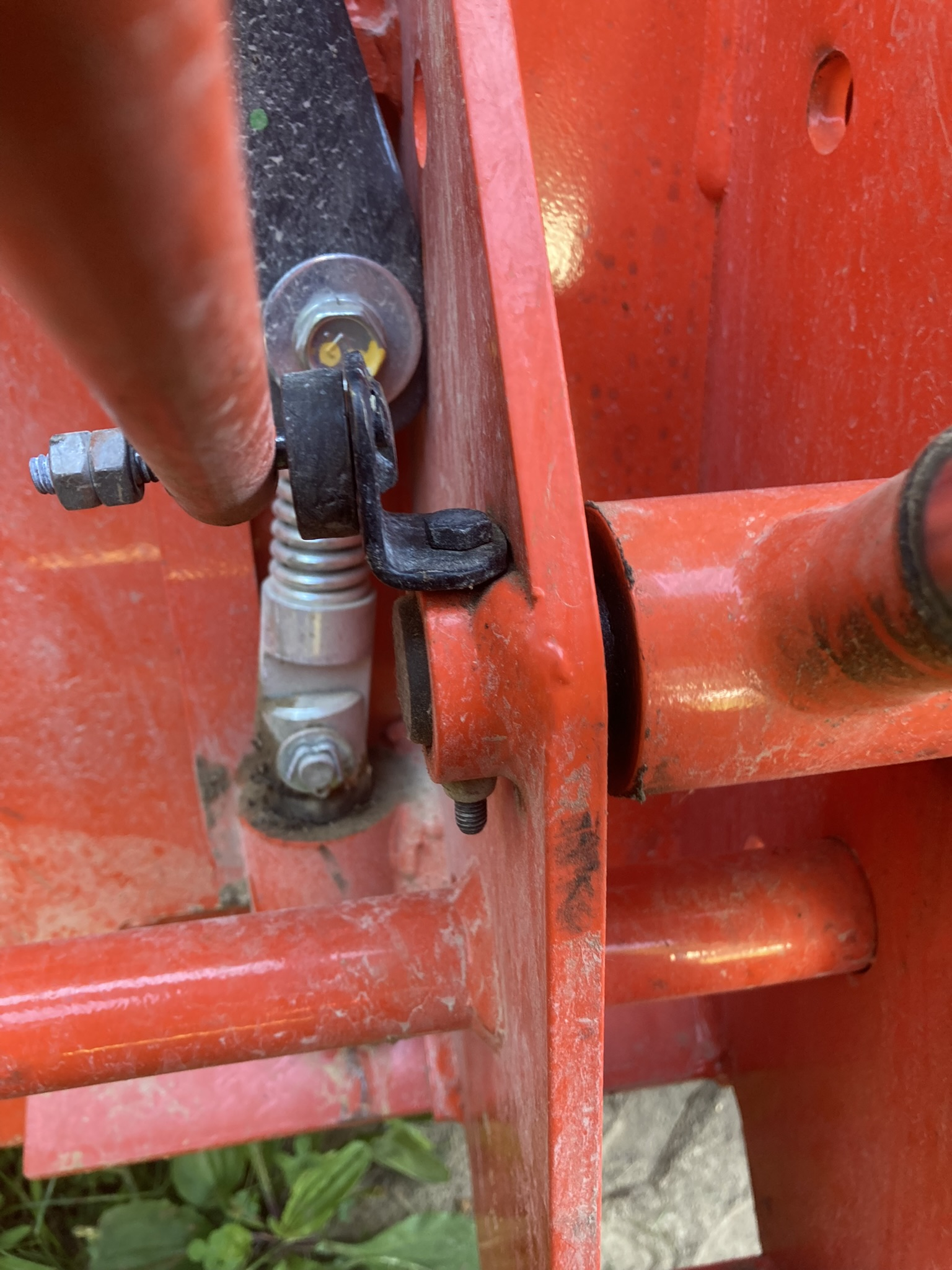

Here’s what I did, with 1/2” conduit, a solid rod bent at an angle (when bend is centered in eye bolt bucket is level). Eye bolt, a welded on nut/bolt to adjust level indicator rod (Which slides inside conduit). fabricated bracket at bucket.
Pictures
Mike

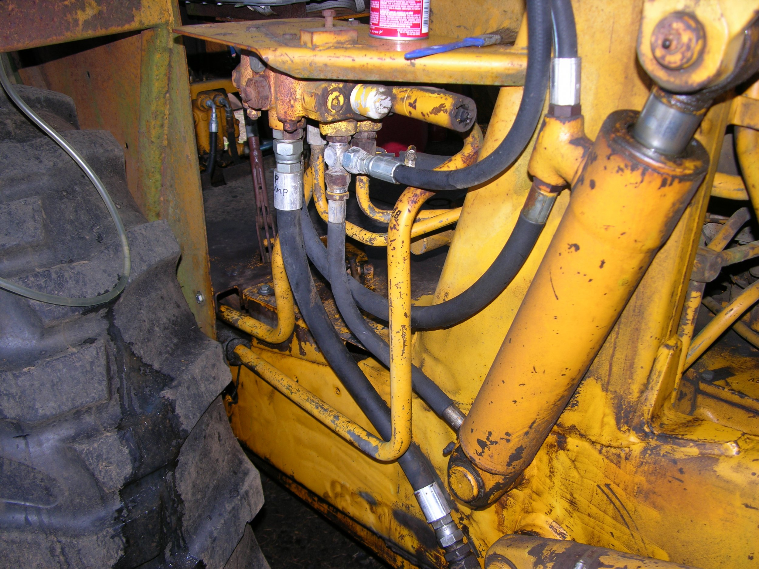

So far, all I see is a level INDICATOR - My ancient 580B loader is set up as a true self-leveling bucket - couldn't find a better pic, but the cylinder shown connects to one of the loader lift arms - the tee with two hoses runs to the pair of curl cylinders, and the upper link is maybe 8" away from the loader arm pivot. As the loader lifts and lowers, that extra cylinder acts as a PUMP that either adds or subtracts fluid from the CURL circuit.
So far I can NOT attest to how well it works, as that cylinder is one of 5 I've yet to rebuild and I'm fairly sure it leaks by (the other 4 are on the hoe - machine has 13 cylinders total)
Sorry, couldn't find a pic that shows more of that part... Steve
