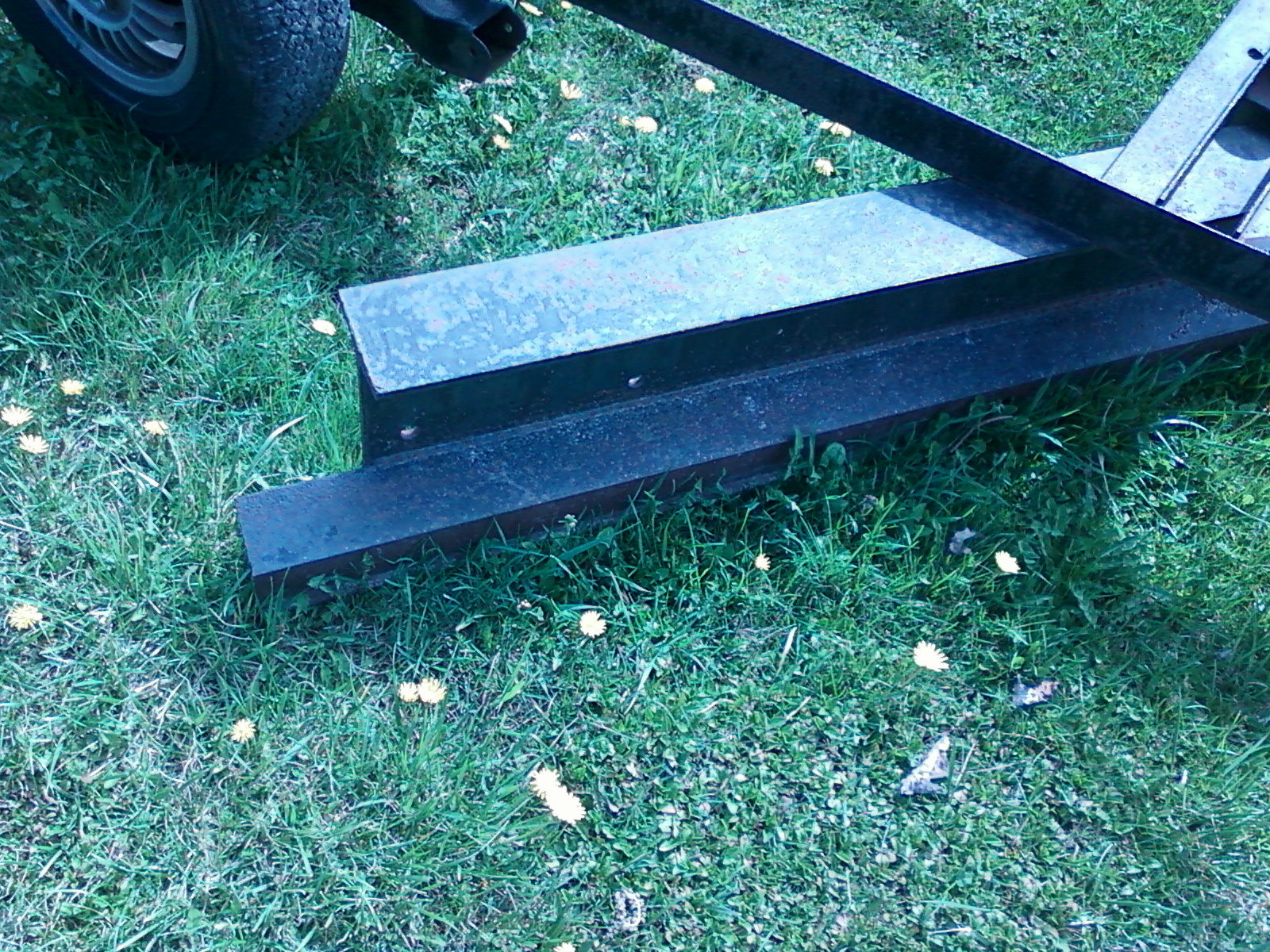

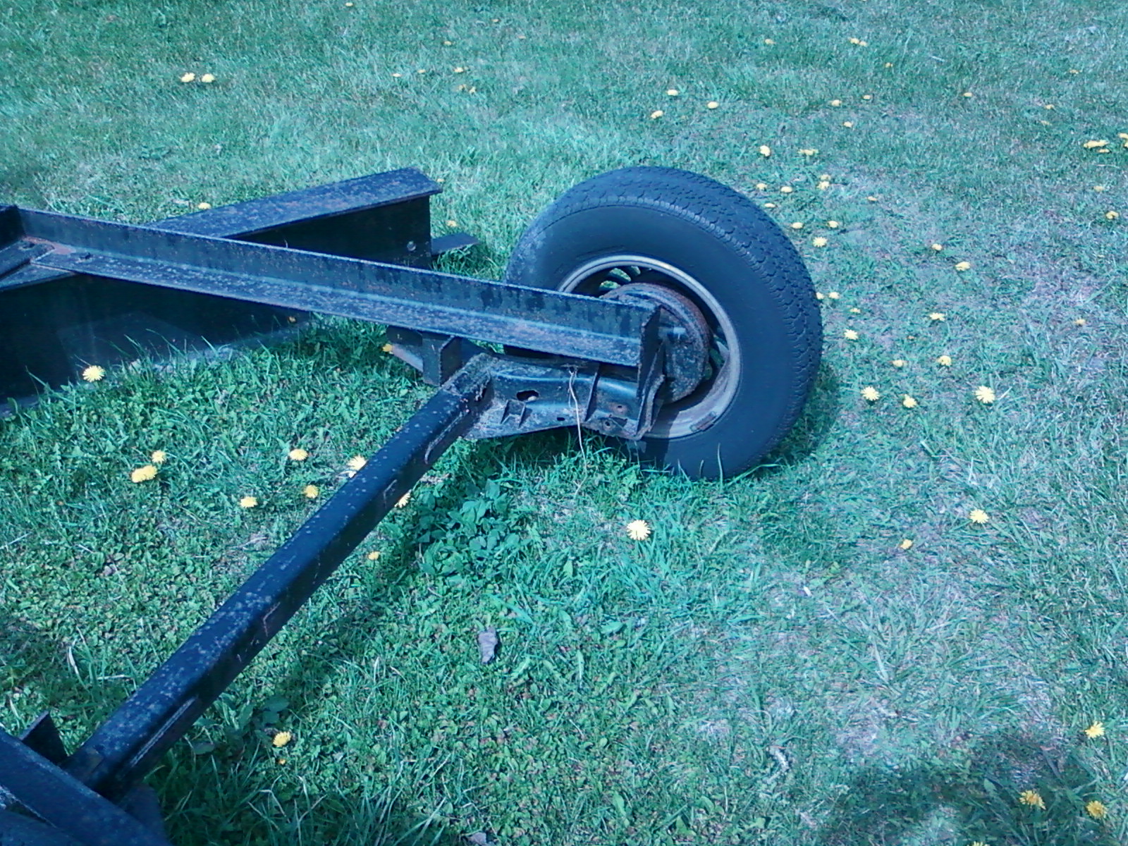

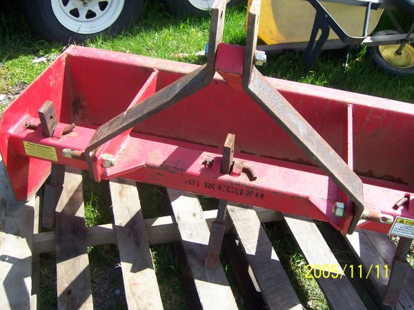

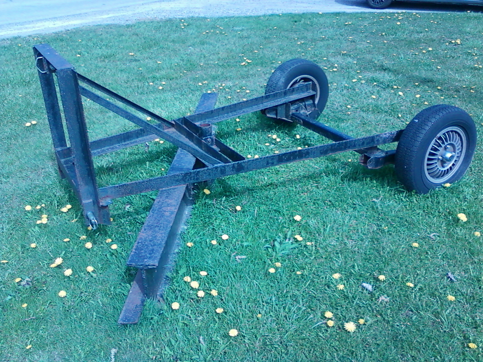

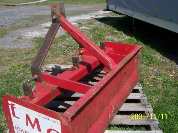

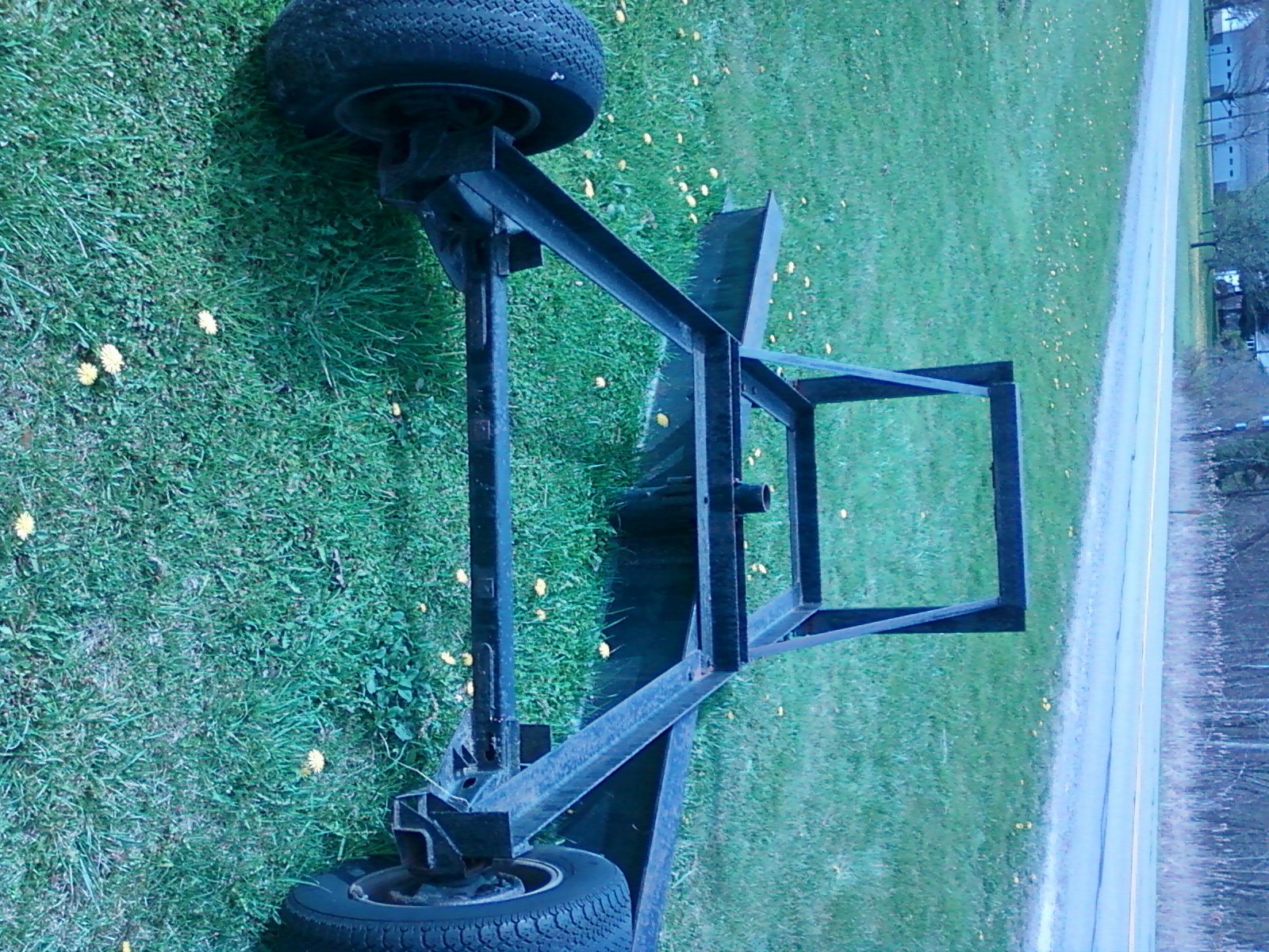

I'm trying to decide what to hitch behind our Kubota B2320 mainly to grade our 1000` gravel drive with a bunch of sweeping curves and a 40 degree grade on a curve for about 150-200`.

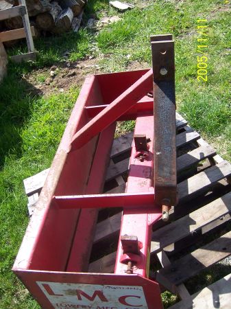

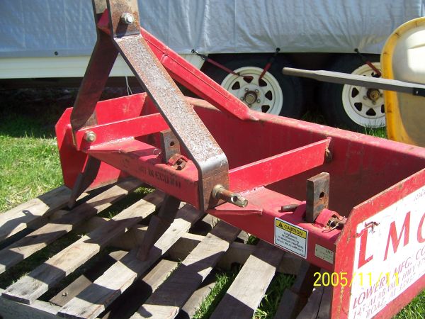

A local guy has a moderately used economy model Lowery Mfg Co 48"boxblade with 3 scarifiers, and welded-on blades asking 300$ or best offer.

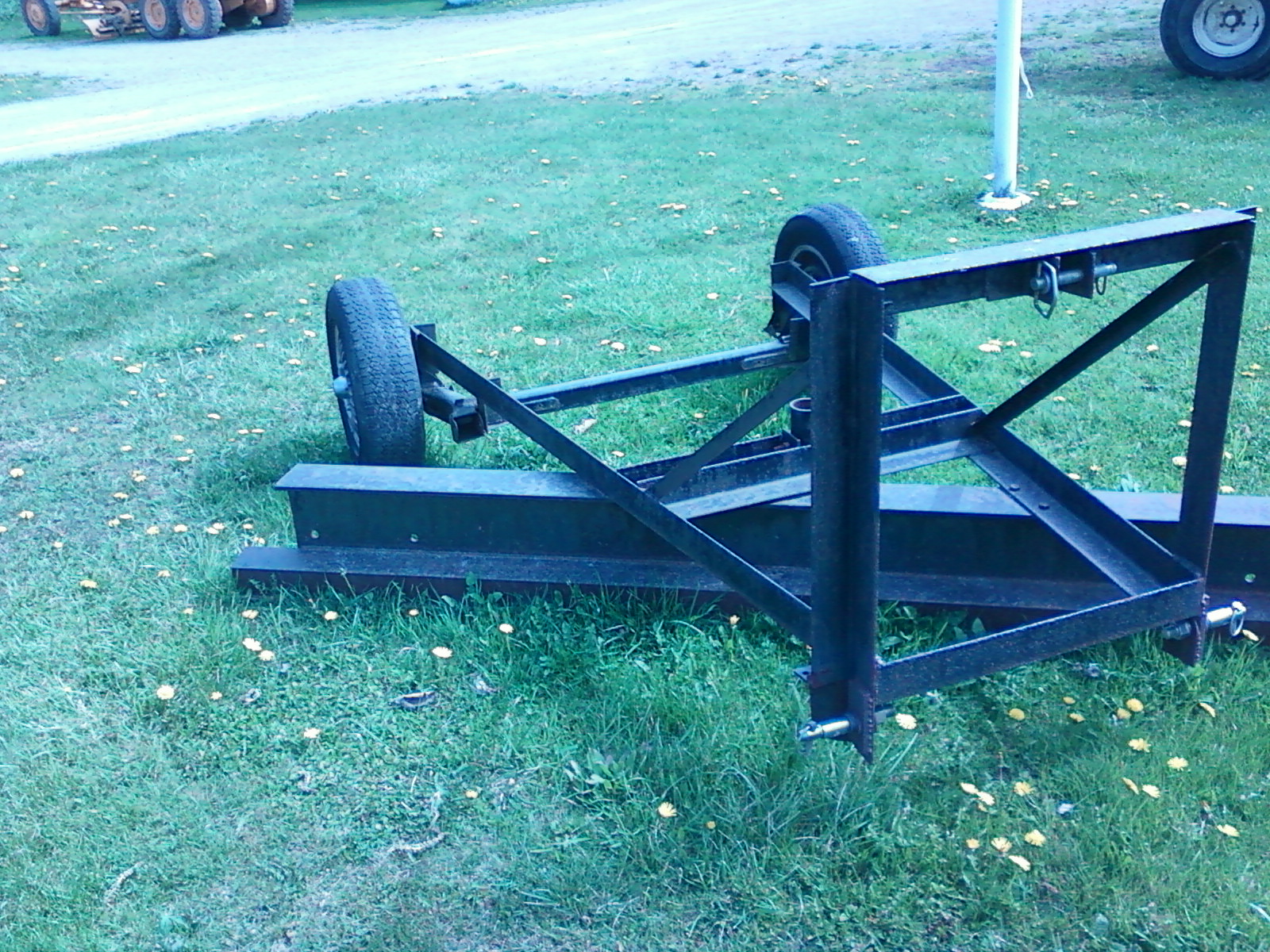

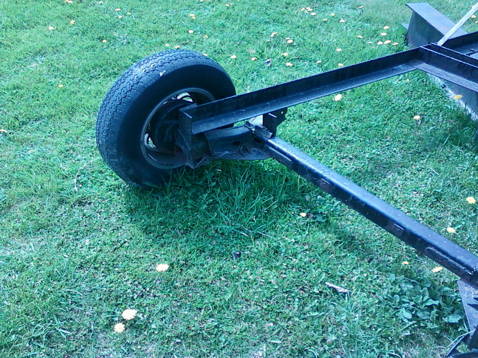

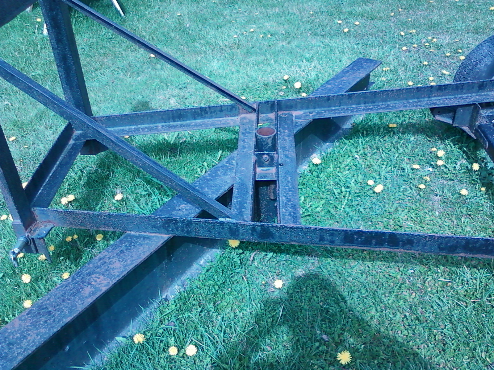

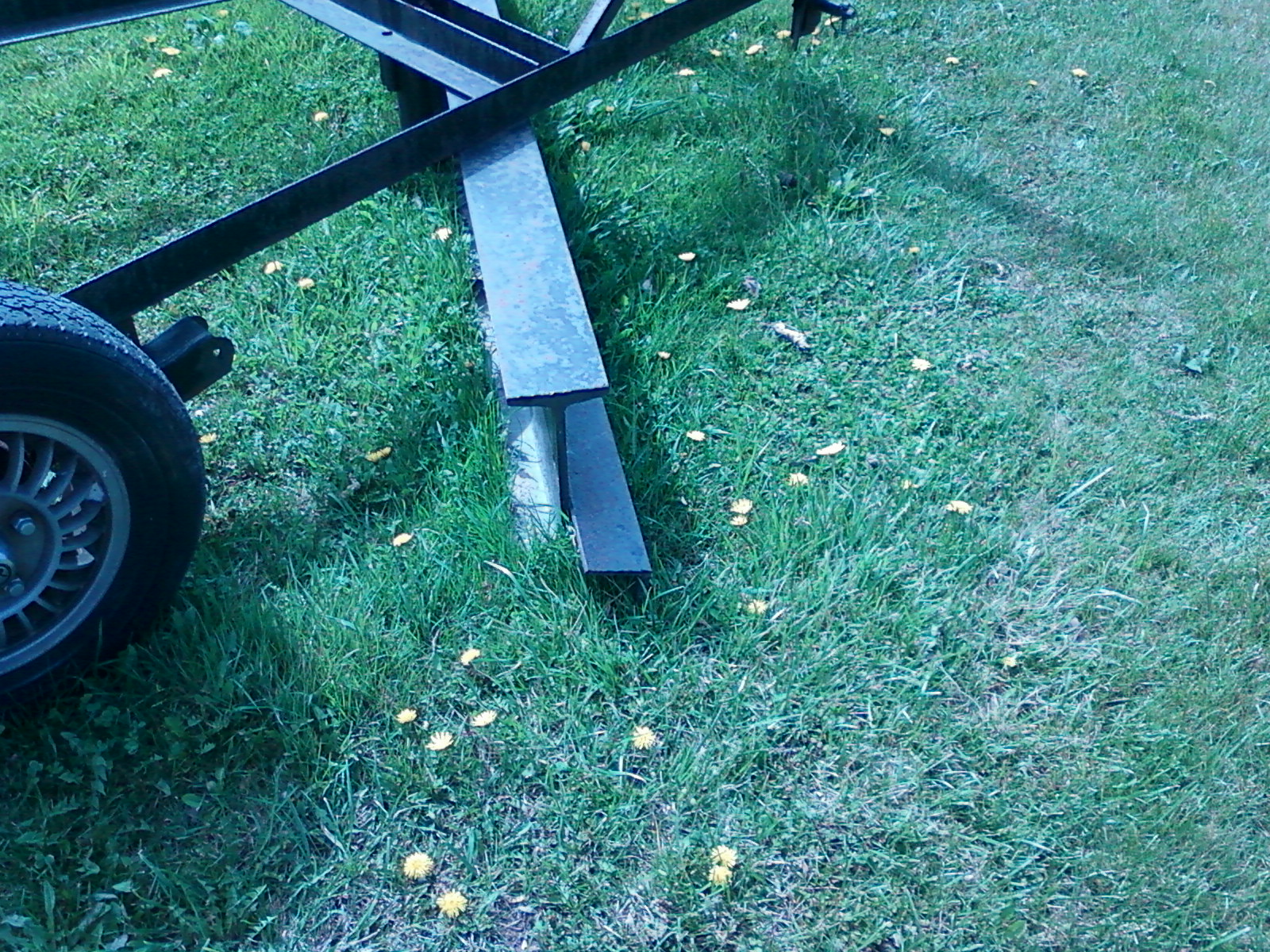

Another local has a homemade grader with a center I-beam blade with angle iron welded onto it as the contact edge, and 2 wheels/tires as the back contact points, and a 3-pt hitch.
Finally, I also have a possible line on a Landpride 5`6" boxblade, new in the crate, for about 400$.
Any help in deciding what will be the best tool for primarily driveway grading, but occasional yard leveling or earth grading would be greatly appreciated.
Pictures to follow...

Sounds very steep, are you sure about the 40 degree grade? Asphalt might be the best solution, doubt you can keep a gravel drive in place. A very steep driveway will require moving the material back up the slope on a frequent basis. I would consider having a better road to the top by a good contractor if there is a way.
For lesser slopes and smoothing of lawn areas a boxblade and landplane grader work well. For crowning, ditching and recovering fines from the sides a rearblade is needed.

I suspect you would be better off with a boxblade for your driveway with an addition of skids. I would get a boxblade that is slightly wider that your rear tires and add simple bolt on skids to it made from angle iron that have the ends turned up like a ski. In your case with steep grades and a small tractor you need to be careful to keep the attachment snall enough you can pull it uphill.
Use the boxblade without the skids (ski) to shape up the material and get it in place, then bolt on the skids to smooth out the driveway. This would be your best bang for your bucks. You would get the benefit of a boxblade and a landplane to an extent. I wouldn't get too heavy since you will be dragging everything up hill most of the time trying to get the materials back in place.
