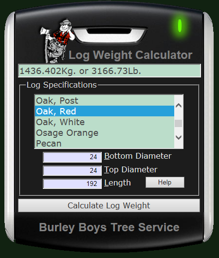

I am looking at the XR4145HC with the LL4104 FEL which has a rated lift capacity of 2713 lbs at the pins. I was wondering if someone with actual experience (unlike me) could tell me if that FEL should be able to lift a 2400 lb pallet from the back of a semi?
   / LL4104 FEL #2
I was moving logs on a set of forks a couple weeks ago with my 4145 (shuttle). I picked up a piece of oak that was a little better than 24" diameter and 16' long (it was longer originally but I had to cut it in half because it was too heavy to lift). It squatted the front tires right down (R1's, 18psi). I have loaded rears and had the backhoe on and I'll bet the rears were barely touching the ground. I didn't have to lift it more than 3 feet to set it on the pile, but it had no problem doing that. According to one of the log weight calculators I found (below), it was more than the 2700# limit, but I was going slowly and it was the last chunk I had to move.
   / LL4104 FEL #3

I'd say no, not safely. I read your post yesterday and thought I would help out. I filled one of those plastic tanks in a cage with about 300 gallons of water(maybe 2500lbs?), set my bucket over the tank and chained the tank to my bucket. The tank was directly under my bucket. I could just barley pick it up about 10" off the ground. My bucket was probably about 4 1/2 to 5' off the ground. I had a large, 6' box blade on the rear. I started moving in 1st gear and in doing so one or the other of my rear tires would lift off the ground. I have no ballast or weights other than the 6' BB.
Right at the ground would be a different story. I was able to pickup and load a 2600lb stump onto a low trailer but again it was pretty tippy. We weighed the stump so I'm sure of the weight.

I think the tractor will physically do it. How safe depends on the operator and the conditions. It is right at the limits.
   / LL4104 FEL #8
No the tractor will not lift that much weight on pallet forks. You are going to be somewhere between 2000-2250 lbs.
If you need to regularly lift that type of weight off of a truck, you need the next size up machine.
