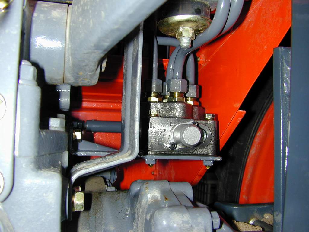

i just got my rear remote kit for my lk3054. looks pretty simple to put together but would like some input and if at all possible a diagram of how the system is installed to give me an idea where the valve and manafold block hooks into the tractor. also there are two o rings that came with the kit and i need to know where they go (i think they go on the manifold where it conects to the tractor) i searched other sites but didnt get any information that realy related to the 3054 other than to remove the fender to make it easier to work. any info will be greatly appreciated thanks.
   / lk3054 rear remote help #2
One thousand words...

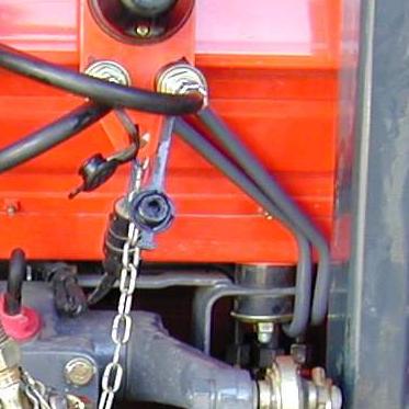

   / lk3054 rear remote help #3
2

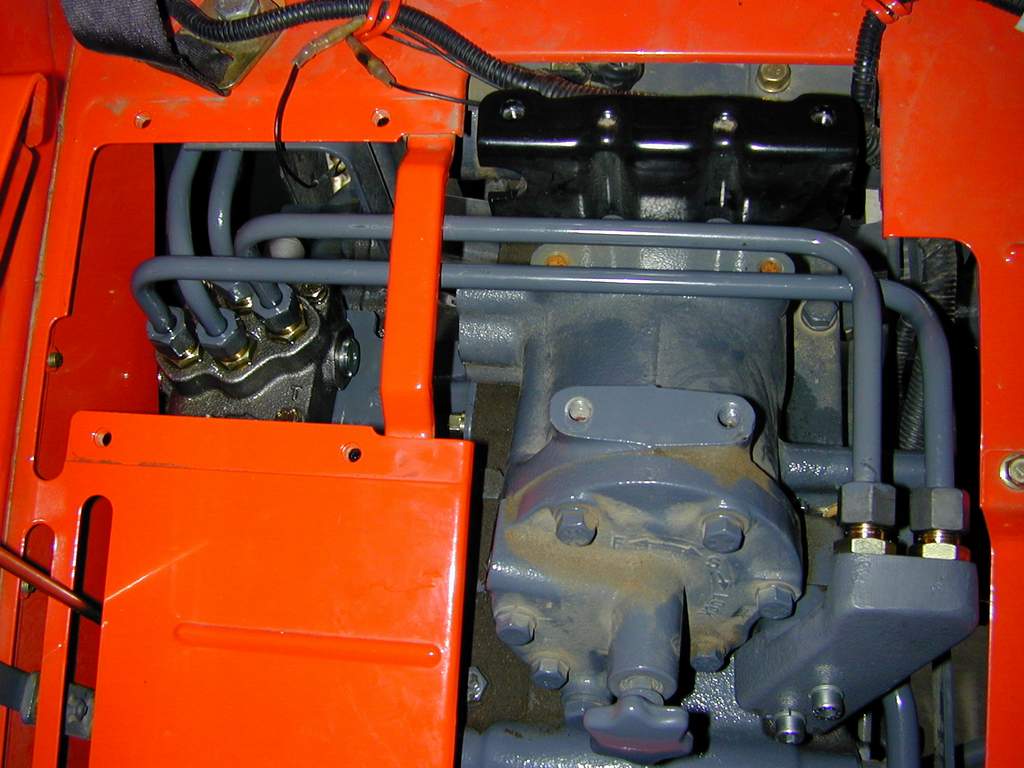

   / lk3054 rear remote help #4
Make sure you put Loctite 567 on those fittings on the valve body or they will leak. Hope these pics help.
thx
Jim

thanks jim. /forums/images/graemlins/grin.gif this is a big help do you know if the two o rings go in the two recessed holes on the back of the part coming out of the right side of the hydraulic speed control knob?
   / lk3054 rear remote help #6
I believe that is correct. They seal where the round block is that you will remove to put the new extension on. Remove the right tire, and fender. It makes the job 10 times easier.
