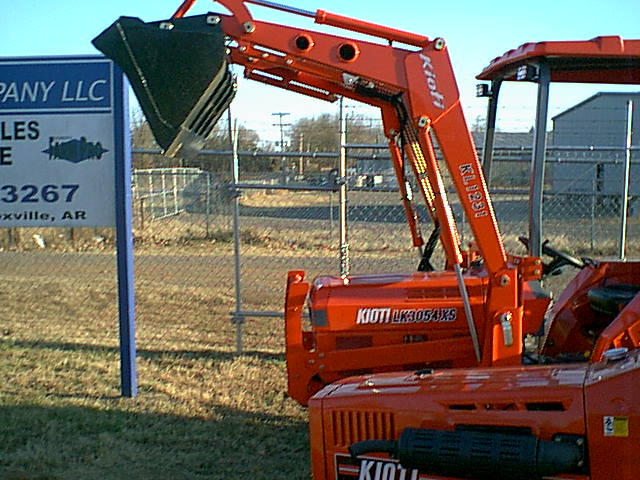

I was wondering if the current loaders have a wrap around design where part of the loader frame extends around the front of the tractor? When they come up with the reach of the tractor at maximum height, which I think is 22", is it in front of this wrap around front, or is it 22" from the bucket to the nose of the tractor?
I know with the CK30 there is less listed reach at max height, but I do not think it has any loader frame in front of the tractor.
Maybe the new 3054xs's have a different design, or I am looking at some old pictures, can anyone help. I want the most reach possible.

I don't know what happened to my reply, I sent one a couple the same day you wrote. I am currious if all the Lk3054's have that frontal frame as part of the loader? Can anyone tell me if when the figure the reach for the loader, do they measure from the loader bucket to the metal frame on the front of the tractor, or do they measure from the bucket to the nose of the tractor without regard to the loader frame?
See, I want as much reach as possible. The CK30 is awesome, and I was sold on it, but it barely reaches into my truck. You have to put the nose against a tire and when the bucket gets in, it pulls hard on the side of dump in order to dump the bucket. The Lk3054 lists a reach that is about 5" greater then the CK30, which may make things alot easier. Course I then have a gear drive and a metal frame to bounce off my truck. /forums/images/graemlins/ooo.gif /forums/images/graemlins/grin.gif

I just checked an LK3054XS TLB and it appears the 22" is from the front of the heavy duty brush guard to the lip of the loader when it is in the full drop position. I took a picture but I don't have a clue how to post it here. says I need a URL for it.

Thanks, I appreciate you taking the time to look that up for me. I think I saw where you looked at the picture under the loader specifications? It shows the bucket lip tipped for the letter D spanning to a point on the nose of the tractor. I could not tell if the other edge is the brush guard, or the tractor nose? Maybe I am missing something, or not looking at what you are, can you help please.

Actually, I fired one up and raisedthe bucket to the top, then full dump. Grabbed a tape measure and got about 22" from the imaginary vertical line below the lower lip of the bucket and the ground and the front of the brush guard. so if the book says 22", it is clearance in front of brush guard.

The picture is in the attachment on my earlier post in case you didn't see it.
