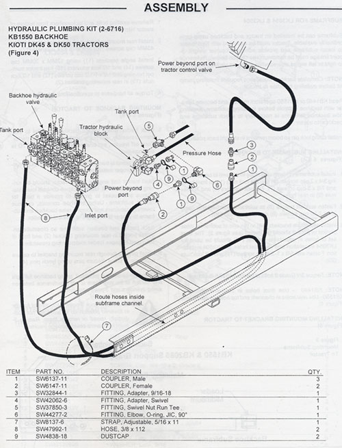

On my 3054 the hydraulic ports are like this:
It has the pressure port, a tank port, and a neutral port.
The loader (Buhler 195) valve is attached to all 3.
Heres the question: If I was to plumb into this for a small BH, would I attach into the neutral port after the loader valve? And would this be the equivalent of a power beyond circuit?

You would plumb into the tank port using a T fitting and a quick coupler, and the power beyond port at the tractor block. I have included a picture of the plumbing for a larger Kioti Tractor. For the best operation you will probalby not want to plumb right into your hydraulics though as the flow on your tractor is about 6GPM, depending on the year of your tractor as they have improved them over the years. It will work, but you may not get the speed you are looking for. When monting backhoes to LK3054's or smaller we always install the PTO pump kit. Now on the Newer LK3054's you won't need the PTO pump kit as it has improved hydraulics.

You could just buy a remote kit for it.
Around $350.
Then you have a set of remote ports when the Hoe is removed and less of a bundle of hoses running here and there.
KO

   / LK3054 Hydraulic ports #9
You don't want to run a BH off remotes, they are for hyd cylinders only. For the BH you need a flow of hyd pressure to the BH. The rear remotes are IN and OUT control levers, either putting pressure to a clyinder or returning pressure. If you hold the lever in the "push" or "pull" position it will cause oil to flow though the relief valve heating up the oil and cause it to overheat.
   / LK3054 Hydraulic ports #10
John,
Curious about how else you would hook this up. My dealer set-up the BH to work off of the aux. set-up. I have a clip to hold the valve open to enable the BH to work. You have me a little worried as I will be using the BH to dig a daylight basement and house footings. /forums/images/graemlins/confused.gif
