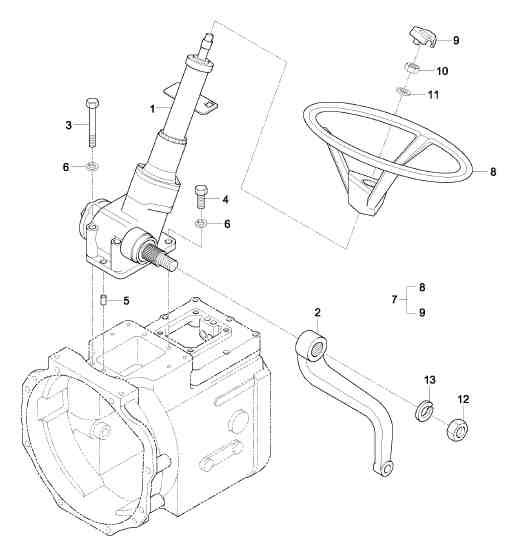

The steering shaft that connects the control arm to the drag link snapped in half this morning. Can't find a part number or any info on how to repair or purchase the part or assembly. I am not sure if just the shaft can be replaced. Looks like a one piece unit. Tractor is 4wd with power steering. Dealer is now out of business.
   / LK 3054 Steering help #2
The "drag link arm"(bolts to top of the drive/steering spindle) T2440-43913
The "tie rod"(links the two[left/right] spindles together) 37650-4396-1
The "drag link"(connects the drag link arm to the pitman arm) T2540-43971
The "pitman arm"(connects the drag link to the steering box) T2540-16341
   / LK 3054 Steering help #3
Unless things have changed at Kioti there are no parts available. You have to buy it complete. Get ready for one heck of a bill.
I would remove the steering pump/motor and pull the shaft. Take the shaft to a machine shop and see what they say.
You may also want to check with Kubota. I quite sure you just may find the parts there.:thumbsup:
