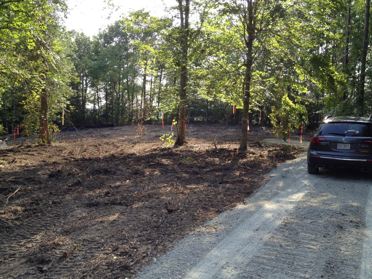

I am clearing a lot for our first home building project. I have removed all of the large trees and will begin the process of stump removal followed by the builder breaking ground.
My question is about living among tall mature Oak, Cherry, Maple and Poplar. These trees are about 100' tall some bigger. They have all been competing for light for the last 100 years so the branches don't begin until 50 or 60' up. Now that I have thinned them for a " wooded Lot" Will they fill in at the top? Do I run any risk of making the trees more prone to fall in a storm? I want to leave some of these huge trees close to the house for shade. What am I in store for?
Any comments on this is much appreciated.
Here's the lot. Notice the stumps up in there, that is where the house will set.

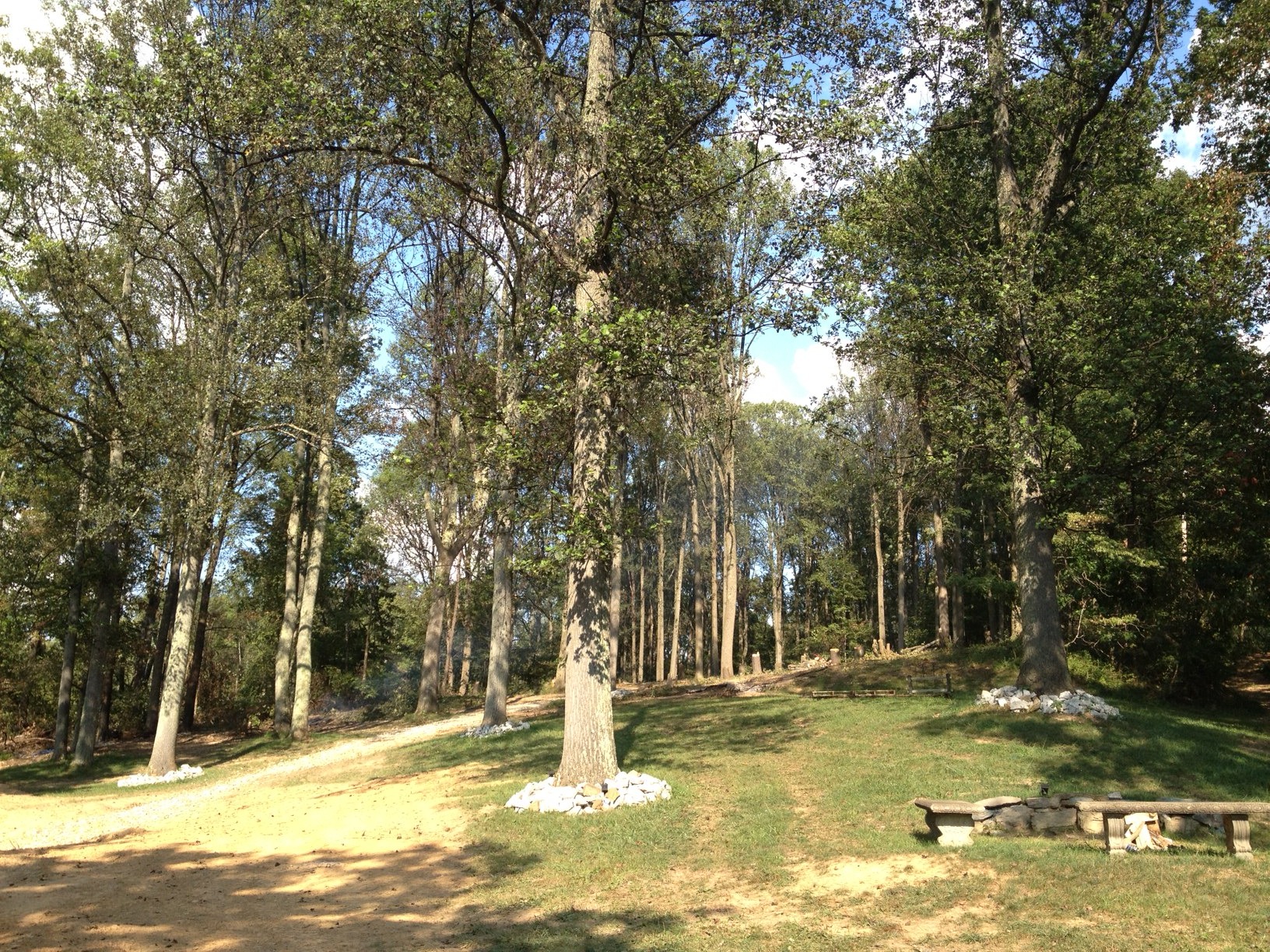

I live in an old mostly Sugar Maple/Beech [ 80-90 footers ] forest in northern Michigan. They are also branchless untill way up, even the cherries are like that. The big problem with your trees is that they also competed for root space, so they will not be as firmly rooted as if they were grown all alone in a field. Even out in the woods, taking down a tree upstream or even downstream from a tree, may allow straight line winds to push it over. But there is no real formula for it. I take down trees N/W of building since this is the direction that most of my high winds come from. But you need trees in the other directions for shade. Not too close to the house to cause the roof to rot from the shade, but close enough that you get some benifit from them.. A tree getting blown over is just a crapshoot, time will tell which ones don't make it. Good luck, Jerry... :) Here is a picture of my type trees...

Whether they will blow down is anybody's guess. Removing trees does usually increase the odds. Could you evaluate each tree that is within "striking" distance of your planned home site to determine if any are decidedly leaning or weighted toward the house location? Those are the trees I would be more concerned about. You obviously want a wooded lot, so you takes your chances :)

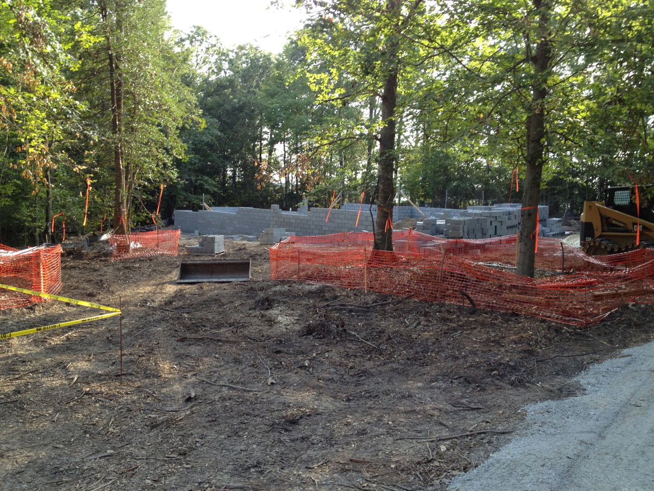

I just finished cutting hardwoods to make space for our new house before the clearing crew came in. I tried my best to keep as many trees as possible, but even then, took out many more than I had liked:
There are three medium sized beeches in the foreground that already had their own space, and I am not worried about them. I have them fenced in with safety netting now, to keep construction traffic off the roots. To the far left are two hollies (about 25 feet tall) with a 80 foot poplar in the middle. There had been two oaks right there, each about 10-12 feet from the poplar, but I took those out due to rot and proximity to the house site. I had worried about wind break, but the poplar was already far taller than the oaks and surrounding trees, so my only remaining worry is changes to the root structure. I want to think about it a bit more -- I can still drop the poplar if needed, but it's a beautiful tree. Still, it's a big tall tree only about 40 feet from the house.
Of course, now that the house is going in, it already looks crowded:
So, my advice would be to make sure you leave plenty of room for construction activity, staging materials, etc...
