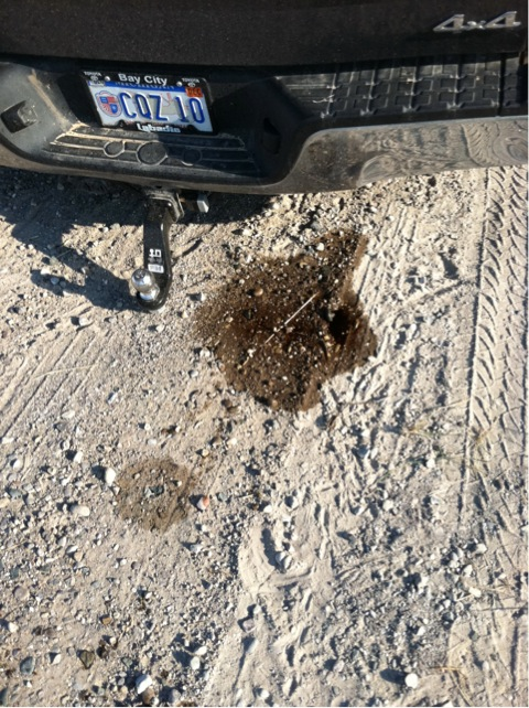

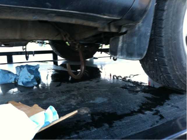

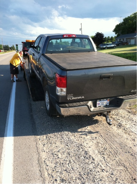

Beside my self. 2010 Tundra, bought new & as only 33K miles have dealer do routine stuff. They changed oil 1000 miles ago. Towed my tractor about 60 miles after that plus general stuff, didn't check oil level nor notice leaking oil--found those spots after the 'event'--& driving w. Grandson & dog far from anything heard/ sensed a noise while rounding a corner, saw oil pressure dropping like a rock so pulled over, stopped engine & oil pouring out of crankcase. The plug had fallen out. Made for a very long day + now concerned about longevity of a truck I love plus pissed I didn't catch it when dripping...but geez...
Towed to parts store & got plug in but even w. 8 quarts added (fine on stick) had top end clatter. Added quart 9 and silence but now facing calls to dealer etc.
It had quite a bit of oil in it when plug disappeared & pressure fine/no clatter until then but I keep trucks forever. I love this truck. Oh man..,just venting.

Pics of it.
