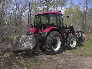

good afternoon....
take a look at the ZETOR /forums/images/graemlins/tongue.gif nice tractor w/cab and a/c, about 45-65 hp/fel....should do the job with that amount of acreage..
will handle almost all the attachment you will need plus they are very competitive with the pricing.....although 6k will make a good down payment /forums/images/graemlins/grin.gif

I bought a new Zetor this year to do the same things you do. Our old tractor is a JD A tricycle - not good for slopes. Take a look at www.fastline.com for used tractor availability & pricing. I could have bought anywhere & drug it home but my local Zetor dealer had the best pricing & on the lot availability. I wouldn't buy without trying first to make sure it fits. Having a local dealer that works with you is a plus.
Happy hunting
