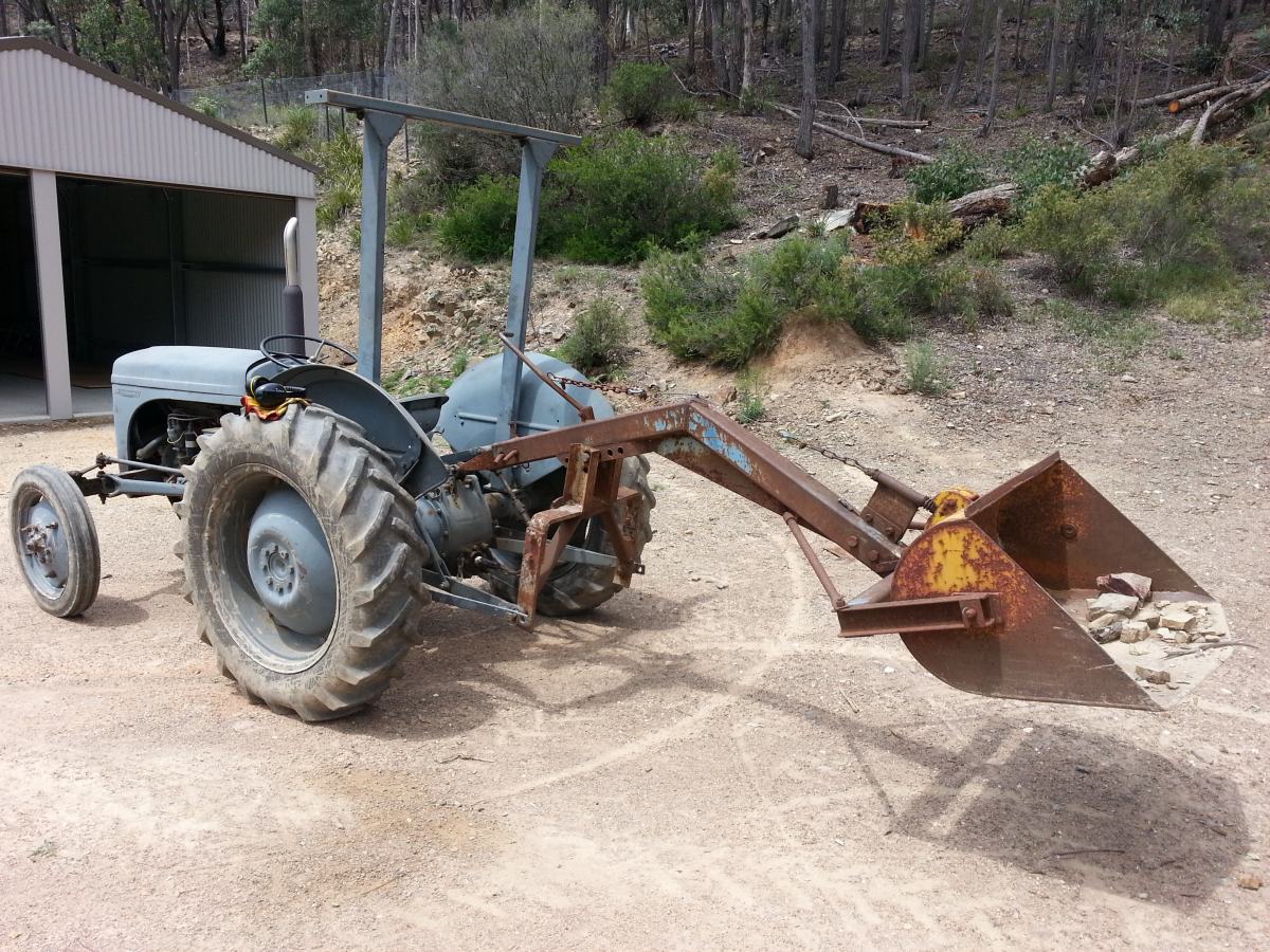

sadly my little grey fergie has decided that the hydraulics wont lift anymore...
well... they will lift a small slasher if the revs are high, but a 3-pl scoop is beyond them.
the fluid level is fine.....
any ideas? im very new to tractors so im not sure where to turn...

Pull the right side access plate, engage the pto and start the engine. UNDER NO CONDITION PLACE YOUR HANDS INTO THE HYDRAULIC CPOMPARTMENT WITH THE ENGINE RUNNING! Using a flashlight, look up at the lift cylinder and see if you see a leak coming from it If so, the lift cylinder needs new rings , or the cylinder is cracked, etc. Look for a lot of turbulence near where the H shaped control fork enters the fluid. The relief valve may have some crud in it and is stuck open. Look at the corners of the pump. If there is a lot of turbulence there maybe a blown pump gasket. Look toward the front right corner of the hydraulic compartment. There is a supply tube that runs up to the lift cylinder. It has some O-rings the can leak. Now actuate the lift lever full up and see that the linkage moves the H shaped control fork. Finally shut the engine off and reach into the hydraulic compartment at the bottom of the control fork and see if you feel a "T" shaped piece which is what connects the control valve to the control fork. Make sure the arms of the "T" are in the sockets of the control fork. Also make sure the cross piece is connected to the control valve stem. You should be able to pull the control valve in and out easily and the total range of motion is about an inch. Some times crud get into the control sleeve and makes the valve hard to move.
Finally, invest in Ferguson factory service manual. They are about $20 US on ebay.

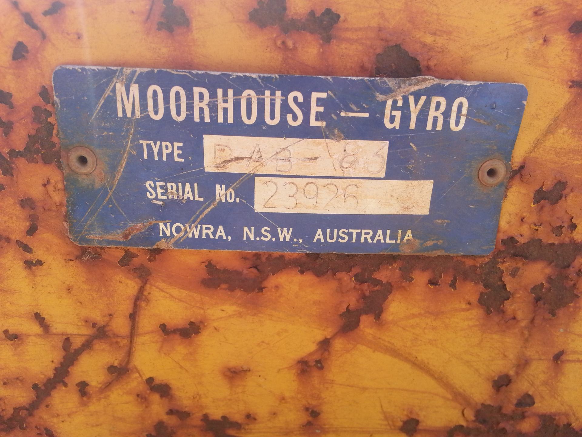

I don't know much about Ferguson's from the era of your tractor. What I do know is I that I admire your rear end loader. Do you know the manufacturer or is it home built.
Stuck
   / little grey fergie....weak lift...
Stuck
made by a local-ish company...
