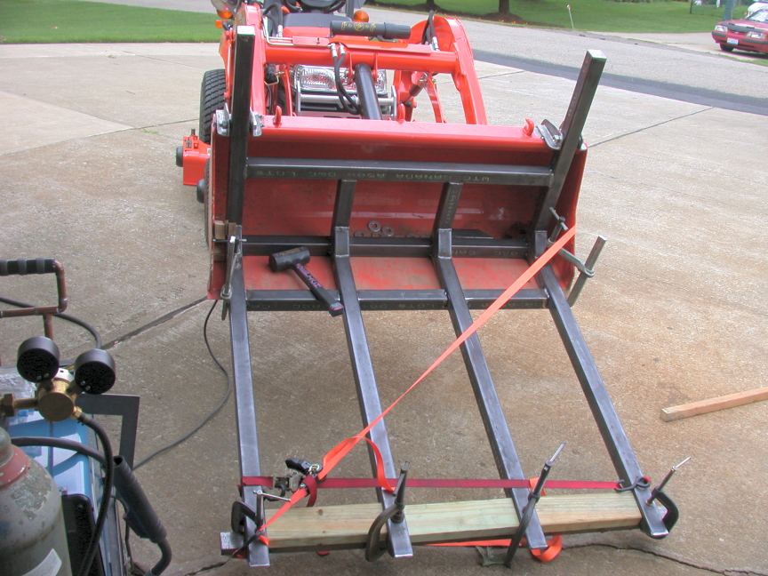

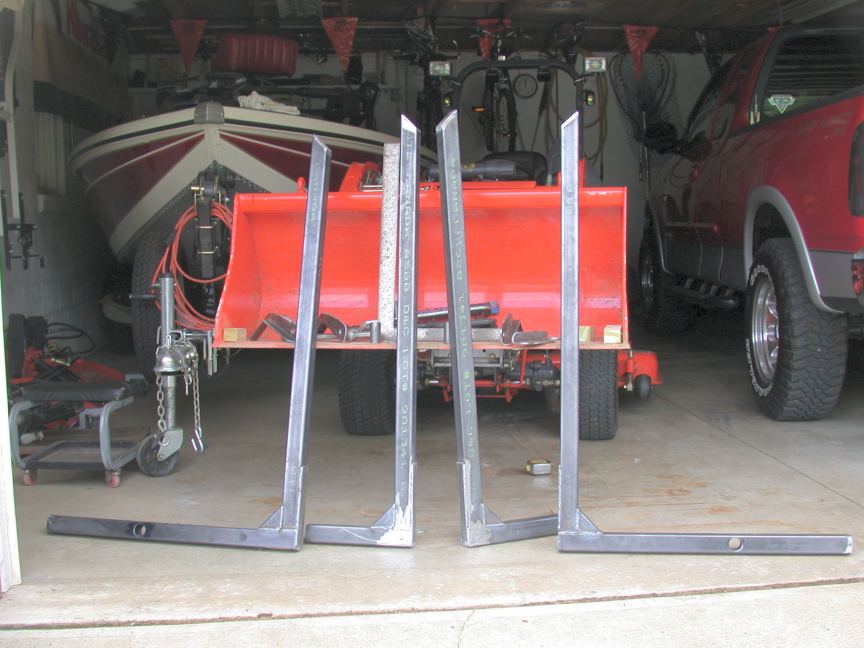

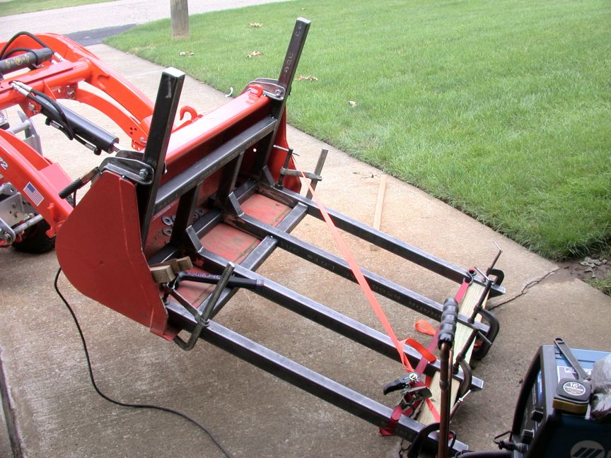

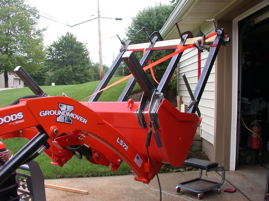

I just got done with the loader installation and thought of some other stuff to build. First is this set of brush forks that attach to the bucket with two 5/8" cat 0 pins. The forks are built from 2" X 2" X .125" box tubing and weight just over 100 lbs. I wanted to keep them light knowing the capacity on my little tractor is not that much. Since the Woods loader is not QA I decided to hook them to the bucket. One bad thing I noticed right away is you can not see the forks in front of the bucket when it is level. If this becomes to much of a problem I may modify them to fit the pins on the loader arms without using the bucket? Next on the fab list is a grapple to mount on the top of the bucket. The grapple will mount seperate from the forks so I can use it with or without the forks attached.

very nice. That quick pin on the top of your bucket is the same idea i was thinking of a set of forks i wanted to make for my bx24, again nice job
Nice work. I am so tired of the single dump cylinder setup on my tractor and the lack of a good QA plate for that setup (that also does not weigh too much). This winter I plan on switching from the one ram to two (similar to the JD design) and then changing all FEL attachments so that they can work with a QA setup .... there are just too many things that would work many times better if you could swap them out quickly on the FEL.

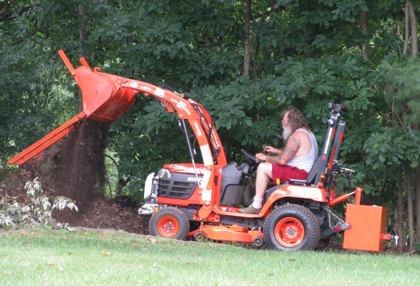

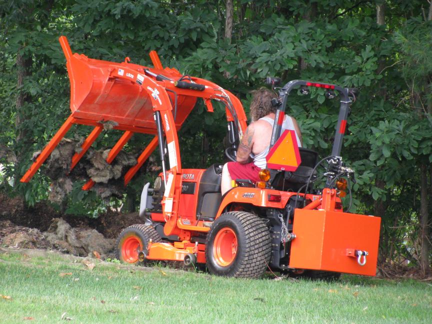

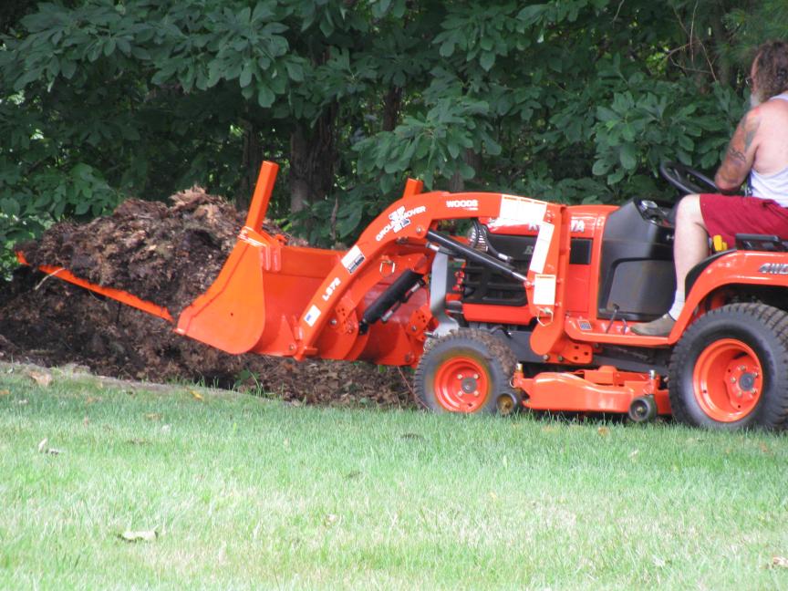

I have a compost pile in the back that I wanted to mix up the forks worked good for that.

I was wondering if you fabricated the attachment points that you have on the top of the bucket or if you bought them?
