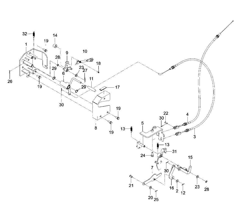

I scanned and attached the instructions. What is important to understand is that part of the install happens in the cabin, in the area of your HST pedals :
The other part is underneath the step, outside the cabin.
The is the full picture of the components that need to be installed, detail in attachment :

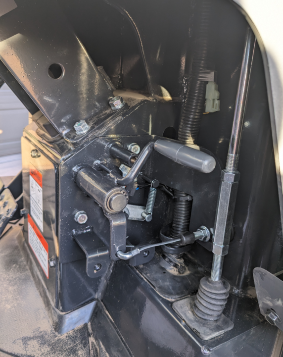

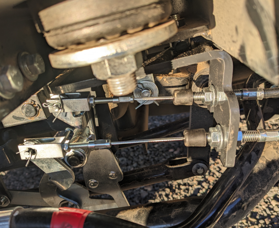

So, I just completed the install and can confirm that on an NS6010HST CAB (and most probably NX) series this is easy. Basically, you have to build 2 brackets which each hold several components. Fabricating these brackets can easily be done in the comfort of your home or shop (temps have already dropped to 10F here in Central OR). Next, one bracket goes inside the cabin and another one underneath the R footstep. The brackets get linked by 1 cable which goes through the firewall. Another cable connected to the bottom bracket goes to the throttle. That's it. Took me like 3 hours, but could repeat it in half the time based on learning curve.
Main difficulties were getting the grommet into the firewall (some WD40 helps) and pushing some of the levers into the brackets (Kioti seems to apply liberal amounts of paint to their parts, which doesn't help in case of a tight fit between new components). Easy DIY, just take your time and follow the Kor-English instructions.

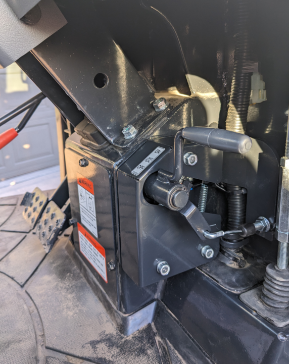

Here are some pics of the final product.
Bracket installed in the cabin :
With the cover installed :
Outside bracket, underneath R step :
