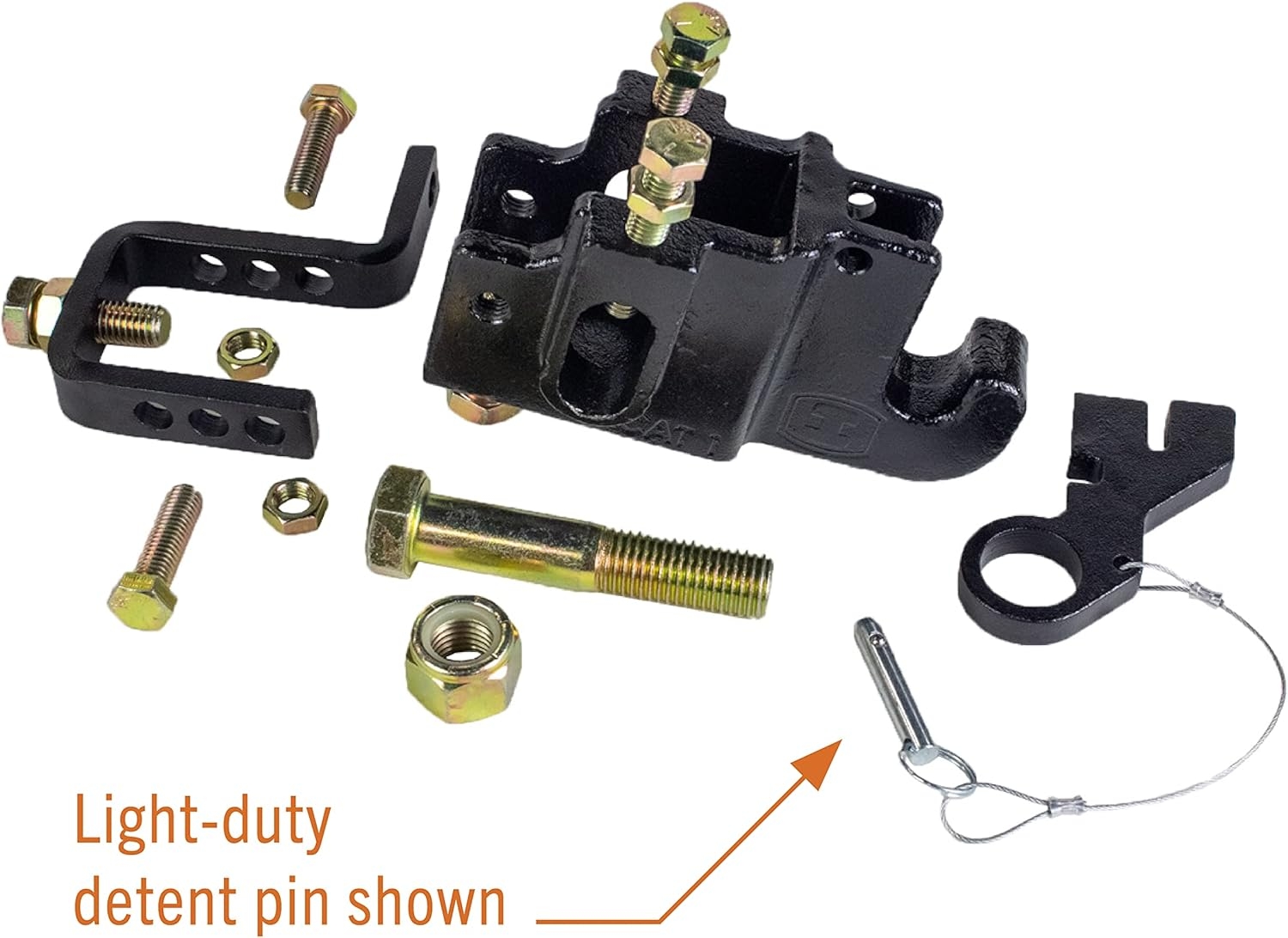

That does not lock into place by itself. You have to lock it in yourself with putting the "key" in then push the "detent pin" in...

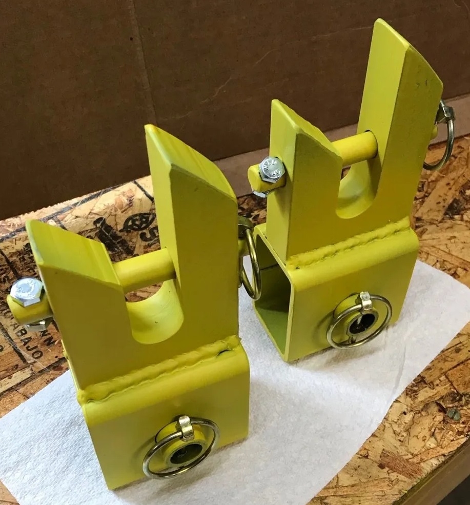

Looks a little dodgy to me... I can see losing pin and then lock assembly....
I considered that, then inspecting the Pat's I see a spring that is vulnerable to loss or damage.
Old and Tired; That looks like it will bend on a hard pull on the pulling arms. Not for me.
   / Link/pull arm quick attach devices #6
Half the cost is suspicious. I did some searching, because the Amazon description mentioned designed in the USA while not explicitly saying that they are US made. MotoAlliance uses manufacturers in the US, China, and France. At such a a cheap price, I am certain that they are Chinese made.

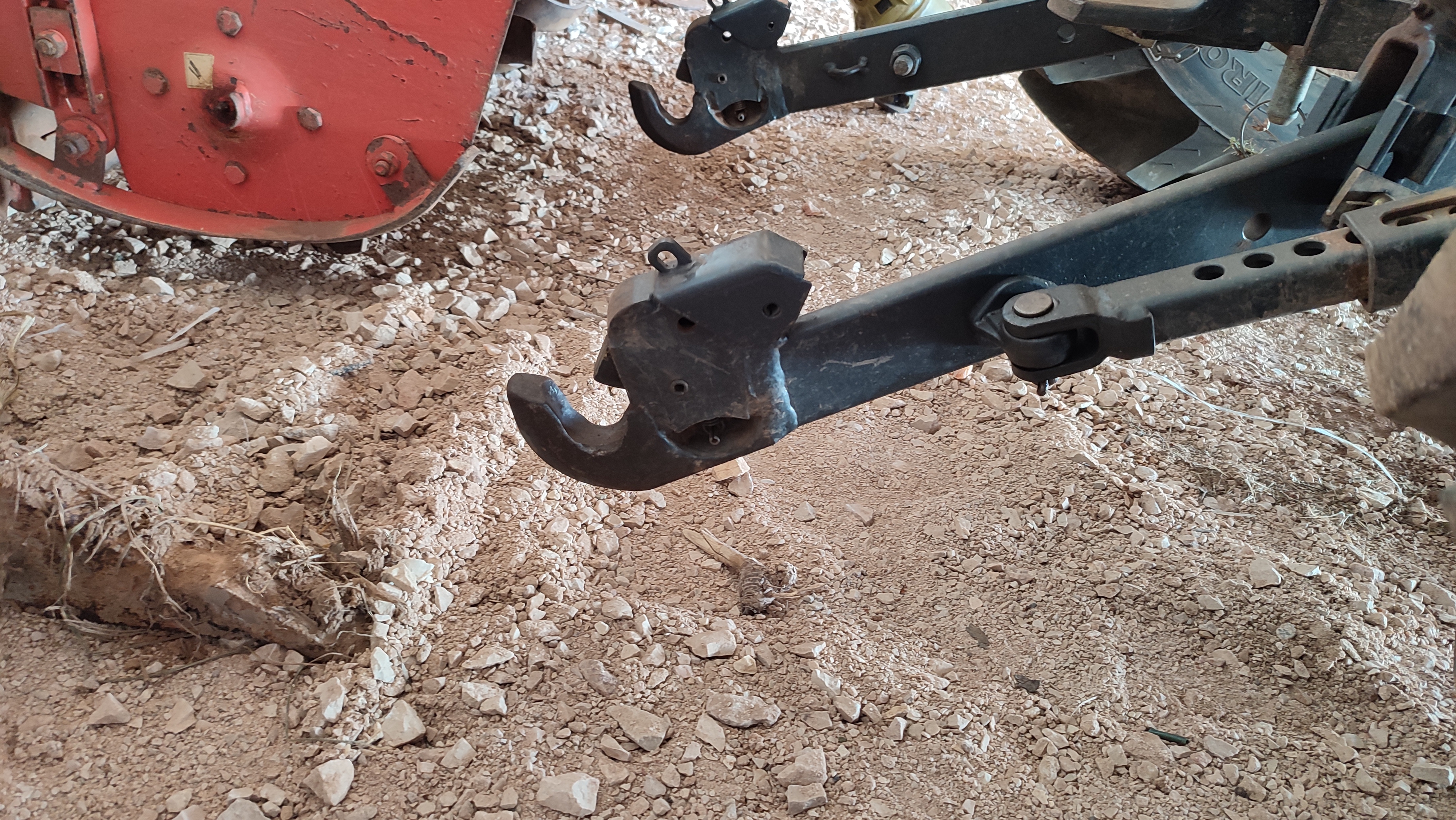

I still recommend the lower link hooks or Euro hooks 100%. Yes, it requires cutting and welding for the tractors that don't come with it as standard, but it's well worth it and it just works.
As far as price goes, around here, I can buy 2 hooks for about $65 each.
   / Link/pull arm quick attach devices #8
Wonder how easy it would be to manufacture those hooks so that you slide out and remove your OEM ball ends and insert the hooks on tractors with extendable arms?
   / Link/pull arm quick attach devices #9
I bought euro hooks a couple years ago from fit rite Hydraulics , wasn’t cheap but I’m glad I spent the money because they work excellent, hooking and unhooking is so much easier now , I just wish my LS tractor would have come from the factory with euro hooks , in other countries LS sells tractors equipped with euro hooks but not in the USA and I would like to know why.
   / Link/pull arm quick attach devices #10
Extendable or telescoping auto-locking lower arms are a great convenience hooking up to heavy implements.
Note that the ball ends allow for up and down plus fore and aft adjustment of the implement. That ability to offset and tilt really helps in some situations and is not possible with the euro hooks.
