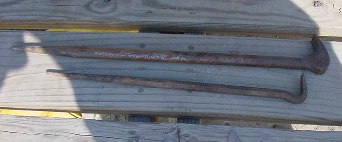

Here is a picture of a couple of tools I always keep on the tractor. They come in handy not only for shear bolts but lining up three point implements as well. When digging postholes I also have a pipe wrench handy as well.
Also what I did on my auger head shaft was take magic marker and draw lines where the shear bolt is to help figure the general area the auger needs to be in. I put the magic marker on because my auger spins hard on the head and it sure was getting old quick looking for the magic hole.
Hope this is of some help

Maybe "spud bar" is just a local term (Ohio and NY). Its what I've always used and I'd be hard pressed to think of anything else to call it. Whatever its called there are many times it has been worth its weight in gold.
   / Lining Up Shear Bolt Holes #9
Interesting how the same tooks are called the same all over the country, I know they are called that in Okla, Texas & California.
I am using the spud wrench (I think the term comes from putting rivets (spuds) in steel construction).

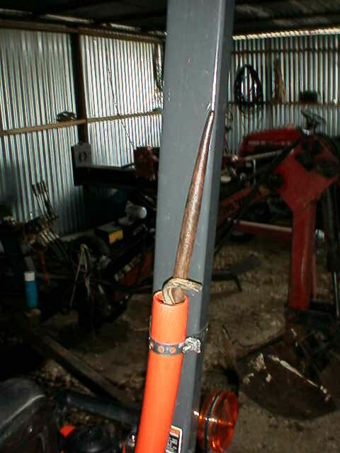

anyway I also have a stright one and I carry them in a piece of fiber optic PVC clamped to the ROP. If they are putting in any fiber optic cable in your area, it comes in all colors so you can match almost any tractor color.
They throw away a lot of pieces up to 4-10 feet.
Photo attached
