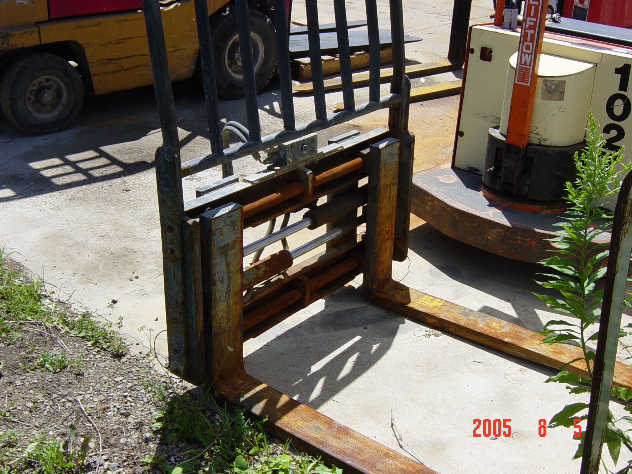

I bought these positioning forks from a scrapped lift truck. Cheap! I could not have even started to build anything for that money. My moto: Never build something you can buy better and cheaper. They are awesome! I even use them to pinch things like stumps but probably shouldn't. I agree, an electric actuator probably isn't up to the task.
