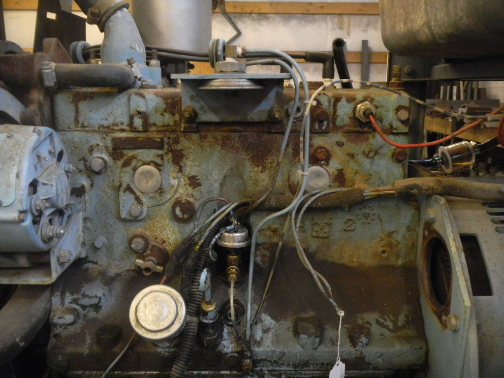

I have a continental engine that I purchased recently. I was told that it came out of a sa200 ,the problem is it has no ID tag nor can I find any #s on the block. is there another way to tell what I have? It's loose about 90 degrees then stops like it has rust in the bores, gonna pull the head off it but how can I order parts if I dont know what I have?

If it did come out of a Lincoln SA-200, you either have an F-162, or F-163 Continental engine.
One easy way to tell, the F-162 will have a pipe cap for the oil filler cap like this one.

Thanks SA . it looks like the 162. Oil fill and dipstick in the same location .check. starter down by the pan rail.check. about a 1/2 inch plate on the rear or the engine has rounded edges but otherwise looks the same. check. BTW it has a gear driven Mag on it and the carb looks to have a separate idle linkage on it .
were the 162's and 163's the only continentals Lincoln used?
My purpose is to build a standby genset.
so I guess my next question is does anyone know what the power output is at 1800 Rpm ???
Thanks again !!!
Scott
Oh, and can a bellhousing be adapted ??

Far as I know the F-162, and F-163 were the only engines used in the SA-200. Now some of the SAE-300 and bigger welding machines used a 6-cylinder Continental.
I don't know about adapting a bellhousing, but I don't see why not! You do know these engines are used mostly in forklifts, and tractors, correct?
This site is a little hard to get around in, but everything you'll ever want to know about an SA-200 is here. Just have to dig around.
