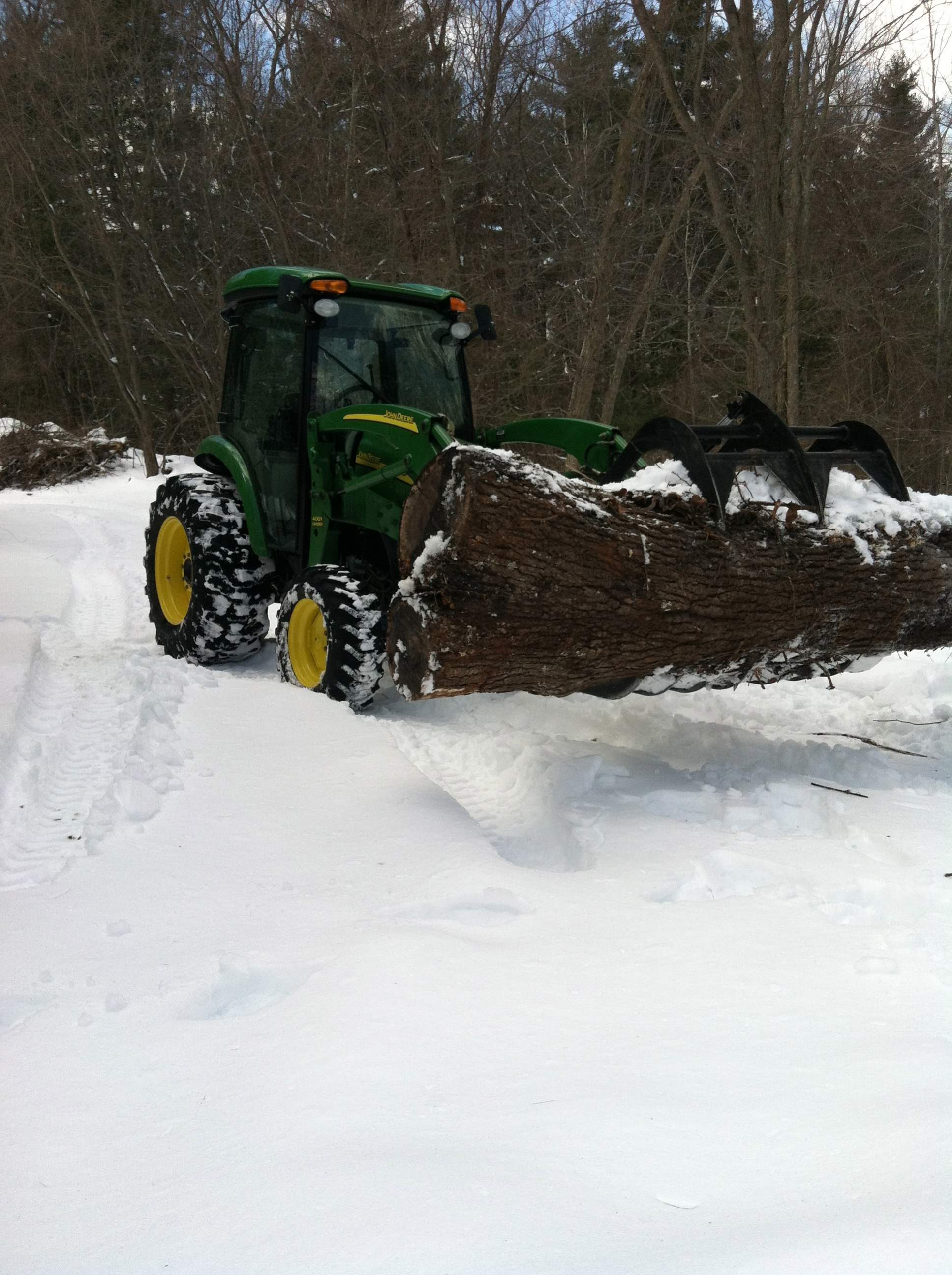

I too am a very satisfied Wildkat 48 owner-there are many of us on this site-can't beat the value-light enough but strong enough. I have a JD 4720 but one of my kids has a JD 2520 and it works well with his smaller machine too. Mine is a bit over a yeart and I paid 667-delivered to Mass.

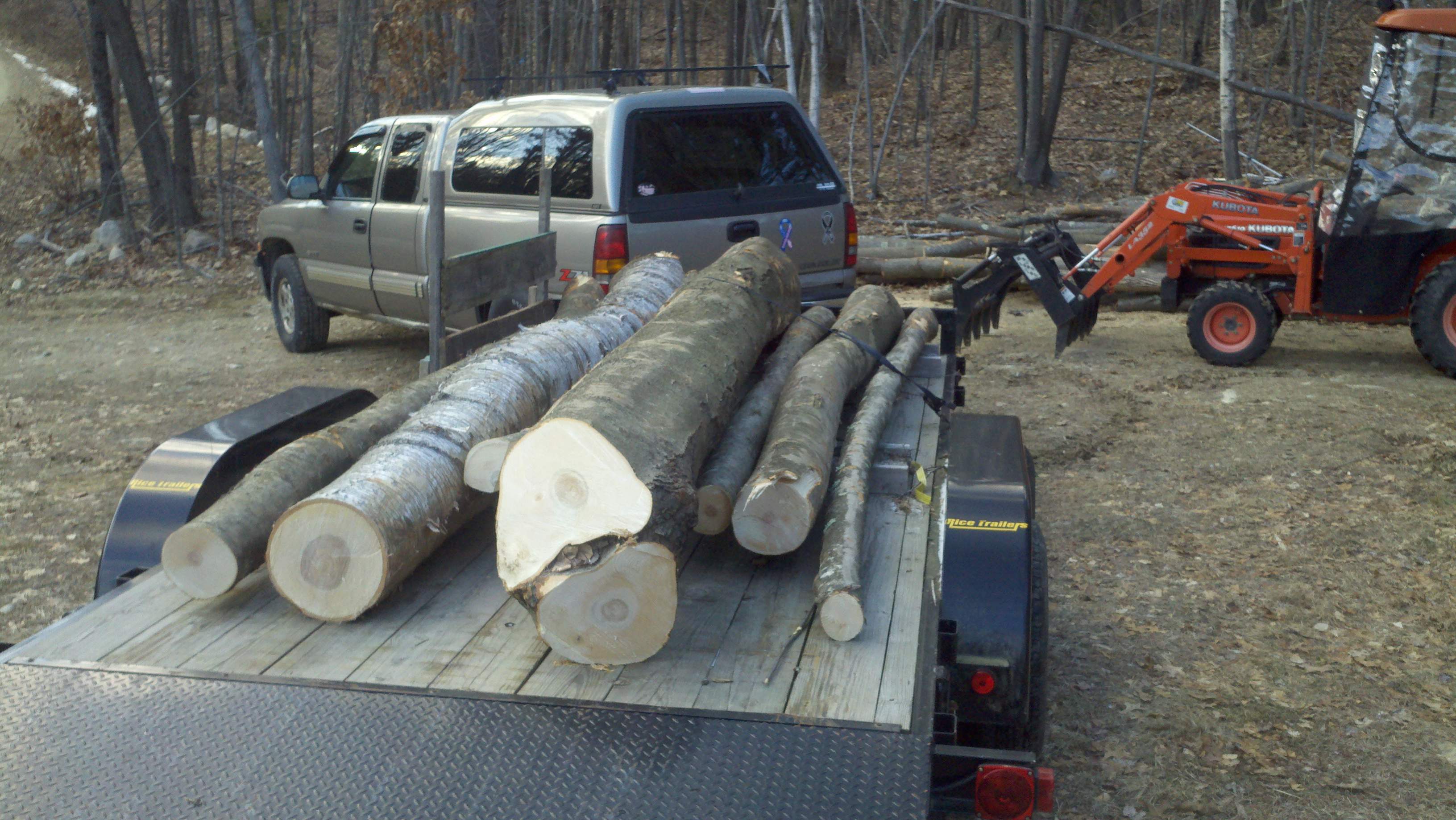

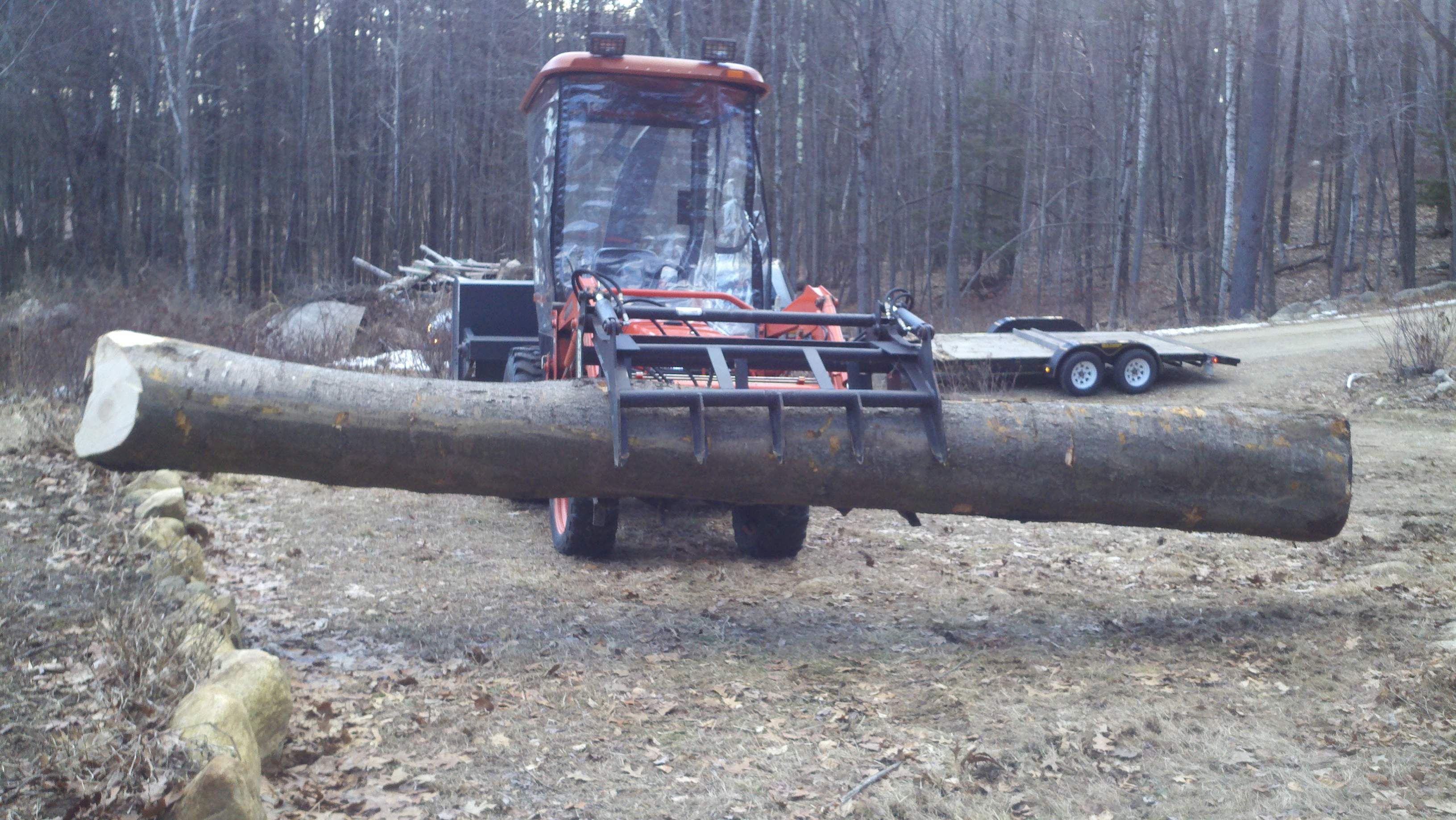

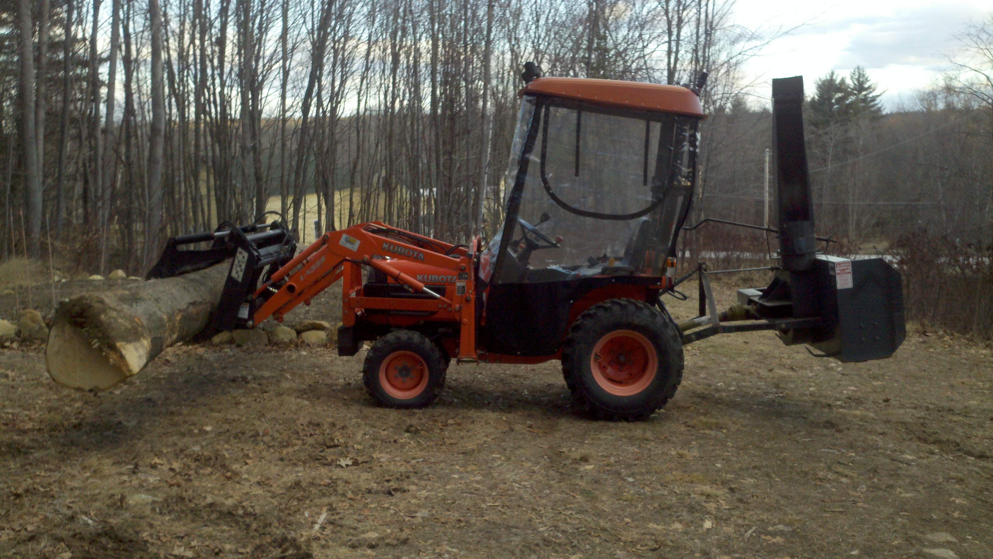

I have a WR Long RBG2-48 grapple and LOVE it. It only weighs 325#, and the jaws open to 48". While the price is on the high side, the quality is second to none. I have used and abused this grapple since 07 with no issues at all.

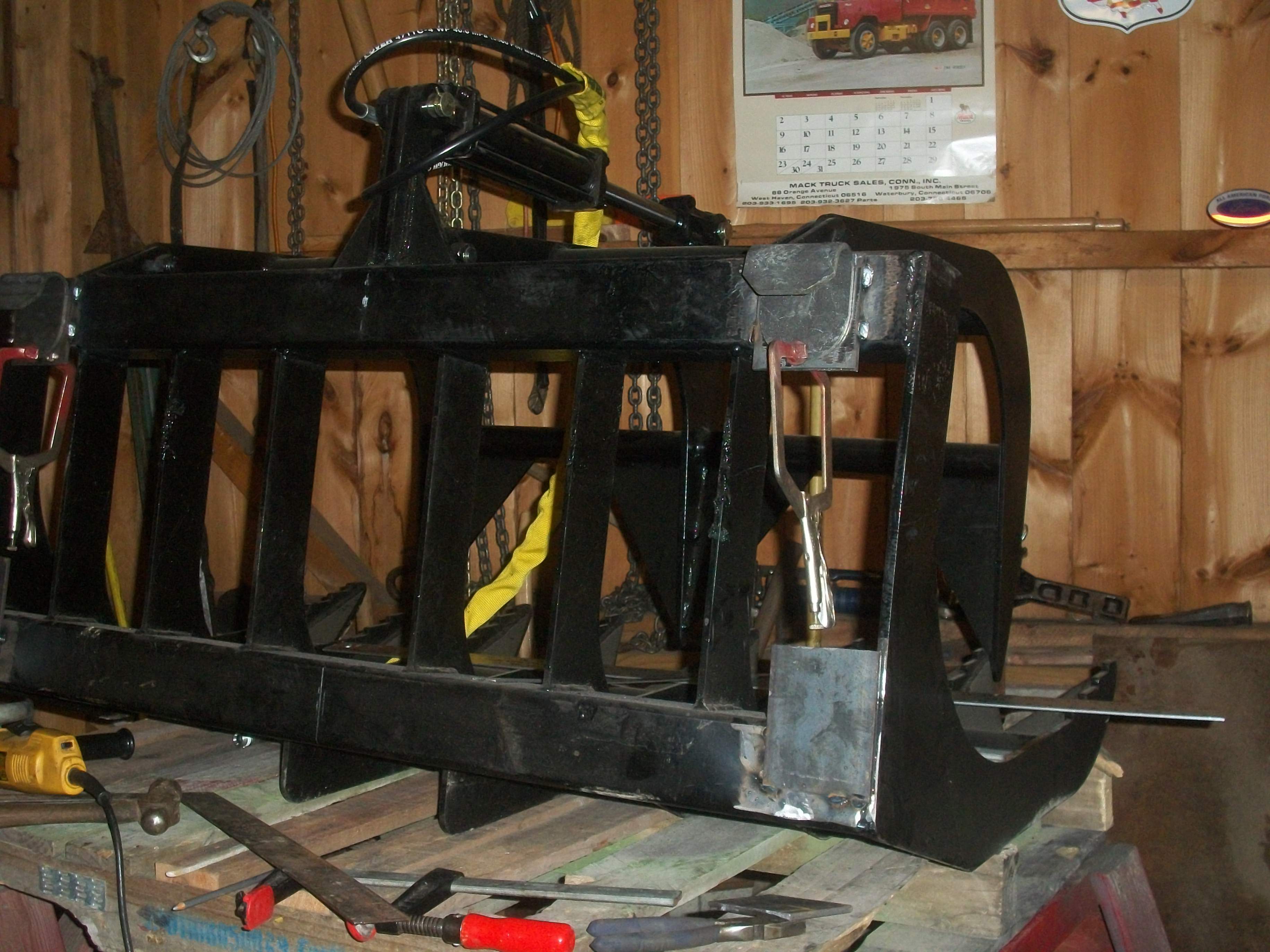

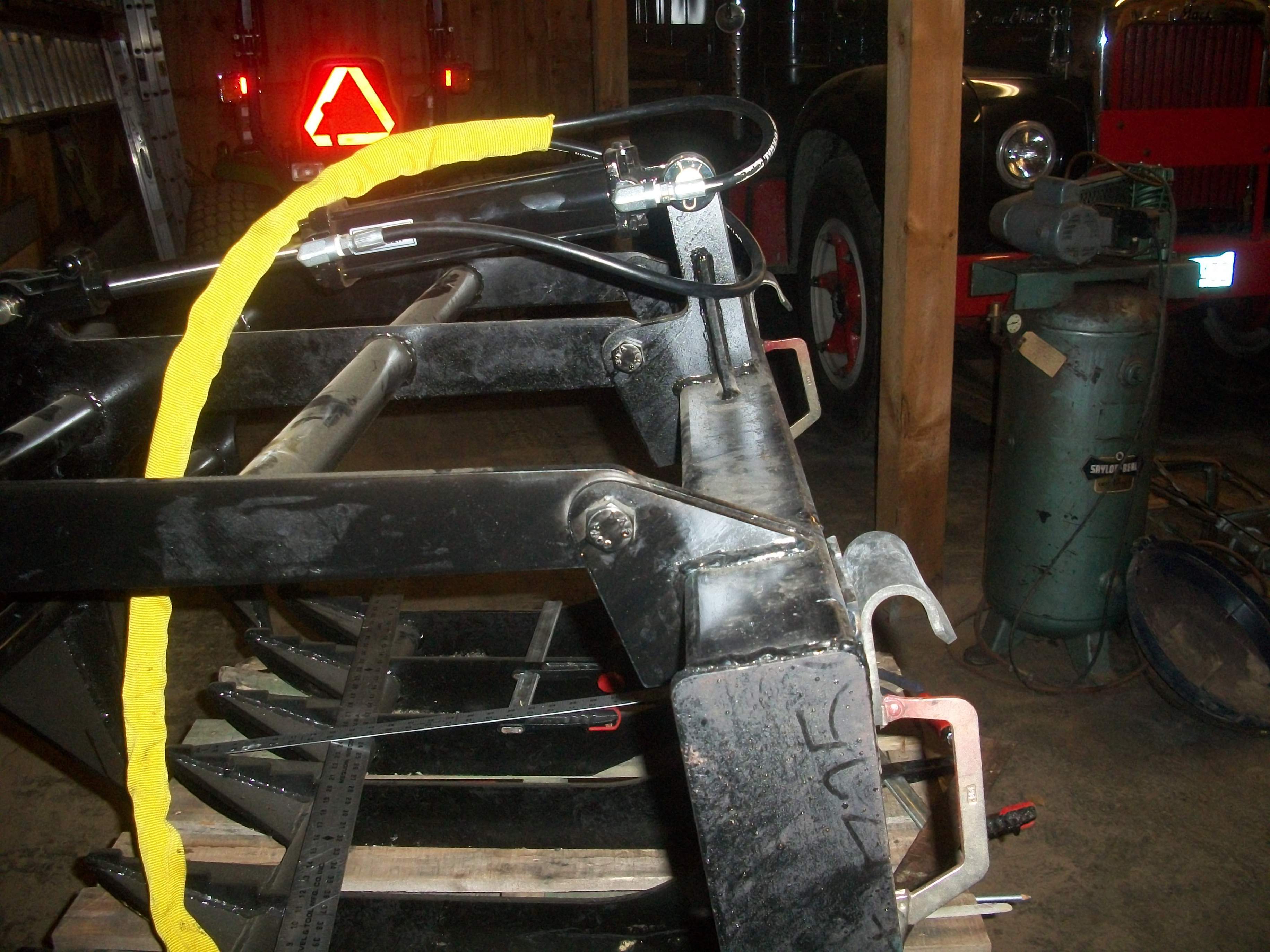

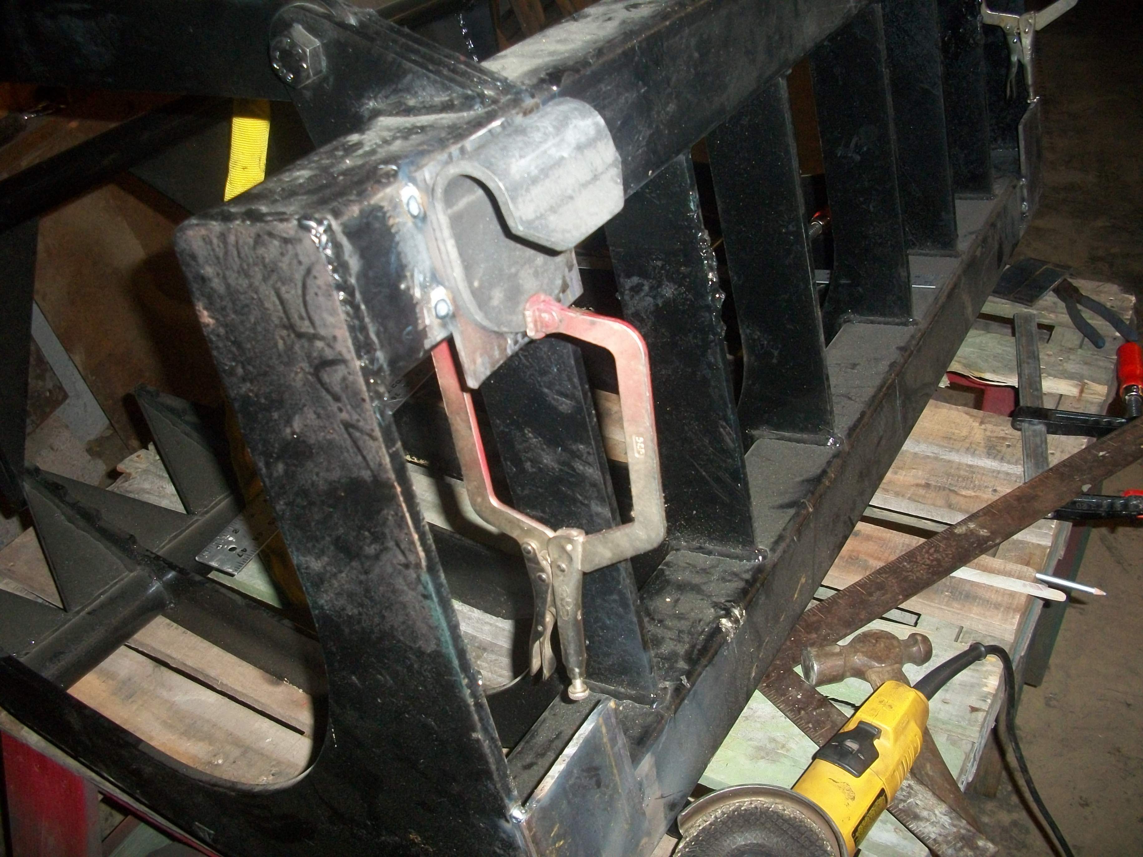

They offer JDQA. For whatever dumb reason, I had them ship mine without and I bought the hooks and the lower "bullets" and welded them on myself.
