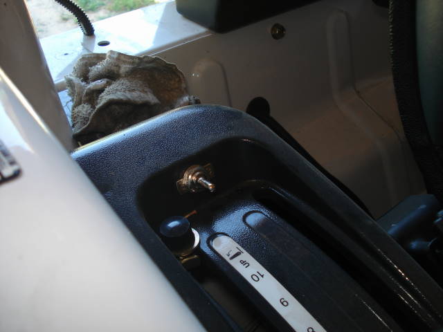

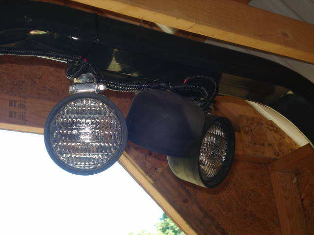

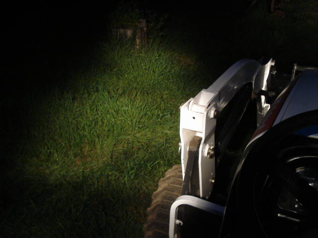

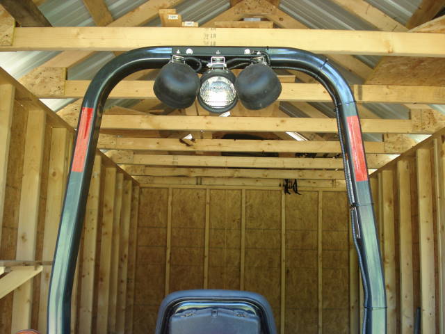

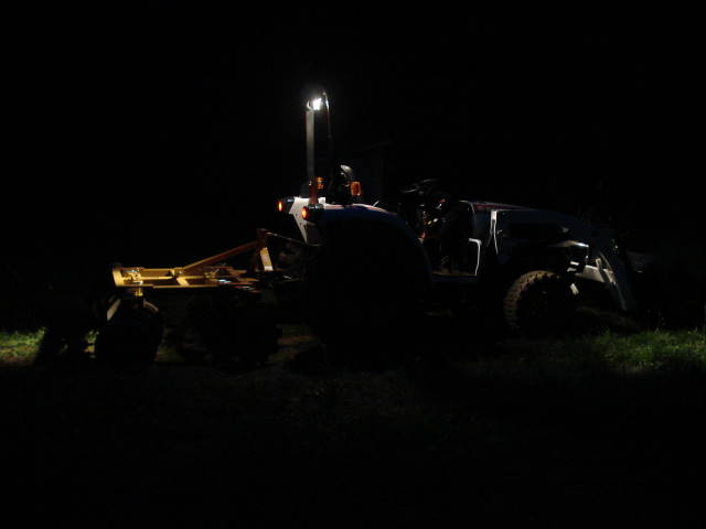

Now I can see! My tractor of course came with head lights but you need more for driving around at night don't ya. My Bobcat had two leads off the back I found was a 20 Amp fused circut for extra lights. I powers 3 lights well. I don't quite know what amp lights they are (11$ rubber mount lights at NAPA.) I installed a switch because power was always on when ingnition was on. One light in back two for each side. :cool:

Should work real well during snow removal.:)
   / LIGHTS! #3
Very nice work. That rear facing light will come in pretty handy too.

Nice. How close are you to the top of your garage? Looks pretty darn close.

Nice- check that your current draw does not exceed the switch rating, if so put a relay in and happy snowblowing!!

good lord, you've drilled the rops on your tractor! the space-time continuum may unravel :D just kidding, but i had to get that in - i can't believe none of the rops safety nazis didn't get to it already.
looks good. i've been meaning to do a similar thing to mine, but i haven't got around to it (as is the case with most of my planned projects). i use a backhoe on mine and would like the evening hour lighting conditions to extend later to finish up jobs. it also seems that when traveling/working forward the bucket always obscures the lights, so a set of high-mounts in both directions would serve well. maybe i can think up a swivel mount system so i don't need four of them.
I have a few inches above my roll bar. I bought the tractor first and built the shed around it. :D
