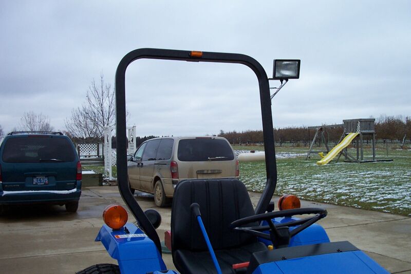

Here's my light on my TC30. I build a bracket and drilled, tapped, and bolted the unit to the ROPS. I used the small 1/4 size bolts to minimize metal loss to the ROPS. I have wired this into the auxillary circuit that terminates under the right fender. If you look closely at the top of the right fender you can see the rubber coated switch that turns it on or off.

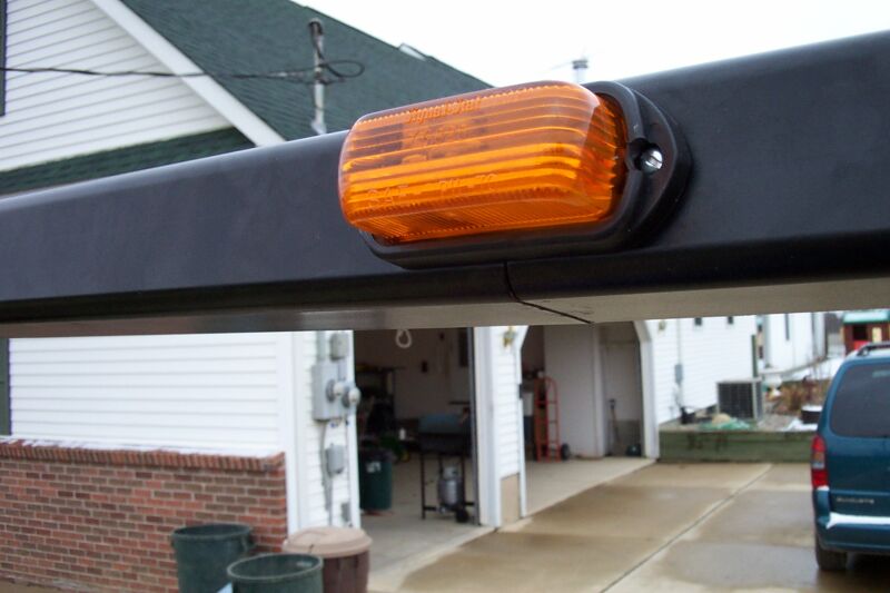

You can also see the additional hazard lights that I added at the top-center of the ROPS. There is one in front and one behind. These add visibility up high where it's most visible.

Another view of the lights on top-center.

Jerry,
I am going to end up with my forward facing lights in about the same location as yours, but with a variation on the mounting method.
My concern, and question to you is 'do you have any problems with glare from the light as it is just slightly above and behind your head?'.
We had some real problems with this up north when we tried to provide additional lighting on some of the big dozers. Ended up having to shield the fixtures so that the operators were not bothered by the glare. Our problem was not brought on by snow, it was simply the bright lights so close to the operator.
Thanks,
Don
   / lights on ROP for a TC 30 #8
Don, I understand what you are referring to. I am not sure why, but the glare does not seem to be a problem. I used it like this last winter and never noticed a problem. My light projects a trapazoidal beam. Maybe a flood pattern or spot would cause more trouble.
Jerry
