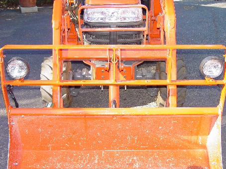

Here's what I did to solve this problem. (Full post was back in December)
