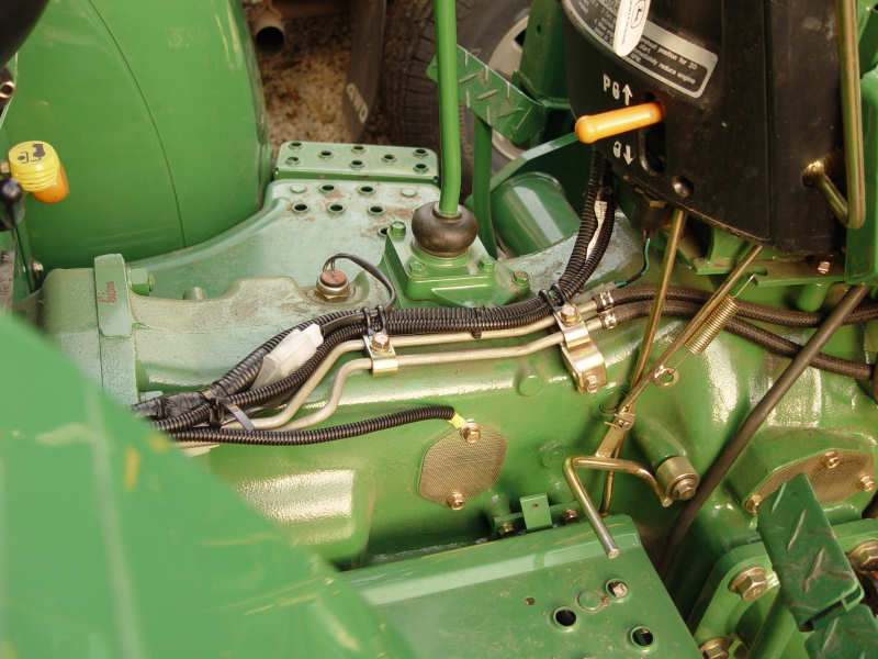

Lights, Lights, Lights. Never enough on a tractor it seems, so I added more. This is the source of their power.
I attached a fused, heavy gauge wire to the main battery cable post on the starter (orange wire). From here on
I ran all the wires in that black wire protector stuff so it looks more factory.
   / Lights on a 990
I followed the factory wiring harness up behind the dash, back down, and across the transmission tunnel. I obviously
removed the cover that is normally over all this stuff. You'll notice that I picked up a ground here as well.
There was a convenient bolt holding on some sort of breather screen (or whatever it is) which I borrowed.

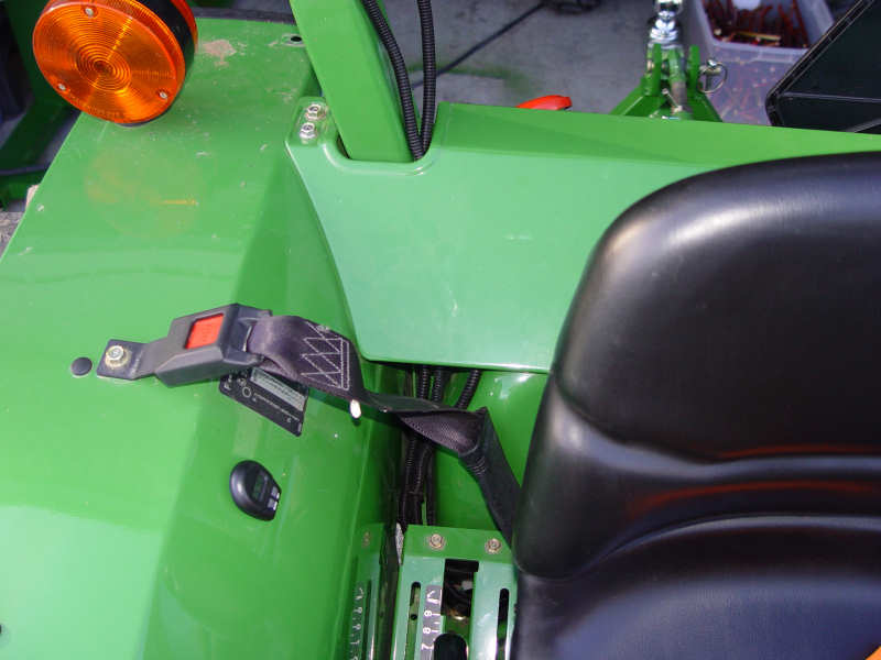

I followed the factory harness a bit farther under the seat before making an upward turn on the right side of the seat.

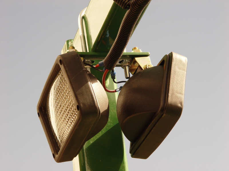

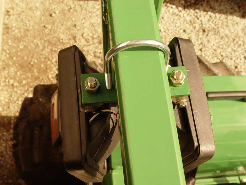

Attaching the actual lights to the ROPS took some thought. Way too much thought actually. I went through a hundred
designs in my head, involving the creation of all sorts of fancy brackets, custom fitted hanger bars, etc, etc.
In the end a simple piece of flat bar with 4 holes in it and ordinary U bolts from the hardware store solved the
problem.
   / Lights on a 990
Another of the mounting bracket.

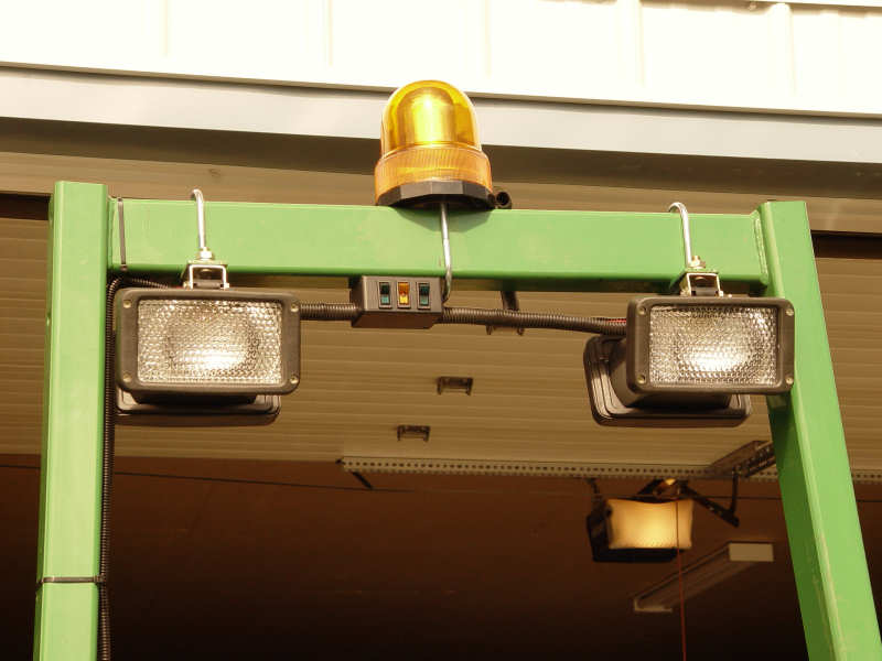

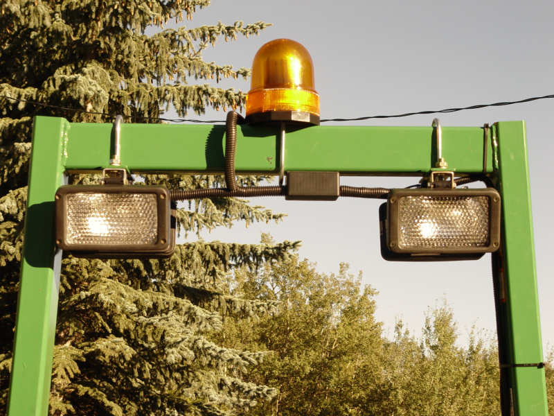

I also added a rotating yellow beacon for those dark winter evenings plowing snow where I have to go on the road a bit.
This picture also shows the switch box I made. 3 single pole switches to switch power to the beacon, the front lights,
and the rear lights. The box also serves as a connection point for all the ground wires.
