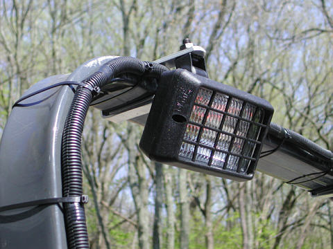

I went with the 55w Trapezoidal lights from Northern Tool for my BX. Very pleased so far...

</font><font color="blue" class="small">( I went with the 55w Trapezoidal lights from Northern Tool for my BX. Very pleased so far... )</font>
That's what I got for my rear light, I just haven't hooked it up yet. Won't need it till the winter. You obviously have superior metal working skills to mine. Your bracket to go around the ROPS looks real good. I made mine out of steel stock from Home Depot bent to shape with a hammer in a 2" vice. It ain't pretty so I went and got Kubota "official" ROPS grey paint to try and disguise it. /forums/images/graemlins/grin.gif
BTW, I got the light from a local auto parts superstore, the name escapes me right now.

</font><font color="blue" class="small">( You obviously have superior metal working skills to mine. Your bracket to go around the ROPS looks real good.)</font>
LOL!!! That's soft aluminum from the 'Depot bent around a block of wood with a hammer! My avocation is woodworking...about the only metal work I've done is grinding away at my new 3pt link adjusters that I put on to replace the turnbuckles at the same time as the lights...
BTW, I'm not at all happy with the wiring harness. It gets caught up too easily on "stuff" that brushes the FEL while mowing, etc. I need to replace that soft stuff with something harder at some point.
