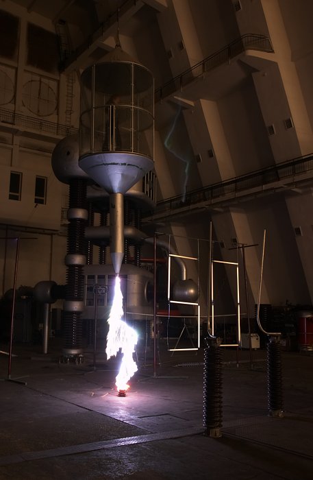

Do you have a concrete slab? Is there wire or rebar in it? If yes, you have nearly a perfect Gausing/Faraday cage if you do a little bonding slab to sides. That is completly surounded by a conductive material. Inside the skin V=0
I'm a high voltage test engineer and perfom tests called Lighting impulse tests at 1800 kV, 1,800,000 volts. The labs have demonstration days where cars are flashed to and Cages with people inside. Note in the photo, there is a person inside!

Paddy, are you saying to bond the metal walls with the rebar/wire and then attach that to a ground rod? If so, do I do it at one point or several? FYI, the concrete will be installed a few months after the building is completed. Thank you for your help.
   / Lightning protection for metal pole building #10
Yes, Bond your walls to the floor steel. As you saw in the photo, once you creat the cage effect, all is safe in side. As far as grounding, the principle is to protect with in. A car is not grounded but the contents (people) are safe in a strike. Grounding won't hurt but in the case of a direct strike to a metal building, you couldn't keep it from going to ground if you tried!
