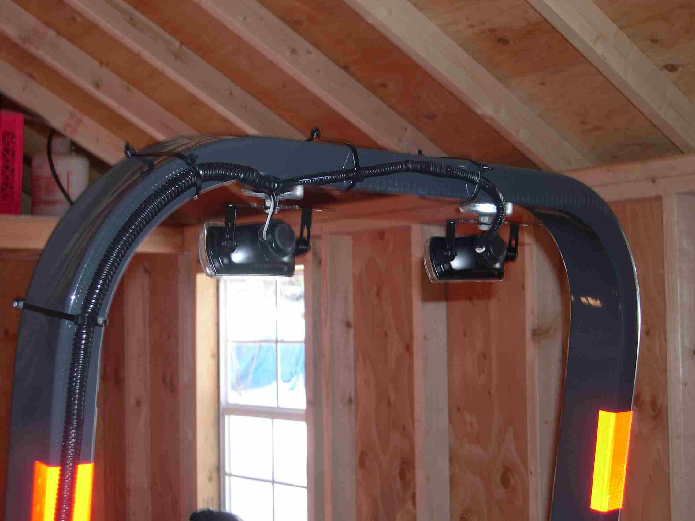

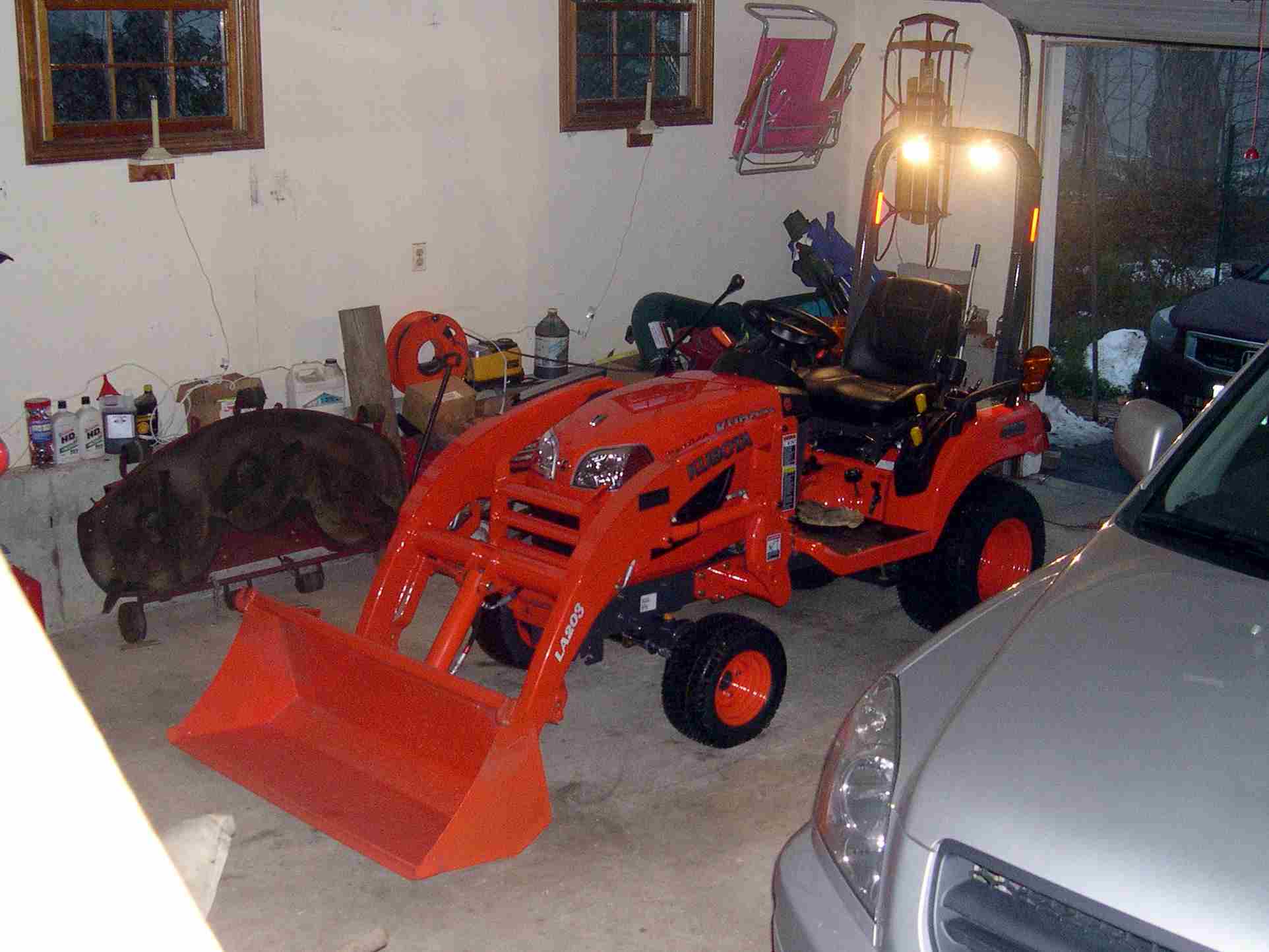

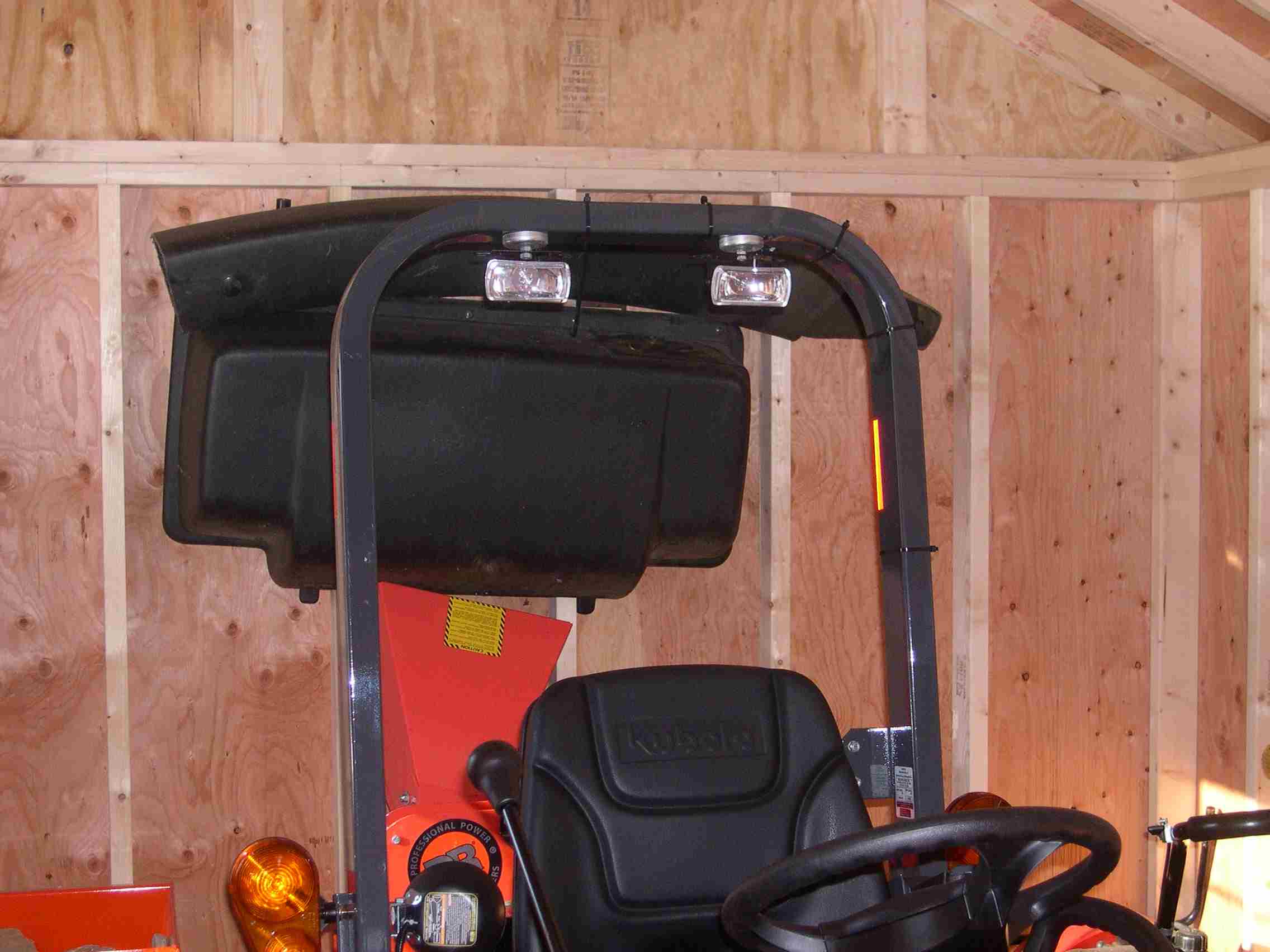

A little late responding, but maybe you're still planning this mod. First I assume your Kubota 1850 is a BX1850? If so, that was my first Kubota and I added two forward lights to the ROPS using the factory supplied wiring. The wire for the auxiliary lights is taped up under the 3PH top bracket. Look for a bit of bulging black electrical tape there. The wire should be taped up to some other "in service" wires. Once you remove the tape, you should find the end of a hot lead that is relayed off of the run position on the key switch - power is on when the key is in run position. I added a switch so they wouldn't be on whenever the machine was running. I forget is there's a ground wire but I don't think so since I grounded my lights to the frame IIRC. Should be enough power for 3 or maybe 4 LED lights depending on wattage. Hope this helps.
