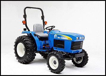

Looking for options on upgrading light output on my New Holland T1510. Would love to install a small led light bar or something but don't want to do a hack job. Any ideas where I'd be able to attach a light bar to without having to drill holes into the hood?
   / Light Upgrades NH T1510 #2
There are numerous threads here on led lighting installations. Most open station owners attach leds to the rops, but I personally don't like rops installations.
My current tractor is a cab, so I mounted (2) 55w led spot/flood combo leds front and rear of the cab. They are 9" long each and really light up my work area. If I were to do it over, I would likely go with 36w, or about 4-6" wide leds.
Good luck with your install!
   / Light Upgrades NH T1510 #3
I mounted my light bar on the ROPS. I have a front loader which tends to block the standard lights. The higher light bar easily fills in what's blocked. If you have no loader you may wish to investigate bright LED lights to replace the standard bulbs in the factory headlights. They generally use less power and don't get as hot.
