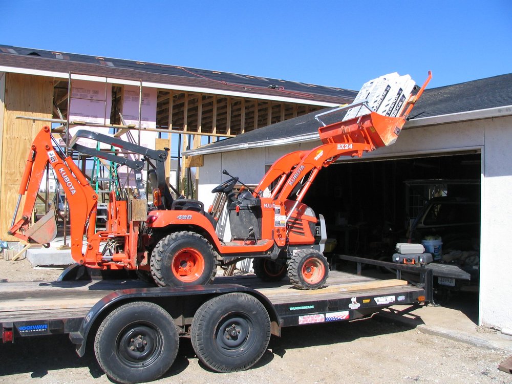

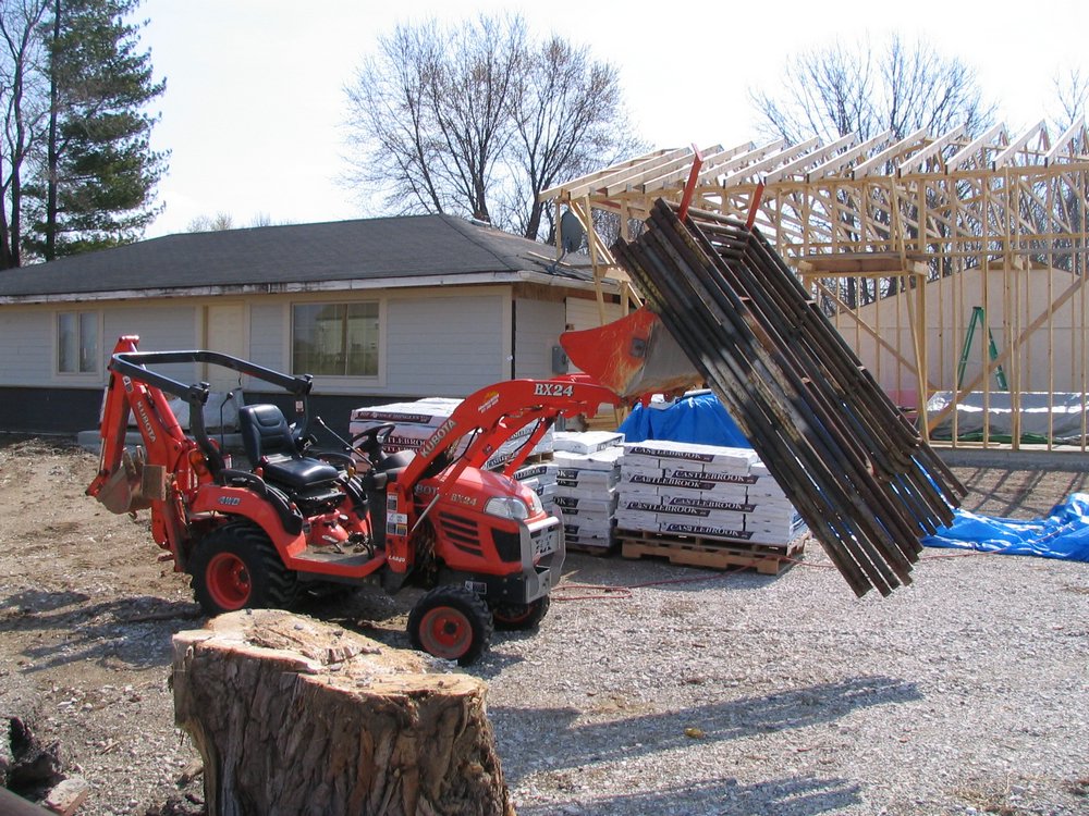

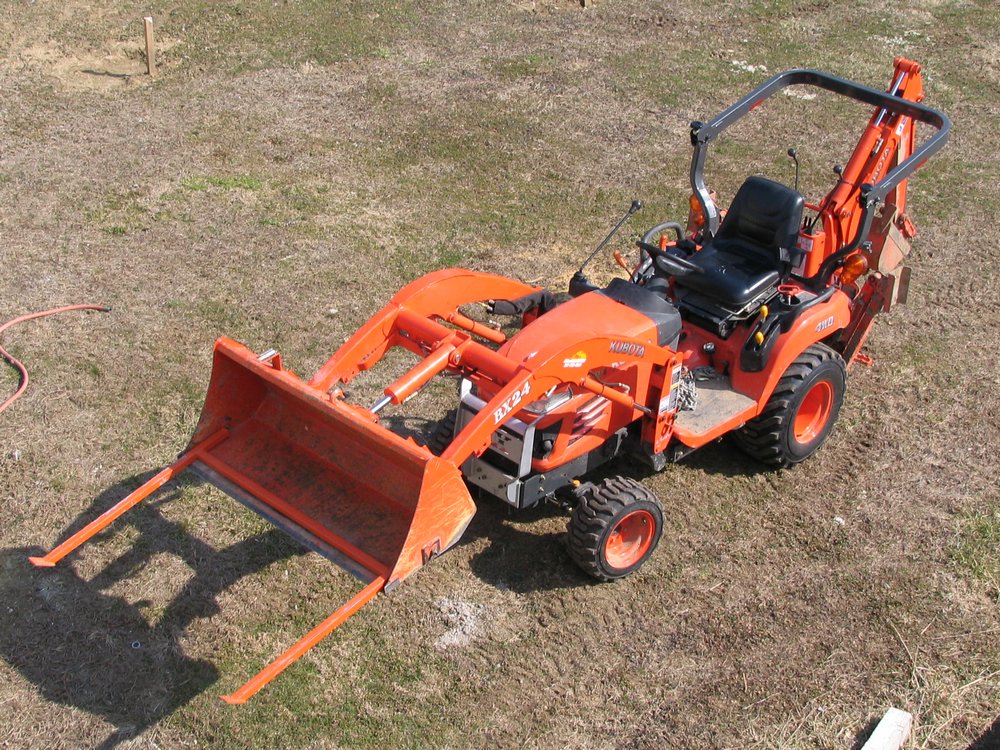

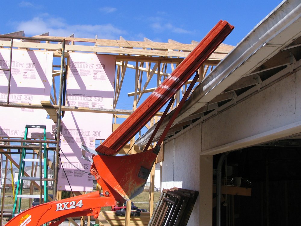

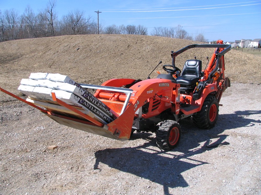

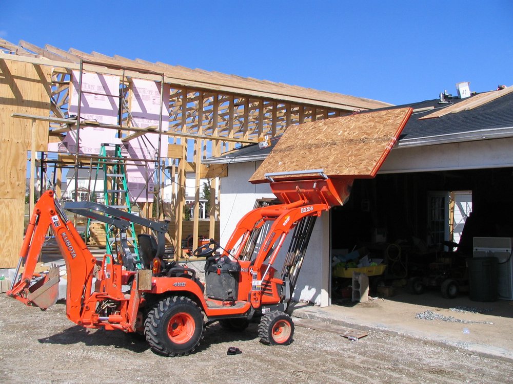

I built these forks to help pick up logs and brush to help clear some acreage, but with the addition of a vertical component, they worked out quite well to carry OSB and lift it to roof height. When it came to the shingle bundles, driving up on the trailer gave us the height we needed.
Sure beats lifting these things by hand. We found it would carry 10 sheets of 7/16 OSB or 8 bundles of shingles per load.

I forgot to mention, these "forks" utilize the same holes as the tooth bar
