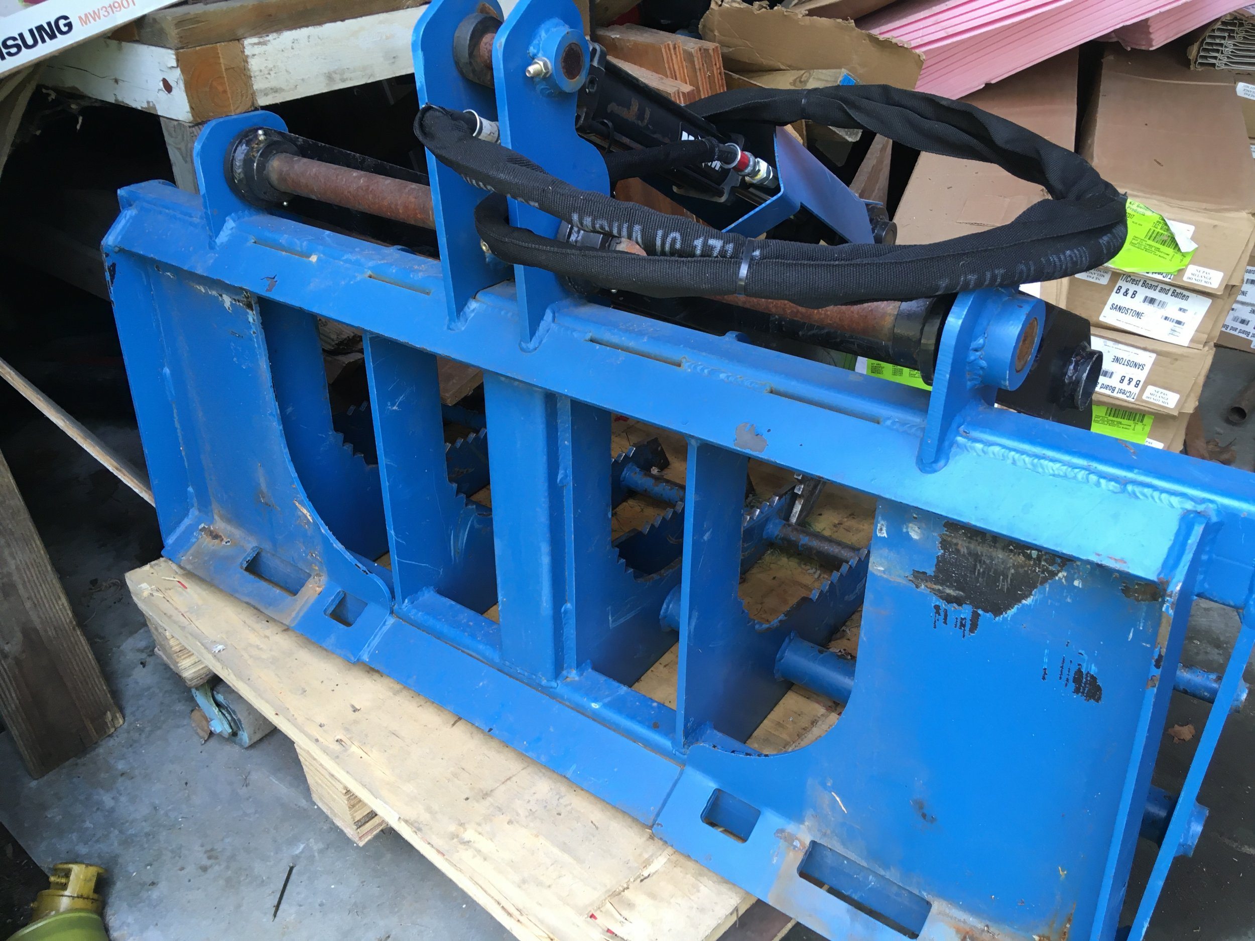

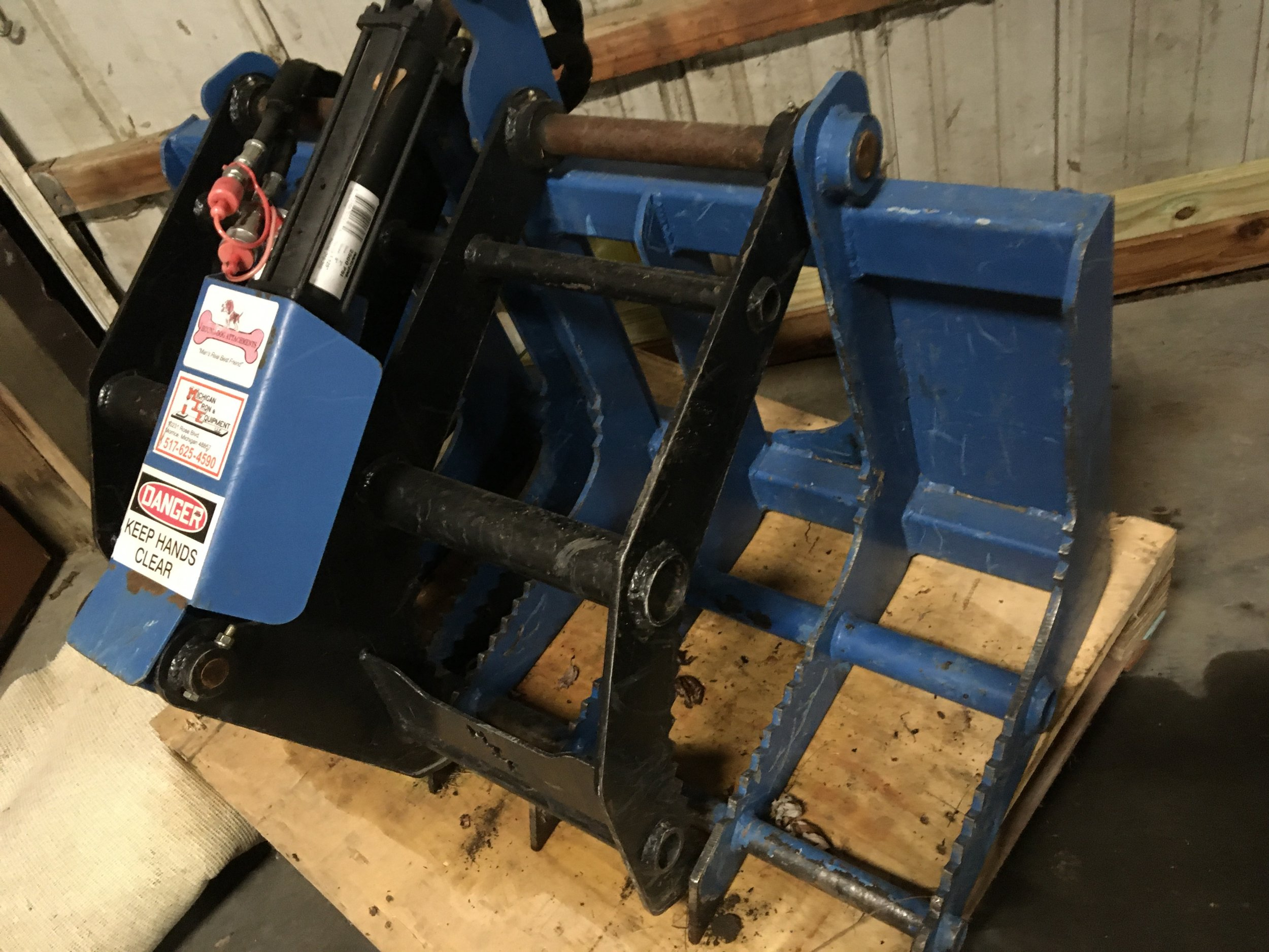

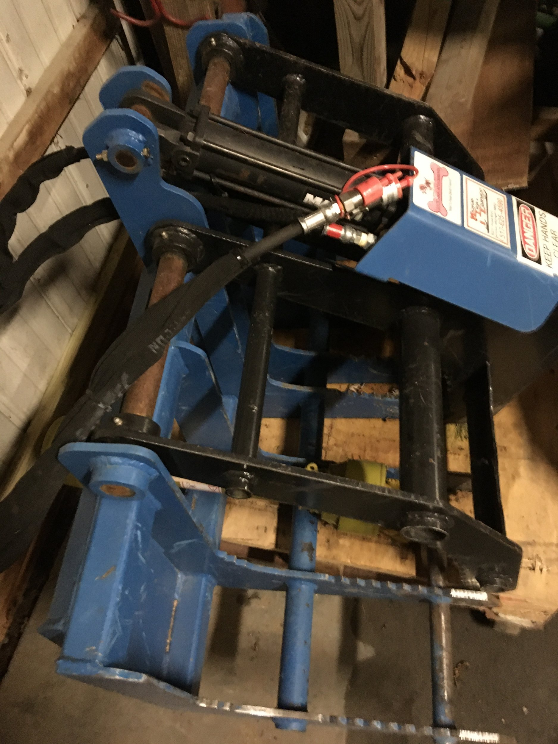

I've done what the OP suggests with a 48" SSQA grapple on a FEL with < 1k lbs lift capacity. (light for its strength) Picking up more than one 8-12" dia log at a time can be a bear. Three at a time even 4" almost requires a ground operator to guide them under the lid. It's a great sod skimmer/lifter too, not taking more bite than my CUT can 'push'. I got mine from MIE and wouldn't trade it for anything. (can you say 'custom shop'?)
IMO the narrow width is more of a boon than a handicap, and not just to keep weight down. Ya gotta balance the load to not tip the machine anyway. Less width makes it easier to tell when I get that right. Note that the lid cylinder anchorage is part of a tooth extension and well braced/supported from the back. btw, I don't recall the price. I only had to pay it once and this will be the fifth straight Summer it'll stay on until snow falls. I'll bend a loader arm before I bend/bust my grapple.
