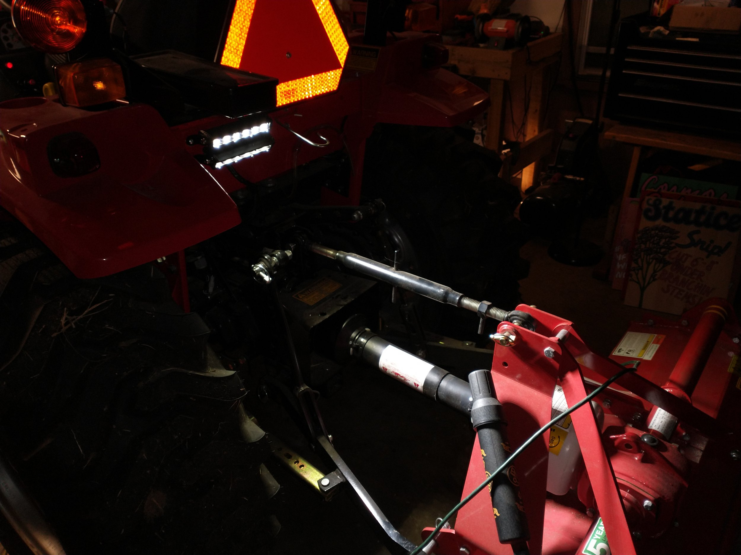

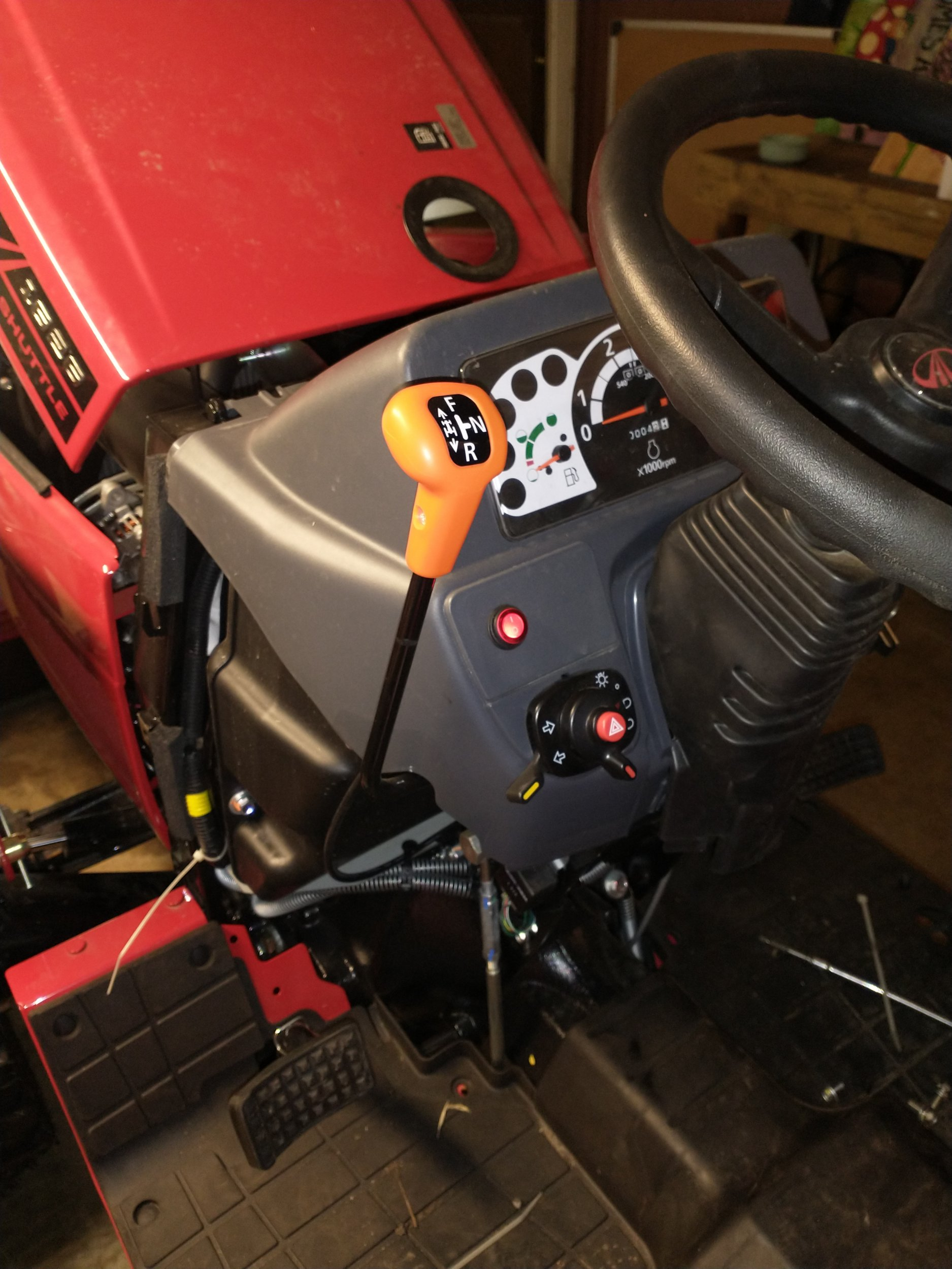

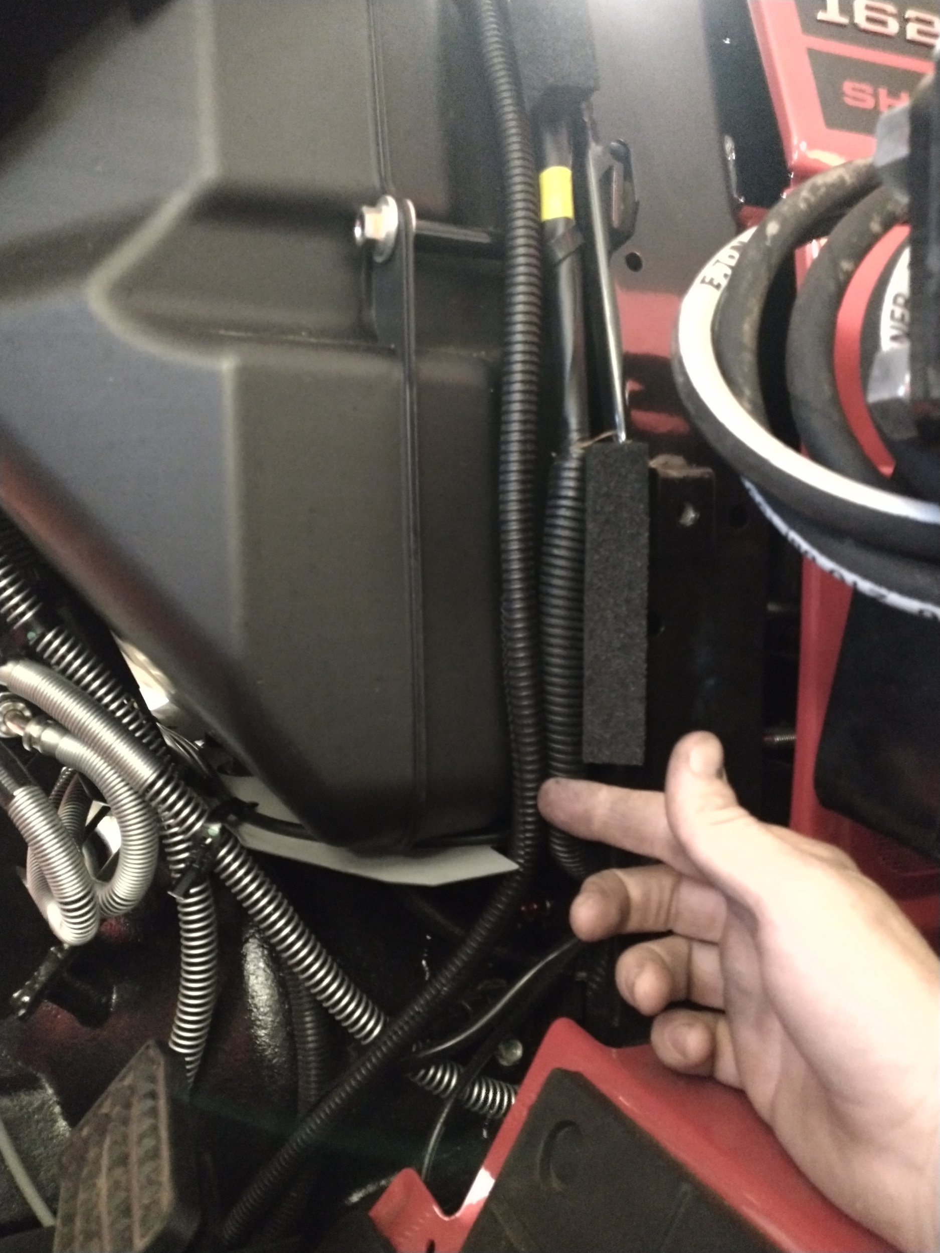

I was so impressed with my front light bar that I installed a few weeks ago that I ordered 2 more small ones for the rear. The front bar kit came with a wiring harness that had an extra set of wires for a second light, so I ran them along the wiring harness in a loom to the back and spliced both lights into the harness, had to add about 8 feet of wire. The reason for 2 is that I've got one angled down to light up my 3 point for attaching and adjusting the 3pt, and the other for the rear of the tractor to be able to watch the mower or tiller or whatever implement I'm using after dark. Once the temps hit the upper 90s and the skeeters come out full force here in north Texas working at night is the best option in my opinion.

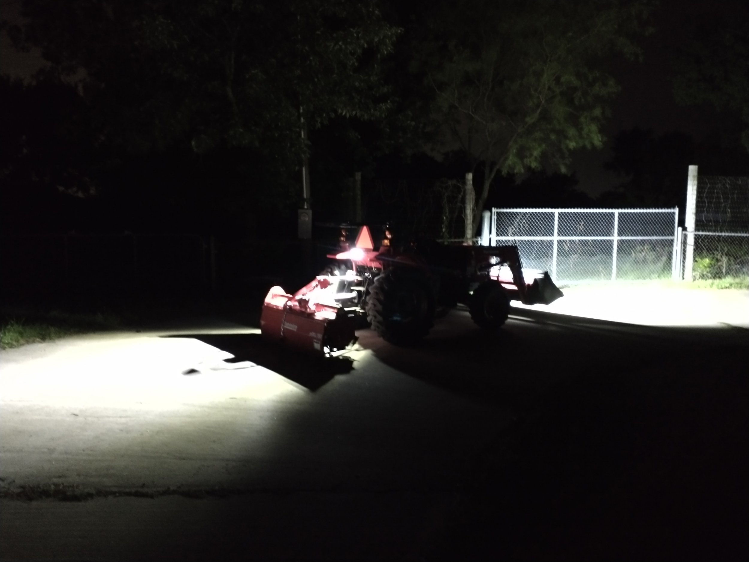

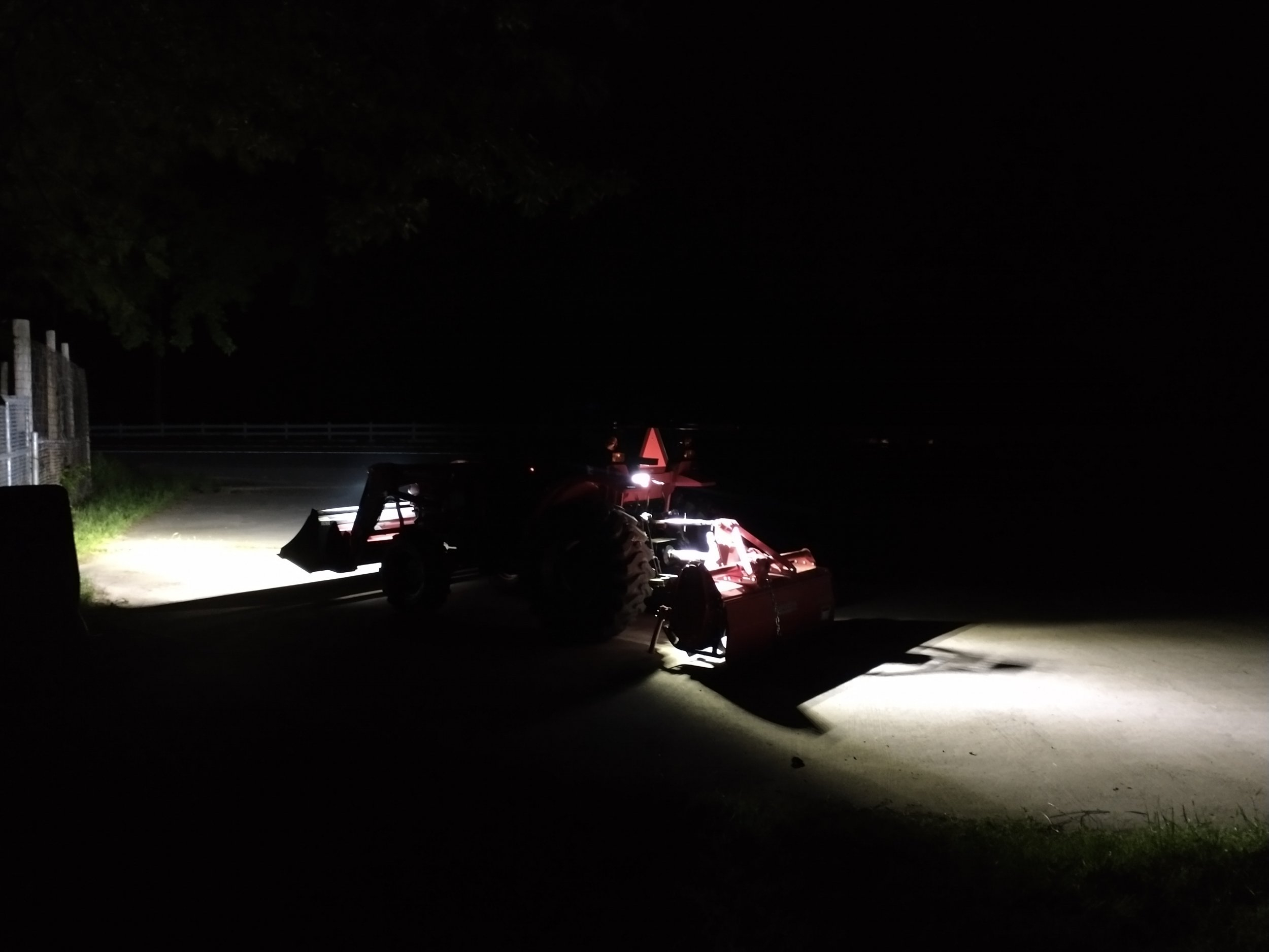

Night view!

That's exactly why I didn't mount them on the ROPS!
Good thinking. Looks good.. Some LEDs dont attract nearly the bugs incandescent does, though they usually don't specify. Hope yours are one one of them.
   / Light bars! #6
With the loader in place my oem lights don’t do well either so I mounted three led lights on my rops two forward and one back. They work like yours, very well.
