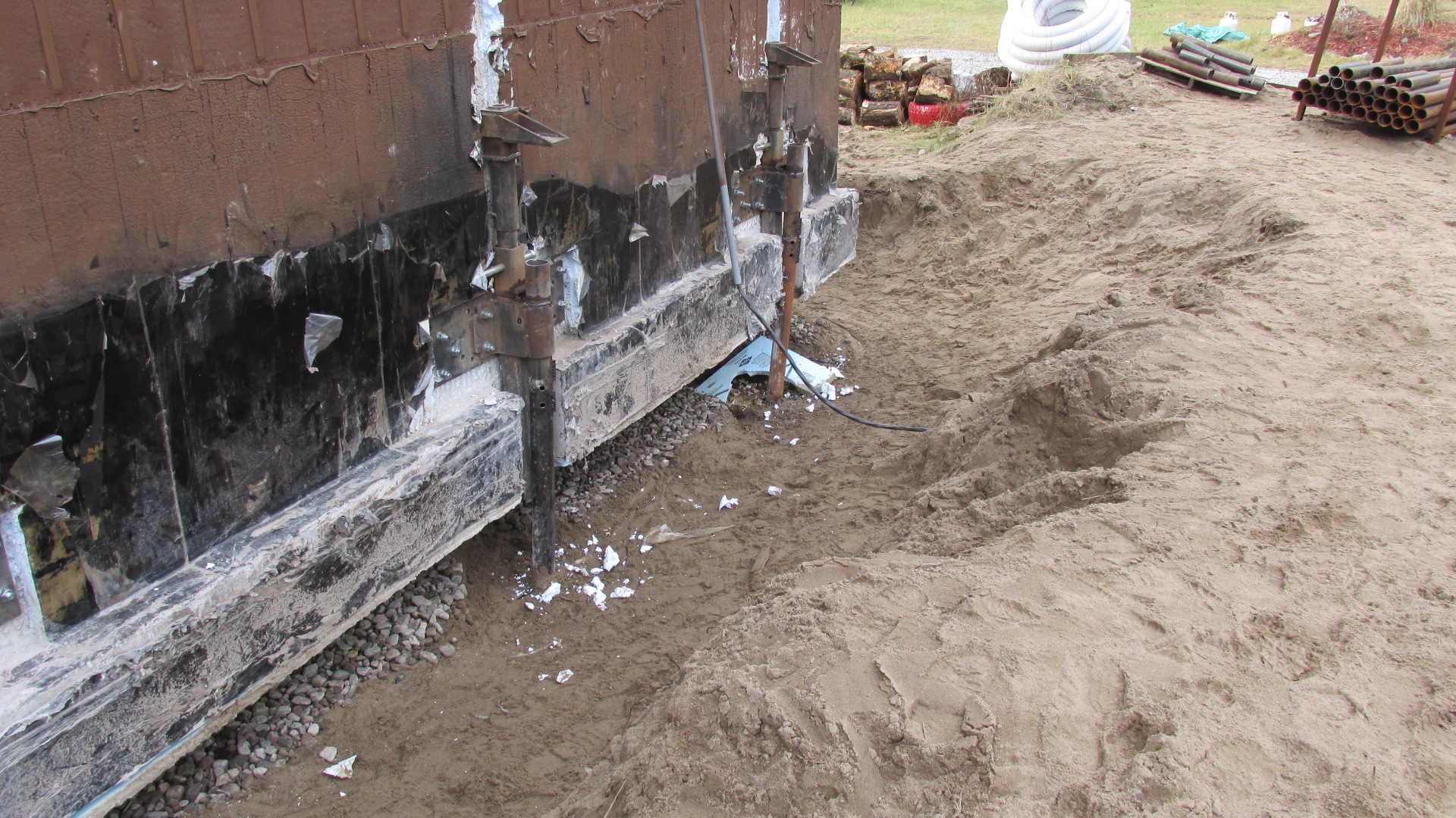

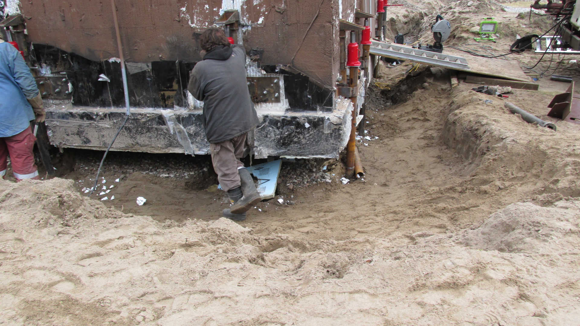

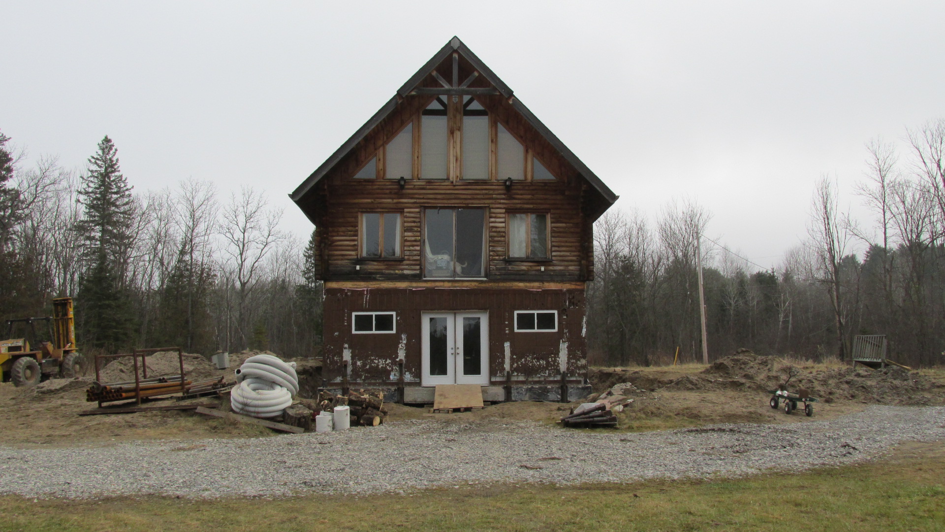

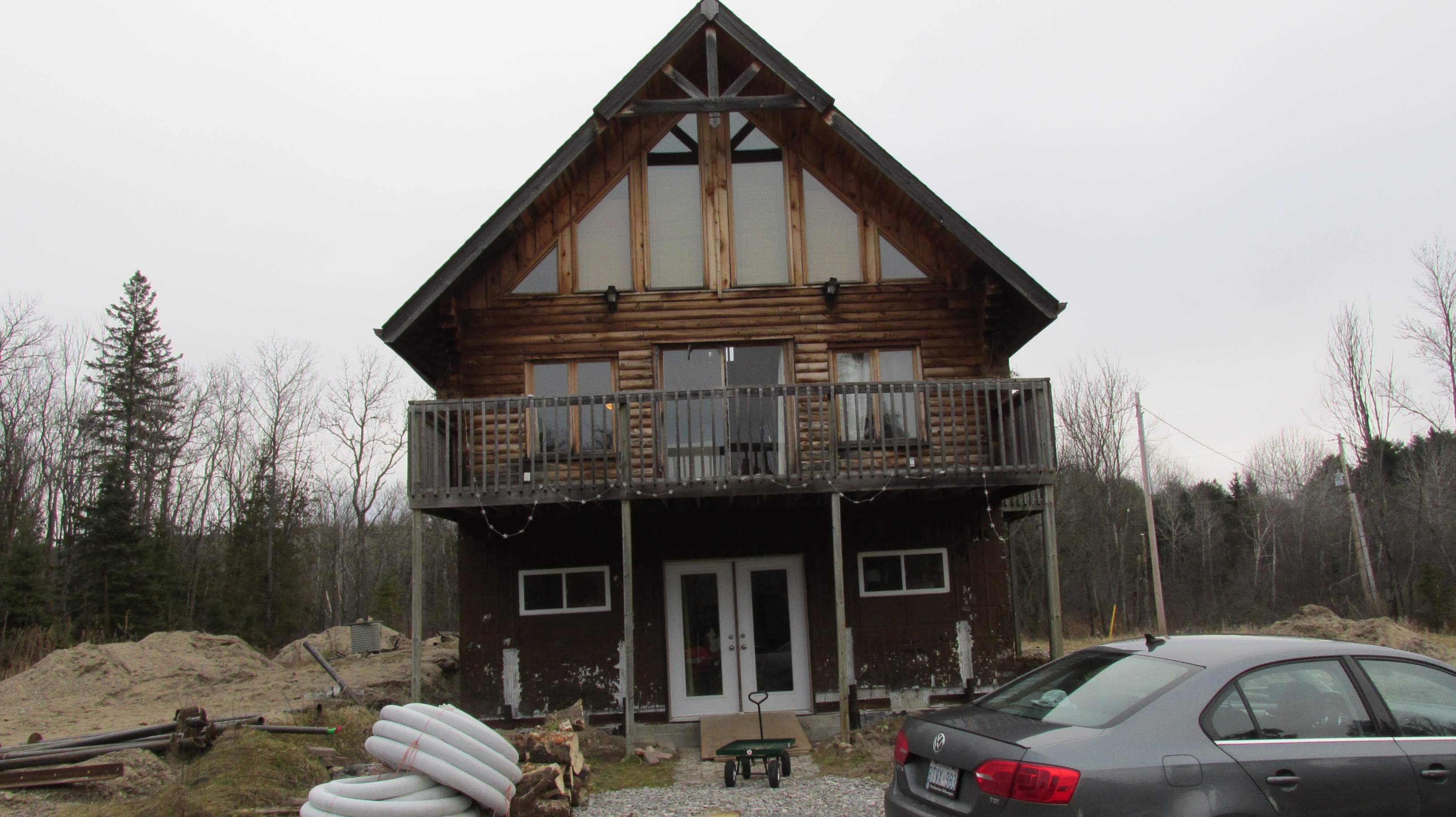

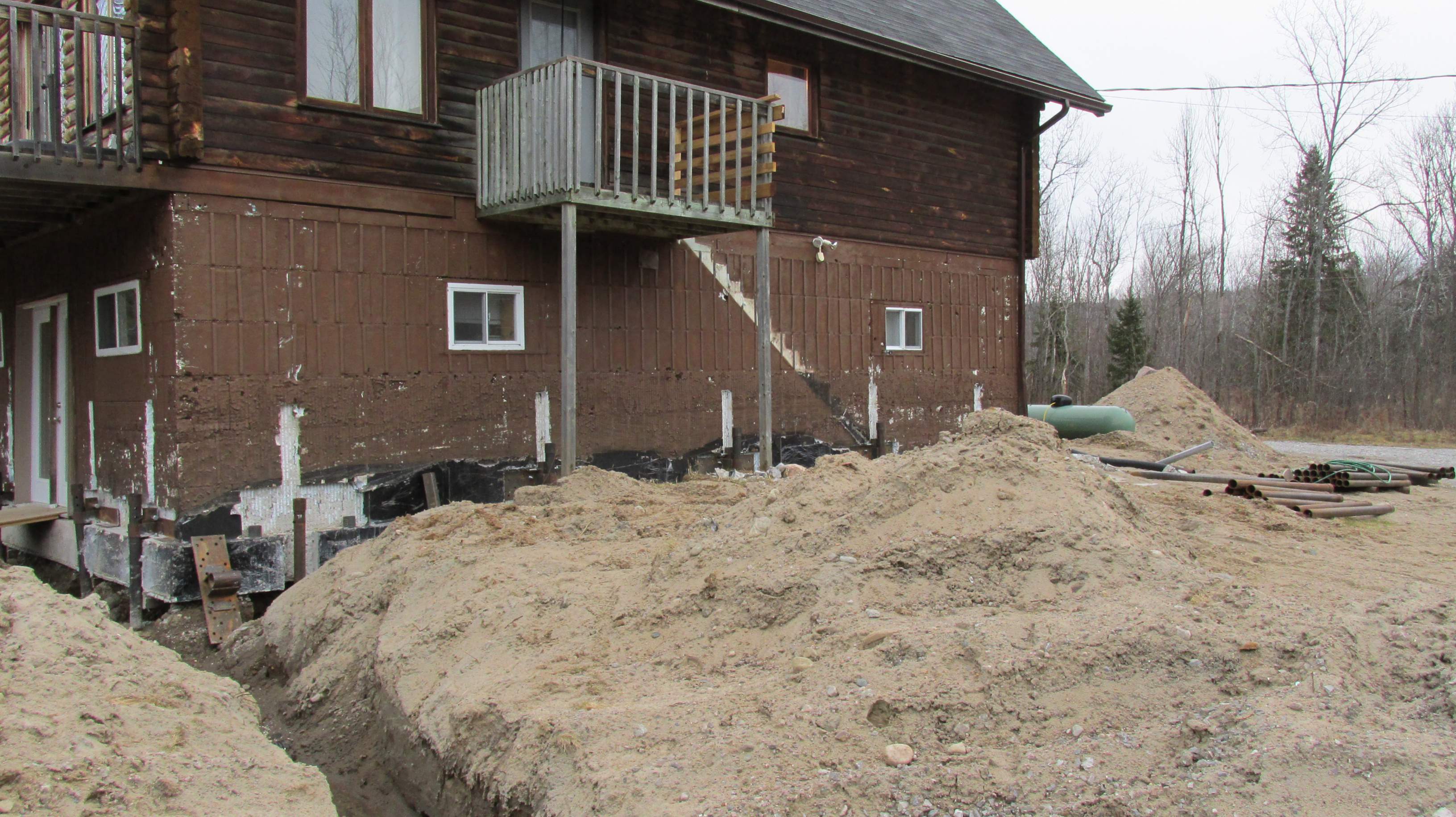

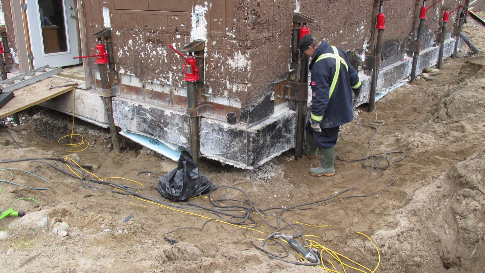

We bought our house knowing we'd need to level it... at time of purchase it was 'yeah, just pour concrete basement floor and all would be great lol'. We have just finished using helical piers. Here is picture of before, during and after. (before has deck, after no deck.) next step is pump concrete underneat, lift top off bottom and level it to the now FULLY PLUMB/AND LEVEL ICF FOUNDATION. We estimated 10ft piers, actual depth 80-95 ft each. 21 of them OUCH.

For reference. max lift on front left corner was 15"... and slab has no cracking etc. (3 piers inside the house)... this spring we do the stonework on foundation ourselves...with a little help from my friends who are stone masons.

Wow, that's a unique project. Can you explain more about why you have to take the top off and re-level that part?
The original foundation was put in and it sank on one side. Looks to me like house was lifted and shimmed. Then the foundation sank more on the one side.... So now after fixing the basement that was tilting to the left, the top now tilts to the right. The fix will mean the house sits on foundation level as well. (currently mickey mouse shimming iwll be taken out and made right). Hope that clarifies the two stage level approach.
Ah, makes perfect sense now. Thanks for the clarification!
