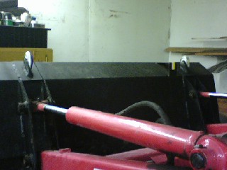

I welded 2 hooks to my 2310 and they have been handy. It makes working on the MMM easy. I did put a plate between the hooks and the bucket to spread out the load.
Doug

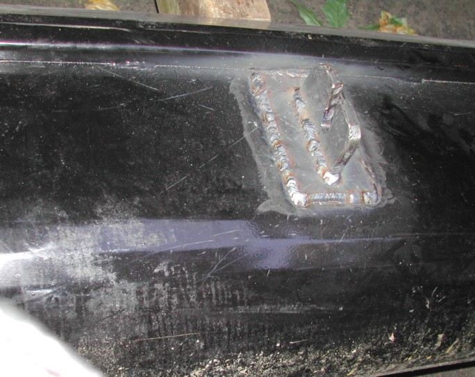

I like the bite hooks that somebody here recommended. I'm not sure if they can be purchased, If not I'll build. They allow you to place your chain in the notch and you just tip you bucket to drop your chains without having to get off your tractor.
