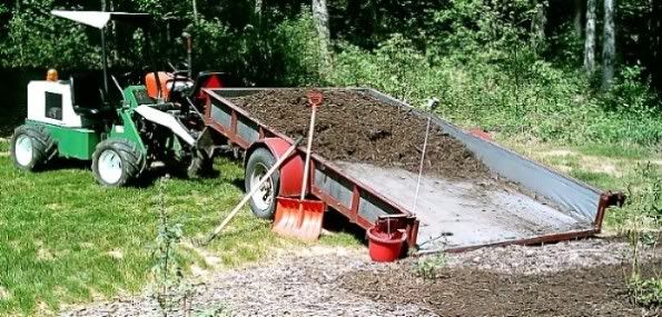

PS: This is my Power Dump Trailer. Since a full load of mulch weighs about 3000#, my PT-425 may be lifting close to 1000# at the Attachment Plate to tip this remaining load up!
