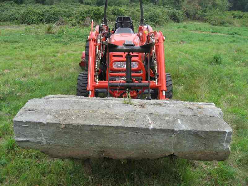

Just for perspective, this is what a DK40se/KL401 can lift. I'd estimate it was six feet by two feet by one foot so about half of the weight that you are looking to lift. I did not try to lift it higher mostly because I did not have adequate ballast but the loader had no difficulty getting it up. It was uncomfortable moving this Jersey barrier type load even 200feet across an uneven field with just a 600lb flail mower for ballast. I kept it real low and real slow.
I'd think that a big skid steer would be the tool of choice for the concrete blocks you are describing.

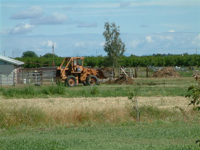

Sounds like a job for a wheel loader like the Allis Chalmers 545 that my neighbor has. Not a job for a CUT/FEL. Need construction size equipment to do the job safely.

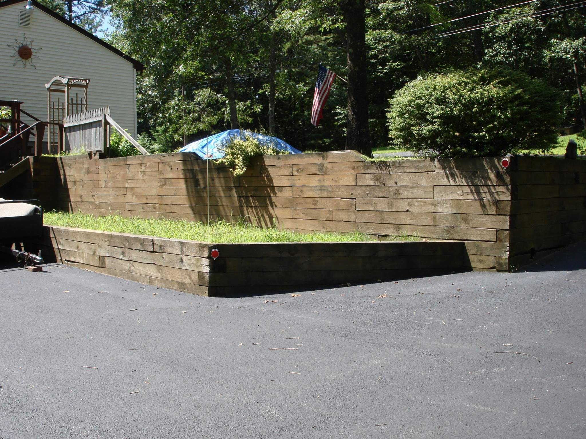

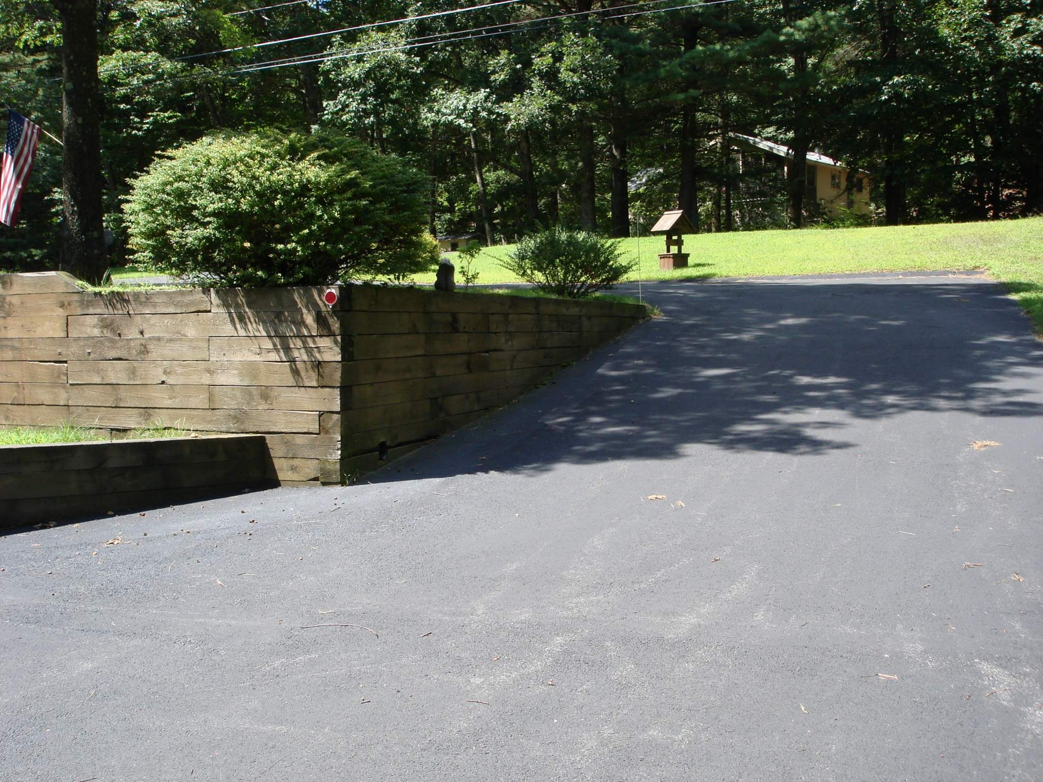

I appreciate all the feedback, and view points. I can see that dealing with the weight of these blocks not only creates the need for special equipment, but also will demand a proper base structure. I feel less guilty about procrastinating over this project as it must be done properly and professional help is in order. I put in a wall using landscape timbers in the 80's and it has served well, but talk about an ANT magnet!! I get sick of the constant battle with these creatures.
I am looking to eliminate the planter and push the entire wall back eight feet to allow a larger area at the lower level.
Again, thanks for the input.

If you are pushing it back up the hill, it looks like you will only need about a three foot high retaining wall (just judging from the photos). If my assumption is correct then why not use the small precast retaining wall blocks that can be moved by hand. Someone on TBN just did a very nice job using those things and they are available at box store home centers.
