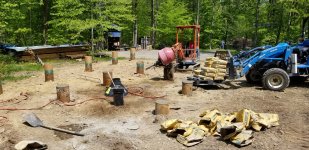

Just 2 weeks ago I poured 8300lbs of concrete useing just the method you described. Lowes loaded the pallets on my trailer then I split them into 3 and feed my mixer right off the waist heigh forks. It worked very very well. So well that I could do another 8300lbs if I needed to.
I also mounted the electric mixer into my micro EX bucket so once the concrete was in the mixer it wasn't handled again. We did 15 12in sono tubes 5'+
